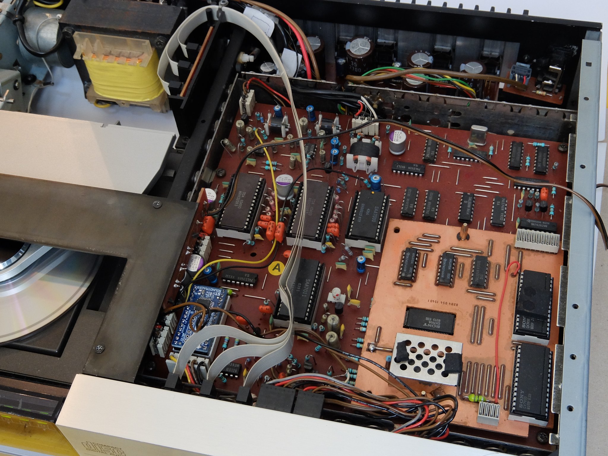

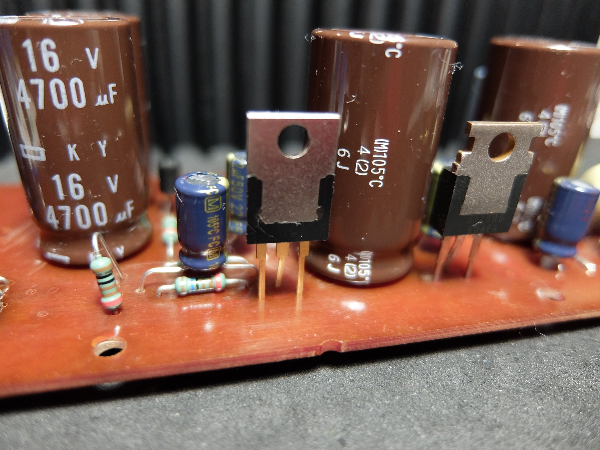

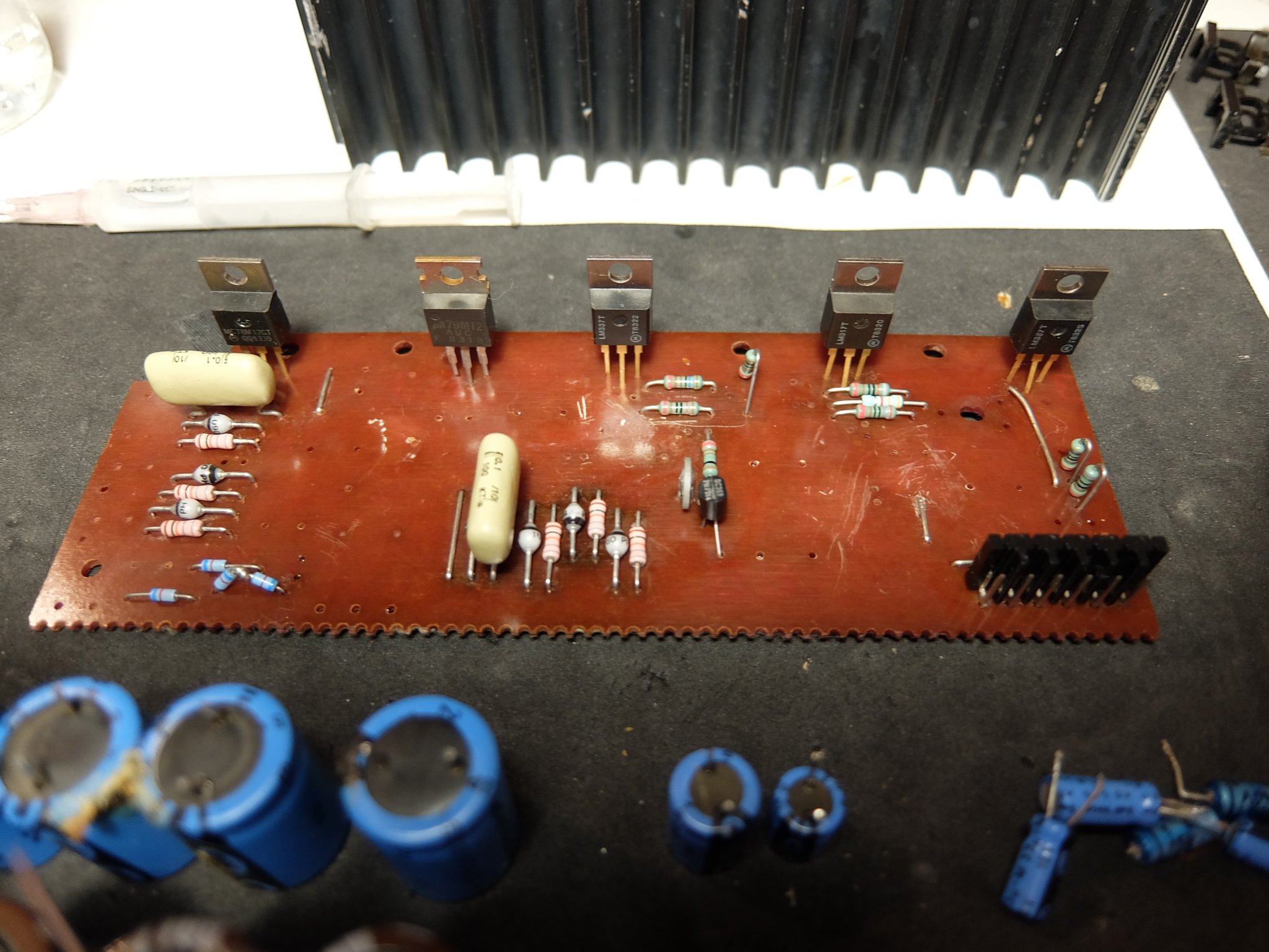

I got a Philips cd 303 with noisy outputs, so I replaced all the caps on the power supply and laser board, repaired broken soldier joints... And it worked fine.
Then I decided to change dac power supply caps, but when I was connecting dac board I misplaced two 3 cable connectors, the data and power supply I think.
Now only drawer works and mab8410p chip is getting really hot. I tried putting a chip from a cd 304, which is a little different, and with it it spins the disc but won't read, display doesn't work... but the chip is staying cool.
So, did I fry the mab8410p? Are there any replacements avalible?
Any help would be greatly appeciated.

you have to start from the base, namely, the power supply/regulation card, check the presence of all the right voltages in the right place (card disconnected) and then, when you are sure that everything is fine, you can ( using the SM) check all the pcb values by pcb, finishing with the DAC part.
I checked the power supply voltages, they are okay. I don't think I should leave it on with the mab8410p chip running scorching hot.
You don't think that the chip that I supplied voltages instead of data, and is now running very hot is not the clear indication of problem? Maybe I could remove it and then check voltages, but that would only tell me if something else got damaged by my mistake? As I understand this is logic chip that has programs written in it, so it's not easily replaceable, though I've seen some advertised for this player.

@kaulagalvis Yeah, I've read that somewhere. It is B007C, and I've found this: https://www.ebay.com/itm/294024131613
but I think it's too expensive for something I'm not sure will work.
So I did murder it. Bummer.
One of those connectors is white and the other one is black, but I was dumb enough to go by the way wires are curved (which can change)

I agree.I think it's too expensive for something I'm not sure will work.
Before giving up (or spending money without any certainty) I suggest you try sending an e-mail to Bram Jacobse kindly asking him for advice, he's one who knows a bit about vintage Philips/Marantz CD Players.
