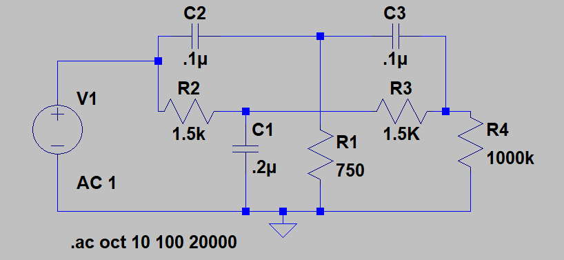

I finally got inside of mine and discovered it was something from JensH. The basic circuit is pretty simple. RC Twin T Notch Filter :: Radio-Electronics.com JensH board has some switching etc. and active/passive options that help. I don't know if he has anymore. A passive one is really 3 caps and 3 resistors (and possibly 3 trimmers for tuning). I have a B&K tunable version but its a different scale of project.
I'll try to reverse engineer what I made with Jens PCB.
Joined 2004
The version I have was built to attempt to get a 20 dB notch. It didn't really work. I'll rebuild it as below so it's more conventional.

On a further note I think I discovered the magic trick B&K used on their passive notch to correct for the attenuation of the harmonics. If you raise the source impedance on the passive notch enough to get 20 dB loss at 10X the notch then the differences in the harmonic levels from ideal (-20 dB) to less than 4 dB (-4dB vs. -10 with no series Z).

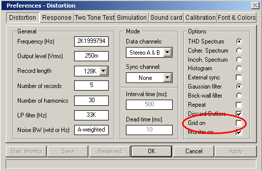

I need one more "check box" in the Distortion Preferences menu to turn on/off the notch filter compensation. At the moment, there is no room for an additional check box. But I could delete another one to make room for it. What about to remove the grid off feature (see pics)? Am I right that nobody will use this feature?

Horisontal grid lines should always be visible. So take away the tickbox.
And regarding the notch filter, the attenuation is varying with temperature, i have built several of them. So it´s very important to measure the fundamental signal before and after the twin T notch filter.
I sometimes want to turn the grid off when I just want to show the shape of the residual. It's good for graphics when you are writing an article for example, and makes it look less cluttered especially with low-fi print graphics.
Can you move the grid option to the font/colors panel since it's a somewhat cosmetic option? Perhaps rename the font/color panel to Display Options or something so the user knows where to look.
grid
Also the font/colors panel is fully occupied. Perhaps a little far-fetched, but what about using the same color as the Signal background? Then the grid is also invisible.
E.

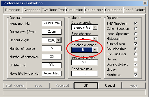

Although it looks a bit cramped, what about an extra "combo box", where one can select the channel which will be compensated for phase and insertion loss of the notch filter? (BTW, should I call it 'Notched channel' or just 'Notch channel' ? )
Comments invited.

Experience tells me it's better to use more descriptive terms rather than colloquial ones as long as they aren't so awkward they have the opposite of the intended effect. Notched Channel makes sense to me.
Some programs put the title in the first entry of the drop-down box, but I do prefer a less cluttered layout to that insanity.
