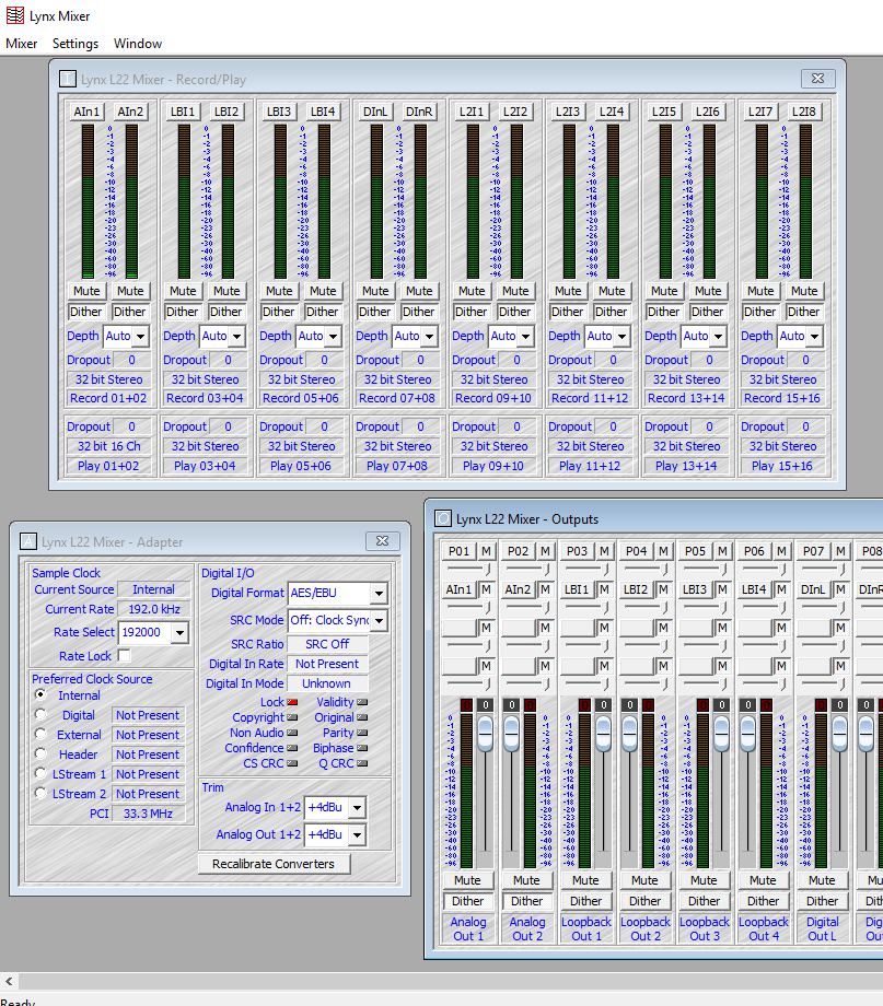

Looks like you have some 60 Hz PS noise getting in there, but your are in a 50 Hz power country. Also more higher harmonics? I'm sharing my settings in case they are useful.

Me too. But when I lay the Lynx cable along the one to the monitor, I get more "grass" (6dB at 60Hz).

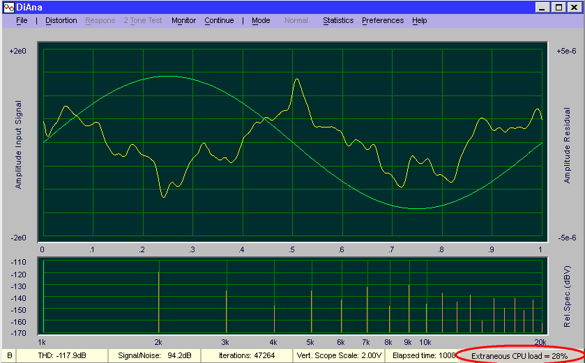

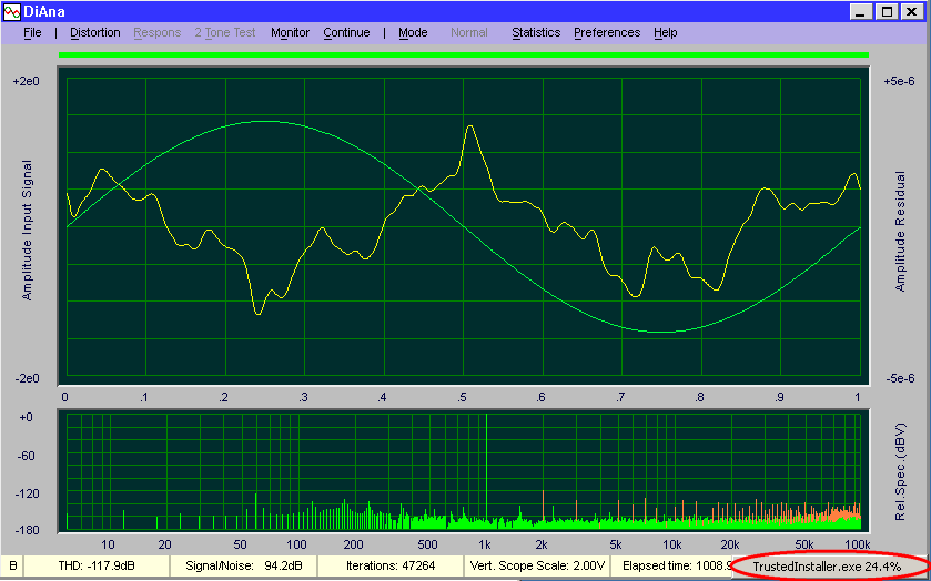

Just tried the latest version with the RTX. Its working quite well. The cal routine worked fine when I told it to save the calibration. it did not save a calibration the first time I tried for some reason.

9) select run as administrator to enable the info on who is stressing the PC.

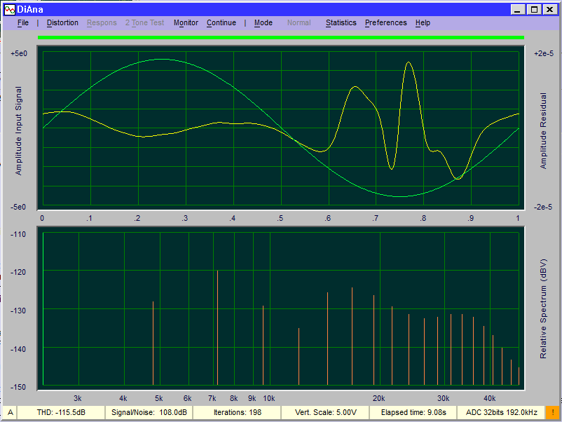

On the statistics page for THD, Statistics 2, there are 3 THD numbers and a TNS number that are not clear. On one test I get a THD of -115 dB but that pages lists THD 511 which I don't understand. THD LPF is band limited THD w/o noise, THD+N is with noise. What is THS? And when it says tolerance what is it referring to?

To explain why this display is so useful I'm uploading a plot from my Fluke 510A source. You can see the spectrum and the biggest harmonic is -120 dB (very good really). The upper waveform tells a lot more if you are trying to figure out what to fix/improve. It shows some compression on the negative part of the waveform. This makes sense since the amplitude monitor samples the peak negative of the wave. No other tool I have or have seen (except my Shibasoku) would give this insight.
In order to run program as administrator I could have automated above steps, but that means I've to fiddle with the registry. That, however, would conflict with the philosophy of DiAna, as IMHO, a decent program should never pollute the registry. That's also the reason why it still makes use of an old fashioned ini file.
On the statistics page for THD, Statistics 2, there are 3 THD numbers and a TNS number that are not clear. On one test I get a THD of -115 dB but that pages lists THD 511 which I don't understand. THD LPF is band limited THD w/o noise, THD+N is with noise. What is TNS?
TNS is an acronym for "Theoretical Noise Suppression" and is defined as 10logN, where N is the total number of averaged cycles (of the fundamental). Evidently, the larger the records size and the larger number of records processed, the lower the noise level of the THD spectrum. So this TNS figure simply predicts to what extent the noise level (i.e. the "grass" on the bottom of the spectrum) will be lowered.
THD-511 is simply the unfiltered THD. Why 511? That's the total number of harmonics of the so called "THD-spectrum". Remember, this FHT is a transform of the residual. That means, opposed to the so called "Raw-spectrum", that the frequency of the first second bin is the frequency of the fundamental itself, and frequency of the last bin 511 times higher (as the FHT size is 1024). It also means that some higher harmonics may lay beyond the Nyquist-frequency. With common audio ADC's these higher harmonics are meaningless as they are removed by the anti alias filter anyhow.
However, in case of this SAR-ADC for example and Frex has not put a LP filter in front of it, these higher harmonics are meaningful. But normally, it's better to exclude them from analysis by means of the built-in LP filter of the DiAna.

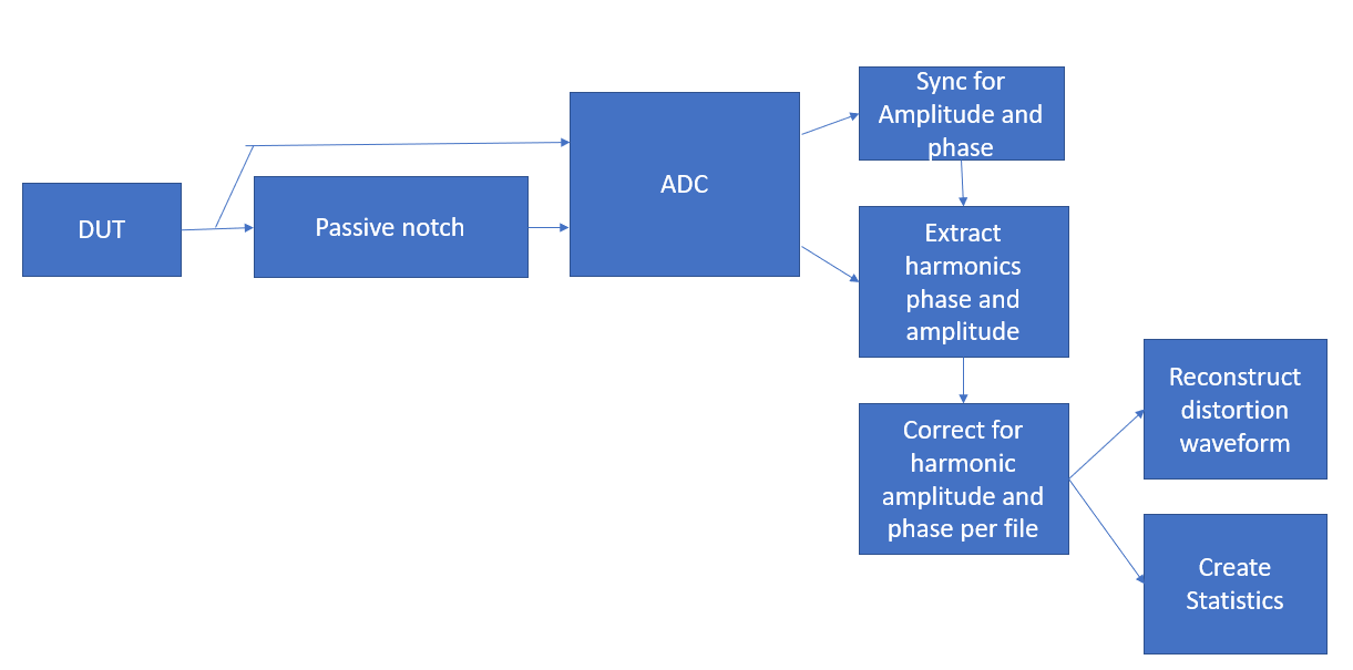

At this point, it would be great to have a way to use a passive notch in front and reconstruct. Would need an insertion loss curve to put in correction and some way to monitor the unnotched waveform to reference level and sync the reconstruction.

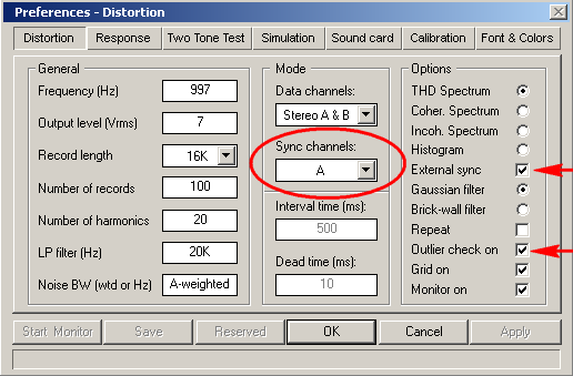

Above remark prompt me to reveal another new feature, implemented on request of Keantoken. He also is using notched signals and trying to analyze them with DiAna. But.... since the program highly depends on data supplied by the amplitude, phase and offset detector (and when the external sync option is switched on, also on the frequency discriminator), a highly suppressed fundamental will invalidate these data. As a result, the outlier check will be triggered and data from the record concerned will be skipped.
To overcome these troubles, one can use the frequency and phase info form the other "unnotched" channel. Therefore I've added a new field in the distortion preference menu (see below), where one can select the channel used for synchronization.
Note that (currently) this option is only available when the external sync option is enabled. Also note that this feature is still in development and needs more refinements

Here is a proposed model for using a notch filter with a two channel FFT. To get the accurate results you need a "gain phase" plot of the notch filter and maybe to interpolate the corrections for the specific harmonic frequencies. I think the Rohde and Schwartz UPV's do something like this but I'm not sure. Adding a make up amp after the notch filter could be accommodated as it would be flat gain correction. With this, it would be easy to get SOTA distortion measurement with a more generic sound card. You would still need an exceptional source.

The pro version of DiAna has already the option to generate (and save) a gain/phase plot. So it would be relative easy to measure the characteristics of a notch filter and use the result to correct the "notched" residual. But such an extension of DiAna goes beyond the aims of the demo version. :sad:
By the way, the pro version is also accommodated with a kind of "digital notch", that nullifies the distortion of the sound card as well. But to make use of it you need a high performance multiplexer and digital controlled attenuator in front of the ADC, way more complex than a simple notch filter.
(That's why those mysterious interval and dead time parameters in the distortion menu, and com port selection in the sound card menu).
