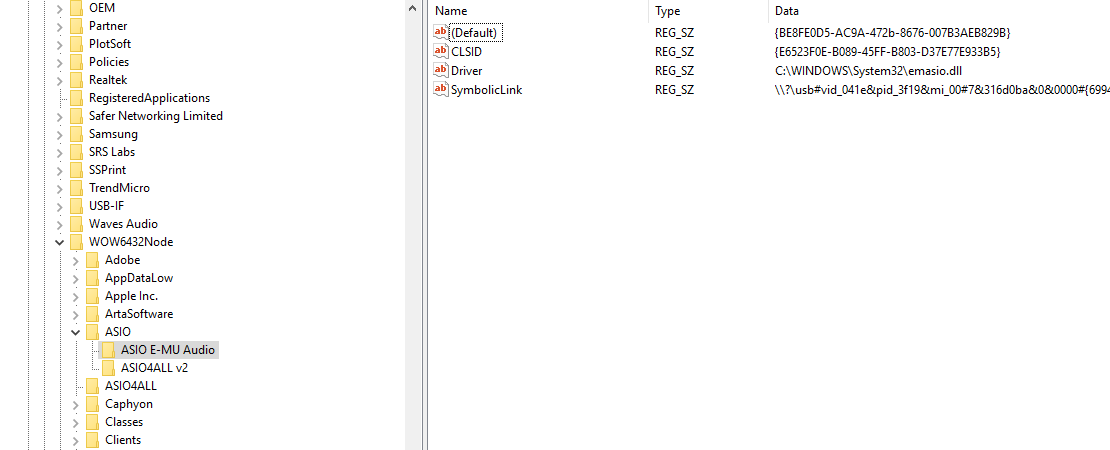

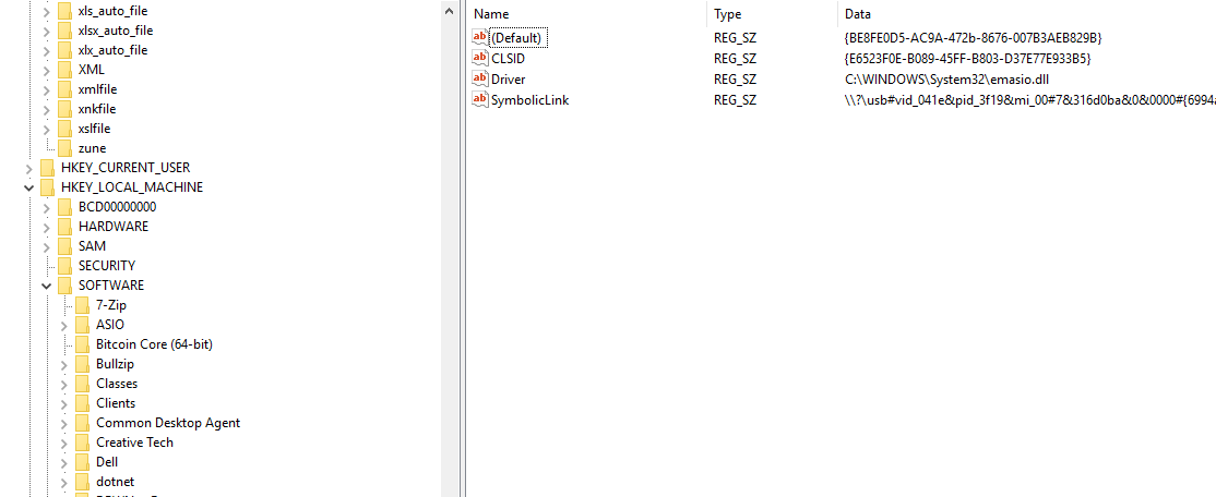

I searched the registry for "ASIO UAC2" deleting the keys one at a time. Each time restarting DiAna and checking the result.
It is this key that resolved the problem. The key is gone because I deleted it but this is where it was alone with the rest.
DiAna no longer shows the error code and ASIO UAC2 is no longer in the list.
Now, what to do about it?

A bit of discovery here. If I manually add a key to to KEY_LOCAL_MACHINE/ASIO/ it doesn't show up in DiAna. If I add the key to KEY_LOCAL_MACHINE/WOW6432Node/ASIO/ it does show up in DiAna and with a start up error -1.
So yes we can reproduce the bug.

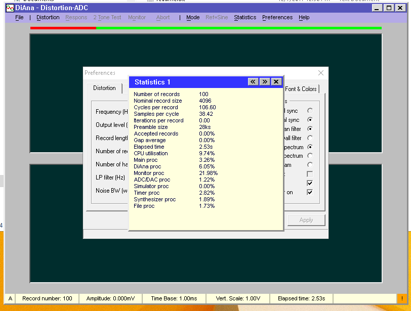

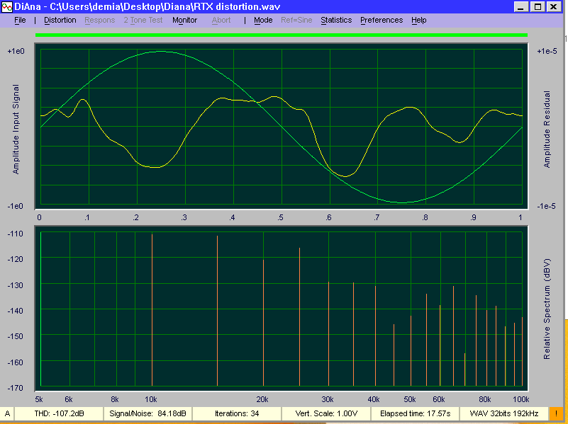

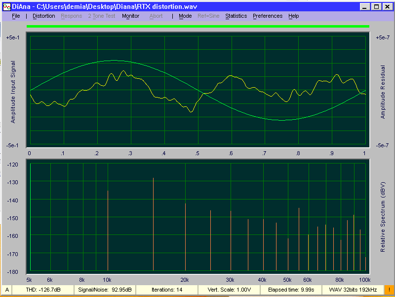

OK I made some progress. The half duplex was a bit confusing.
Here is loopback for the RTX and the Lynx. (the name at the top of the screenshot is wrong on one of these. The second is the Lynx L22)
