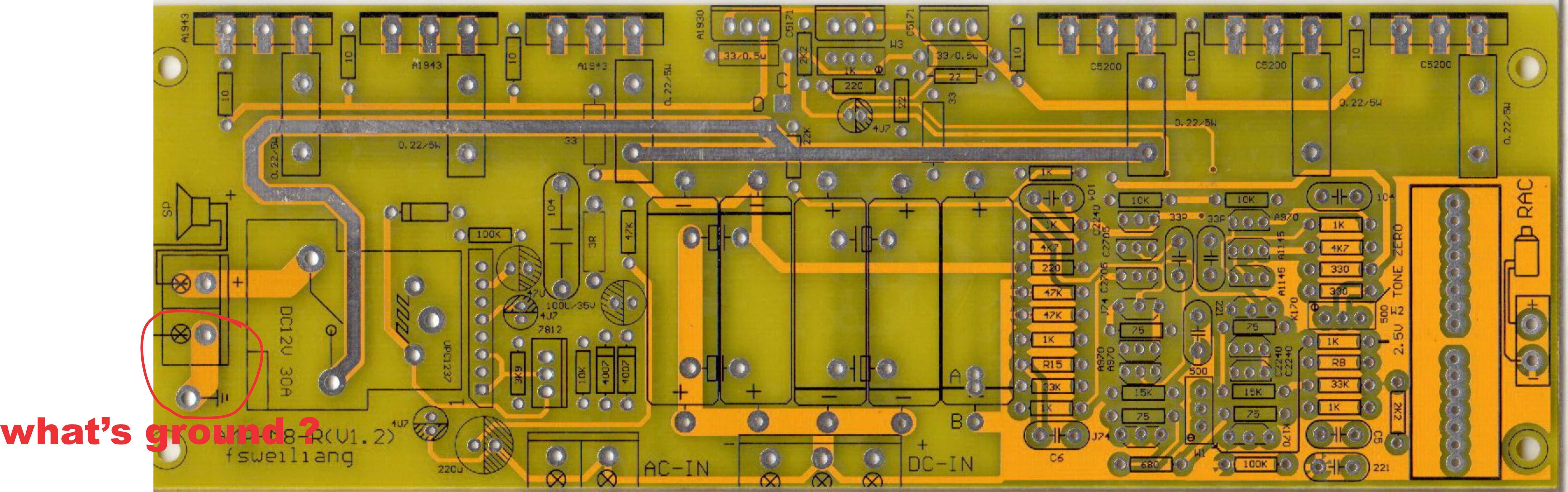

proper ground connection
There is a node ( and a big PTH hole too)label with ground symbol on the board. This is not an omission in PCB layout, but a prevention of large current flowing into the signal ground.
In any case, proper connection has to be like this, nothing fancy though.

You do not have to wire PS/case ground to the speaker ground on the board and then to the speker socket ground. I wire PS ground directly to the speaker socket ground.

Another very controversial issue: this star ground board. If the hole to weld with the ground symbol is available, because the designer did not like the other 99.99% by integrating the ground on one bus. According to the manufacturer Rane - A version of this RaneNote was published in the Journal of the Audio Engineering Society, Vol. 43, No. 6, June, 1995. Complete in Grounding and Shielding Audio Devices
"Chassis Ground vs. Signal Ground - Let us examine the distinction between chassis and signal ground in audio devices. Chassis ground is generally considered any conductor which is connected to a unit’s metal box or chassis. The term chassis ground may have come about since units with 3-conductor line cords connect the chassis to earth ground when plugged in to a properly wired AC outlet. In units with a 2-conductor line cord (consumer equipment), the chassis does not connect to earth ground, though the chassis is normally connected to the signal ground in the box in both unbalanced/consumer and in balanced/pro equipment. Signal ground is the internal conductor used as the 0 V reference potential for the internal electronics and is sometimes further split into digital and analog ground sections. Further signal ground splits are also possible, though it is important to remember that all “divisions” of signal ground connect together in one place. This is usually called a star grounding scheme. It is easy to confuse chassis ground and signal ground since they are usually connected together — either directly or through one of several passive schemes. Some of these schemes are shown in Figure 3. The key to keeping an audio device immune from external noise sources is knowing where and how to connect signal ground to the chassis. First let’s examine why they must be tied together. We’ll cover where and how in a moment. There are at least two reasons why one should connect signal ground and chassis ground together in a unit. One reason is to decrease the effects of coupling electrostatic charge on the chassis and the internal circuitry. External noise sources can induce noise currents and electrostatic charge on a unit’s chassis. Noise currents induced into the cable shields also flow through the chassis — since the shields terminate (or should terminate) on the chassis. Since there is also coupling between the chassis and the internal circuitry, noise on the chassis can couple into the internal audio. This noise coupling can be minimized by connecting the signal ground to the chassis. This allows the entire grounding system to fluctuate with the noise, surprisingly providing a quiet system. Further coupling reduction is gained when the chassis is solidly bonded to a good earth ground — either through the line cord, through the rack rails or with an independent technical or protective ground conductor. This provides a non-audio return path for any externally induced noise. The second reason to connect signal ground to chassis is the necessity to keep the signal grounds of two interconnected units at very nearly the same voltage potential. Doing so prevents the loss of system dynamic range where the incoming peak voltage levels exceed the power supply rails of the receiving unit. Unbalanced units connect successive signal grounds together directly through each interconnecting cable — the sleeve of each RCA cable. This, and the fact that the chassis is generally used as a signal ground conductor, keeps the signal ground impedance of unbalanced systems very low. Many may agree that unbalanced systems are helped by the fact that the chassis are normally not earth grounded. This allows an entire unbalanced system to float with respect to earth ground. This eliminates the potential for multiple return paths for the audio grounding system, since there is not a second path (ground loop) through the earth ground conductor. Low signal ground impedance between units is essential for acceptable operation of all non-transformer-isolated systems, balanced and unbalanced. The design of balanced interconnection does not connect signal grounds directly together. The negative conductor provides the required signal return current.
To avoid loss of dynamic range, balanced systems use a different method of keeping signal ground potentials small. "

The scope of this article Rane on how to eliminate hum in unbalanced system. Therefore considerations about the importance of unifying two ground models, the low level at the entrance and the ground board, just what has no connection at Diamond Diff, in version 1.2. I may have misunderstood, but modern systems of amplifiers do not use two separate earthing systems. The ground amplifier should be only one strong track. In the figure shown by Tin Stanton suggests something similar star ground connecting the speakers in the PSU, it can form causing ground loop hum.
