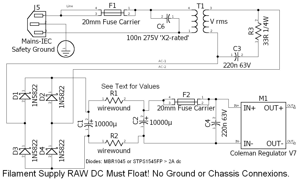

It's not the same working at 50 bias and there is a reason for having the resistors out: possibility to change/swap them fast if want to implement filament bias. Filament bias with 50V drop with 1.035A current means 53.5 VA dissipation and quite larger resistor wattage required. 15V drop is 3.5 times less. Quite a difference!

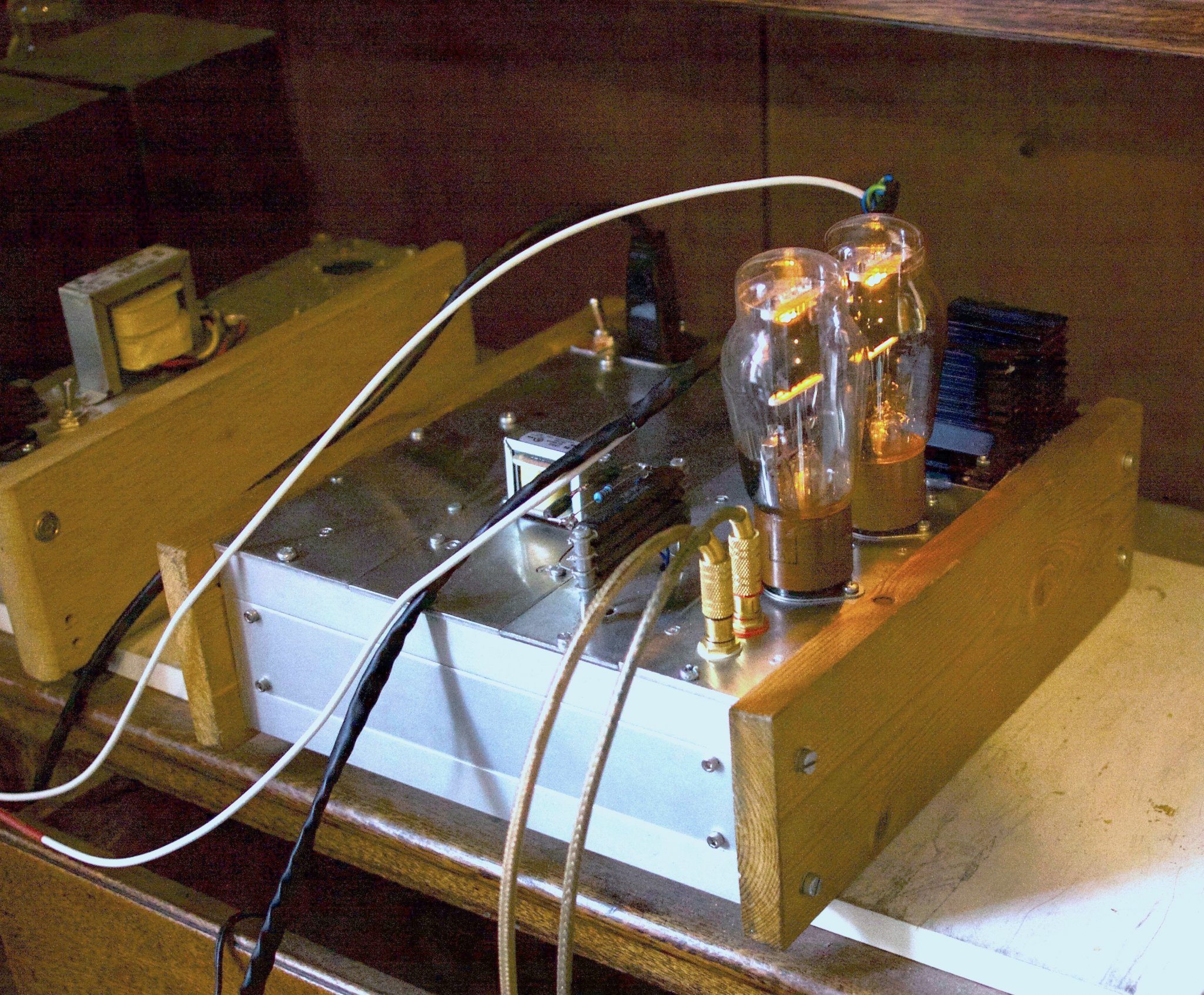

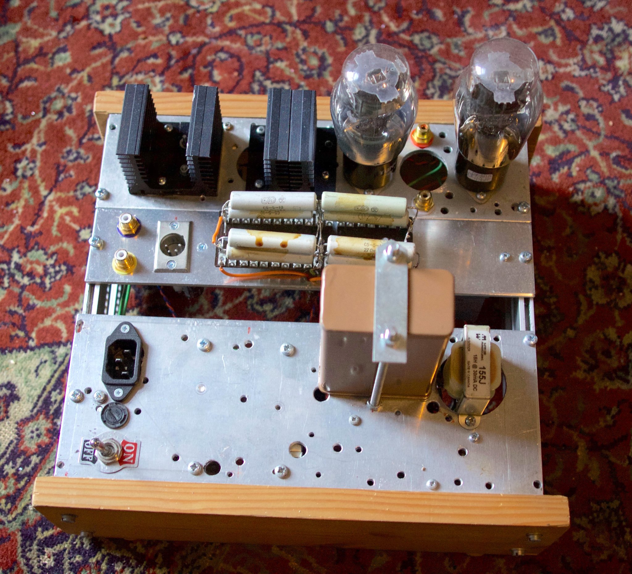

Hello - good to hear from you! In terms of bias for these large DHTs you can see from the photos of working 10Y and 46 stages that even with around 10V bias the cathode resistors, and the heatsinks for Rod Coleman's regulators, are large and get very hot. You can see the discolouration on the Russian military resistors in the cathode due to the heat, and you can see why they need to be mounted outside the chassis. It would be the same with a 6C4C. The heatsinks I've used are the minimum size - they get hot to the touch but not burning hot. A bias of around 10-12V suits the 10Y best. The 46 and 6C4C are outside their usual operating points but still work fine and sound good. These are the compromises I've talked about with filament bias. If you increased the bias you would need bigger heatsinks and cathode resistors and a bigger filament transformer - the filament supply is in a large external box. So it's easy to see the practical limits you work with by using a 10Y, 46 or 6C4C. Taking up the bias voltage much beyond 10V would give you a monster of a boat-anchor - just not a practical design. As built these stages sound very good indeed. In my case they are the drivers for the 2a3 outputs, and I use a Hammond 1140-LN-C SUT in 1:4 to increase the gain. The 10Y has a mu of 8 and is my regular stage. The 46 has a mu of around 5.6 so could really do with 1:5 SUT or more. The 6C4C has a mu of just over 4 so needs an even bigger SUT ratio, but it would make a nice preamp stage because of its low Ri. It sounded very good with a cathode bypass cap and, like the 10Y and 46, would sound better still in filament bias. Filament bias is cleaner and more detailed. Pics below. The 46 stage was just an experiment, and the modular chassis shows this, but it does in fact sound excellent.It's not the same working at 50 bias and there is a reason for having the resistors out: possibility to change/swap them fast if want to implement filament bias. Filament bias with 50V drop with 1.035A current means 53.5 VA dissipation and quite larger resistor wattage required. 15V drop is 3.5 times less. Quite a difference!
That is not true - filament DC bias is NOT connected to PS ground. So no current of 1A (in this case of 6C4C) from DC heat to ground!!!It's not the same working at 50 bias and there is a reason for having the resistors out: possibility to change/swap them fast if want to implement filament bias. Filament bias with 50V drop with 1.035A current means 53.5 VA dissipation and quite larger resistor wattage required. 15V drop is 3.5 times less. Quite a difference!
"Filament supply RAW DC must float! No ground or chassis connexions"
So trough the Rk, Io is going only. That 1A is going trough the filament only...
And this 35mA (from Yours 1.035A) is active with abs(-50V) so the dissipation at Rk is 1.75W
Please take a care it could be very dangerous!
Read this https://www.audioasylum.com/cgi/t.mpl?f=tubediy&m=181722.That is not true - filament DC bias is NOT connected to PS ground. So no current of 1A (in this case of 6C4C) from DC heat to ground!!!
12.5mA / div !!!Hi euro21 You are talking of 25mA but in the graph Io=12.5mA
Hey - thanks! That's a great link. I can see from the date that I've been using filament bias since 2010. That's 12 years already and many, many builds. For years I used PSE 4P1L outputs in filament bias and they were quite good, though not equal to a 2a3. Filament bias came from Thomas Mayer to us DIY guys, and it's good to read his comments. He has deleted most of his DIY stuff from his site, and thinks of himself as a manufacturer these days with his uber-elegant and expensive amps and preamps and his own range of tubes. Between Thomas and Rod Coleman we now have filament bias as the bias of choice for DHTs. Those 2 guys have really made a difference!
The raw power supply is floating and it goes to ground through the bias resistor. Hence ALL current of 1.035 A goes through such resistor. That is filament bias. Otherwise it would be called cathode bias. Clearly you have never done it.That is not true - filament DC bias is NOT connected to PS ground. So no current of 1A (in this case of 6C4C) from DC heat to ground!!!

Yes but it this case filament supply is not floating - as You wrote that warning in the manual...It's only the Raw DC (rectifiers, capacitors) that are floating.
Filament Bias: REGULATOR OUTPUT connects FIL-( NEG) to anode-supply-0V.
This makes I(Rk) = If + Ia

Yes BUT - Only in this type of the connection of NON-Floating Filament supply.The raw power supply is floating and it goes to ground through the bias resistor. Hence ALL current of 1.035 A goes through such resistor. That is filament bias. Otherwise it would be called cathode bias. Clearly you have never done it.
You right about that, I didn't try that way, and I never will. Because of too high disipation and hard limit in the Anode voltage that is a must with this way. I tried only Floating regulated DC with CCS module. Own design...
This non-floating way limits the design even for lower filament currents, and for higher filament current of DH power tubes, is almost impossible to achieve safely because of high dissipation...
Still the rest of Your parts of the schematics are not good...
And there was no clear schematic of the filament-Cathode resistor circuit shown...
