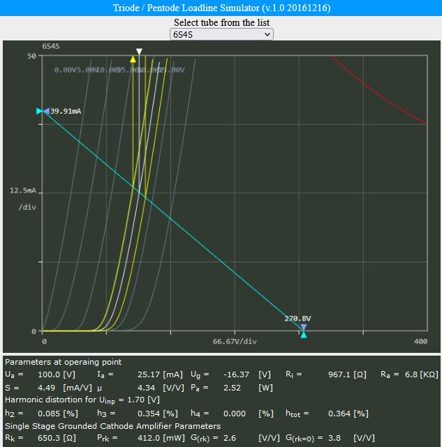

IMHO nothing wrong with this (100V, 25mA, about -16.5V, Ri: 967R) 6C4C operating point, if you use this tube with low (+/- 2..3V peek) grid swing (preamp).
BTW 25mA isn't "low current", large transmitting tubes as preamplifier also works in same region.
sample:
http://trioda.com/tools/triode.html
simulation
At 6k8 load, it produces about 0.36% THD, mainly h3.
At 200V, 60mA, -33V (Ri: 788R) the THD (at same swing, 6k8 load) is about same as previously, 0.36%, mainly h3.

These online toola are very useful, but should be checked with off-line simulation software in the full circuit network.
In that picture might look that settings are in linear region but if Ypu take a look in real published Anode characteristic - that is not a linear region.
I get H3=0.03% at the same point, with other java soft, (not spice)...

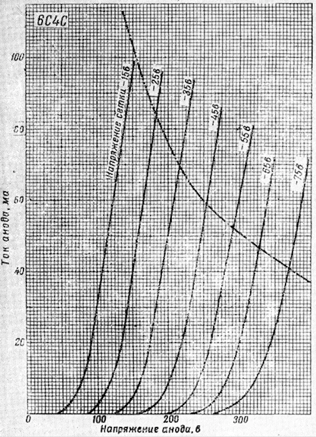

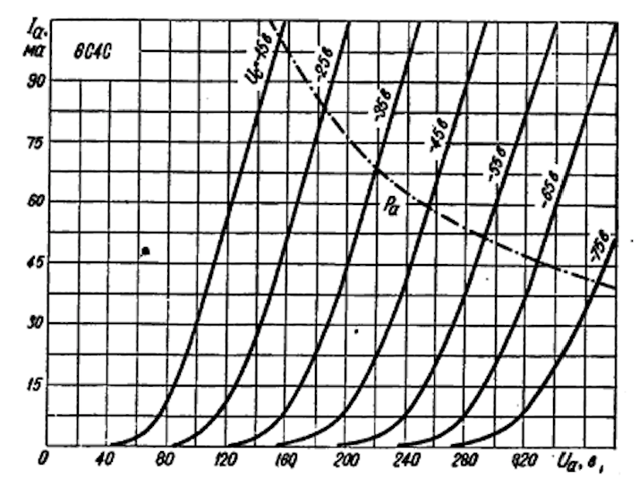

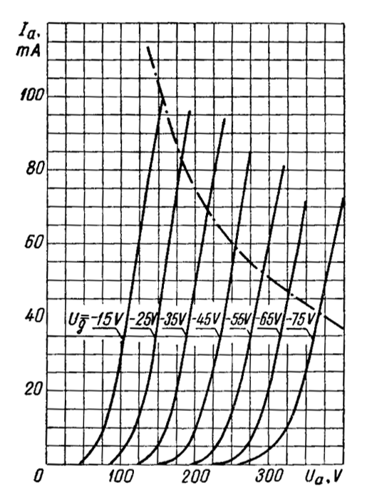

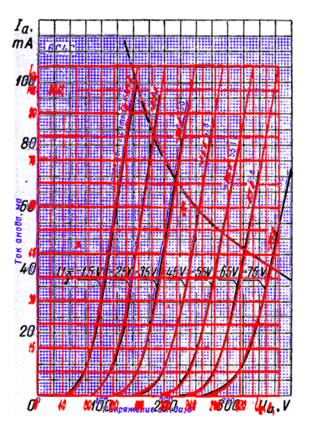

I compared 3 available graps of anode chrs for 6C4C thay are all the same.

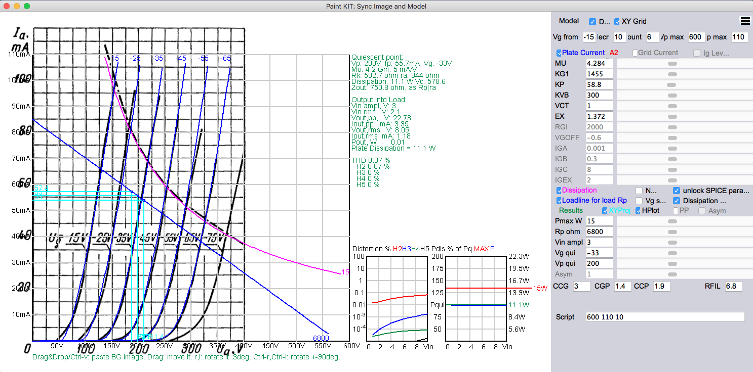

**** TEST Composite DHT *****************************************

It is not possible that SE have dominant H2 not H3... this is not reliable online sim solution...At 200V, 60mA, -33V (Ri: 788R) the THD (at same swing, 6k8 load) is about same as previously, 0.36%, mainly h3.
Other soft showing H2 almost only, with H2=0.07% for 6Vp-p input
That is linear region, BUT Anode voltage still could be higher, and more important anode current is too high for using this tube in preamp. Anode power of 11.1W maybe, (because of higher current close to 60mA) is also unnecessary sufficient for this application...
