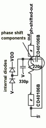

Here are some more thoughts about the phase shifter idea. Use 5v VDD instead of the 15v shown in the diagram, as the circuit is shown, that voltage seemed to work. I tested out the circuit on the LTspice simulator. On the Yahoo Group pertaining to that simulator, I obtained the CD4000 CMOS library from the files section. I am not good with computers, so that says a lot for the user-friendliness of LTspice.
In my simulation, I also made the phase shift capacitor 100pF, and varied the resistor from a few hundred ohms for a maximum phase shift of about 180 degrees to 270k for the minimum of about 0 degrees. I used a square wave with a period of 40 microseconds because I hope to get the zero voltage switcher to use resonant capacitors in the range of 0.1uF on each output MOSFET totem pole. I really do not know if I can get it to work that way, but I expect a quiet running supply with little consideration needed for parts layout to be the result if successful. I would hope it to have usability in powering a class D amp. Yet, one caution about this ZVS approach which uses relatively large resonant capacitors is that if the circuit does not stay in ZVS mode, the MOSFETs may overheat from hard-switching against the capacitors, and the low EMI sought will disappear.
I may try to use phase modulation in a class D amp if I get around to it. This type of phase shifter may work in conjunction with a class D pulse width modulator to drive the output MOSFET totem poles out of phase, but, it really seems like a lot of work for an amp. A phase-modulated amp may also require a carrier-based approach. At least the frequency would need to be fairly constant, I'd say. I tend to think classd4sure was on the right track in regard to a good amp design along the lines of a UcD.

Ahh, it finally worked when I added a capacitor from the phase shift one to the power negative to conserve the original charge and to prevent it from shunting to the supply rails. One of the reasons it did better now is that I made it 50% larger than the phase shift cap instead of the wrong way I had tried it--50% smaller. Now it should not depend on the power supply. So if the phsh cap is 220 pF, the shunt cap value becomes 330pF. If the phsh cap is 100pF, the shunt cap becomes 150pF. The simulator may have a quirk when certain combinations are selected. So I had good test results with the 220/330 pair.

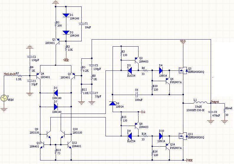

I've been watching this forum and have decided that I would like to make a UcD clone. Upon successfully simulating the amplifier I decided that I would construct a PCB. The board is stuffed but the circuit fails to oscillate. I've tried several things but the circuit still fails to oscillate. I must admit that I'm no controls expert.
My main objective with this project is to learn about self oscillating amplifiers. It doesn't matter if all I can get with my board layout is 5 watts I just want to see it working and if possible I would like to do that while keeping things as simple as possible.

Hi Randy,
One thing I think it needs is power to the upper driver circuit before the bootstrapping takes over. To ease that requirement, you may wish to increase the value of R10, and probably R16 as well, by a considerable amount. Then a resistor connected from the upper power rail to the positive power node of the upper driver can dissipate less power.
subwo1 said:One thing I think it needs is power to the upper driver circuit before the bootstrapping takes over. To ease that requirement, you may wish to increase the value of R10, and probably R16 as well, by a considerable amount. Then a resistor connected from the upper power rail to the positive power node of the upper driver can dissipate less power.
Sub is right, the simulation schematic omitted all startup circuitry since it would just have slowed down the simulation and wasn't pertinent to the normal up-and-oscillating operation of the amp. However, before changing the value of the pull downs resistors, I'd recommend you try precharging the bootstrap capacitor prior to enabling the amplifier.
Put a 12 volt Zener across C6 and connect a 100k from its cathode to Vdd. Use the Vee connection to R2 as an enable switch (lift to disable). Apply power and wait about 10 seconds for the bootstrap supply across C6 to come up, then reconnect R2 to Vee. This is a kludge only good for testing, but it should get the amp to start up.
Good luck -- analogspiceman

analogspiceman said:Put a 12 volt Zener across C6 and connect a 100k from its cathode to Vdd. Use the Vee connection to R2 as an enable switch (lift to disable). Apply power and wait about 10 seconds for the bootstrap supply across C6 to come up, then reconnect R2 to Vee. This is a kludge only good for testing, but it should get the amp to start up.
I forgot to mention that you must provide a return path for the bootstrap charging current. This can either be through some sort of load, if connected, or through another 100k resistor from the junction of the output mosfets to the existing 12 volt Zener you have referenced to Vee.

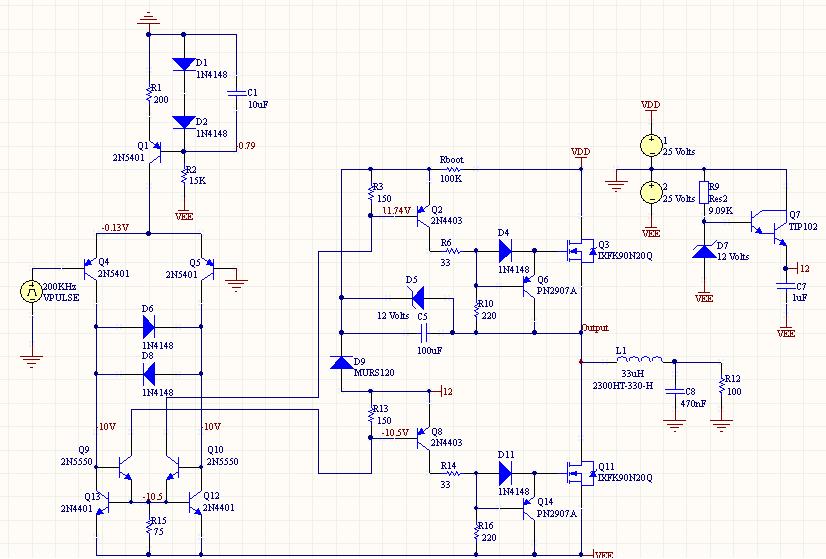

I did some more messing around last night but no luck getting it oscillating I'm really quite unsure what I'm doing wrong. I placed a zener diode across C6 [100uF] and a 100K from the cathode to VDD. [I had a 100K load resistor for the return path] waited 10 seconds and connected R2 back into VEE and no oscillations.
My supply voltage was +/- 25 Volts and the input signal was grounded.
Is there an easy way to "divide and conquer" this circuit? I mean is there something I could do to say the feedback loop or an input which if didnt do as expected could help me isolate the problem to either the comparator or the mosfet driver? This could save me lots of time.
Otherwise I'll go through all the nodes and record the voltages and post them here later tonight.

Yes. Cut the loop and apply a 300kHz signal wave to one comparator input (+/-1V sine or square will do) with the other grounded.Randy Knutson said:analogspiceman,
That way you don't have to worry about getting the thing to self-oscillate before you know if the rest is workin OK.
Attached is a schematic of the circuit I am testing. All voltages shown are referenced to GND. [-25 gnd +25] Per Bruno's advice I still did not manage to see anything on the output... This circuit is starting to frustrate me!
Does anyone spot anything wrong

Yes, the input current source (associated with Q1) should go up to the positive supply, not ground.
Please fix and report back. -- analogspiceman
Yes, that would explain a lot. You should see of order +0.65V d.c. average with a zero average d.c. source (that is, your 200kHz generator) at the emitters of Q4-Q5 when there is actual collector current out of Q1.
The measurement of -0.79V at the base of Q1 indicates that all the current from R2 is flowing through R1 and the base-emitter junction of Q1---was this a sim result or a measurement?
