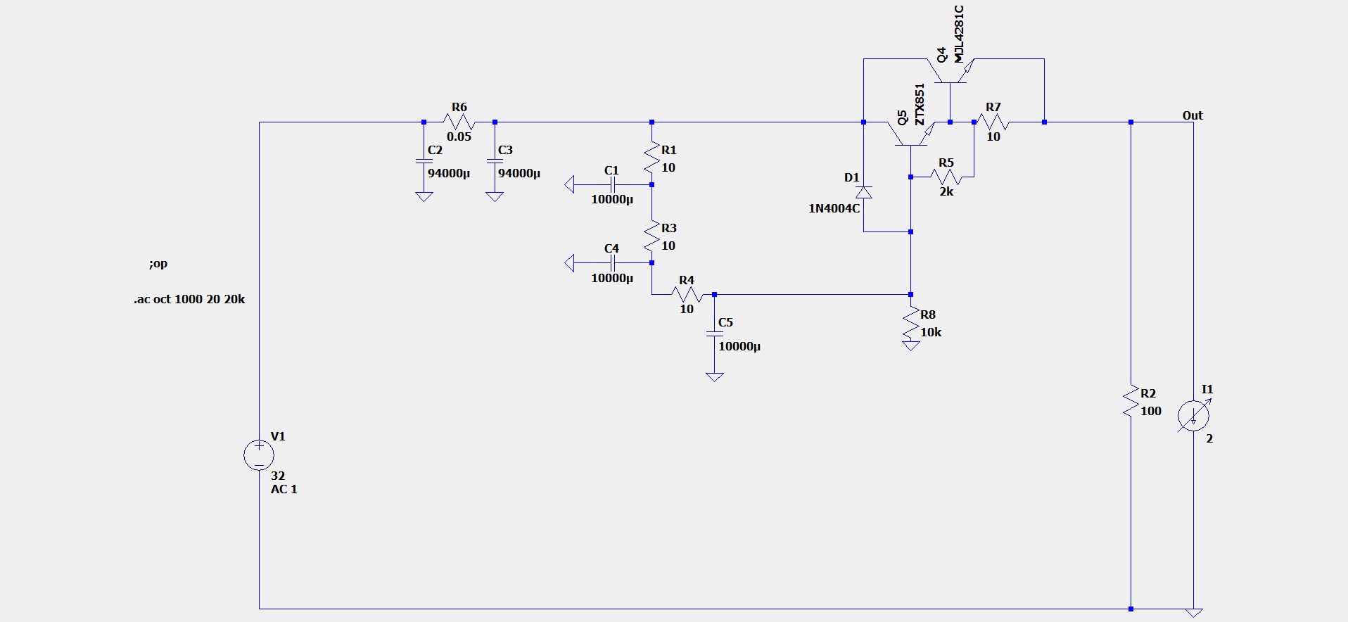

Really the best approach would be an unregulated cap multiplier using bipolars for those who can't deal with at least a 15% dropout (+ dropout of regulator).

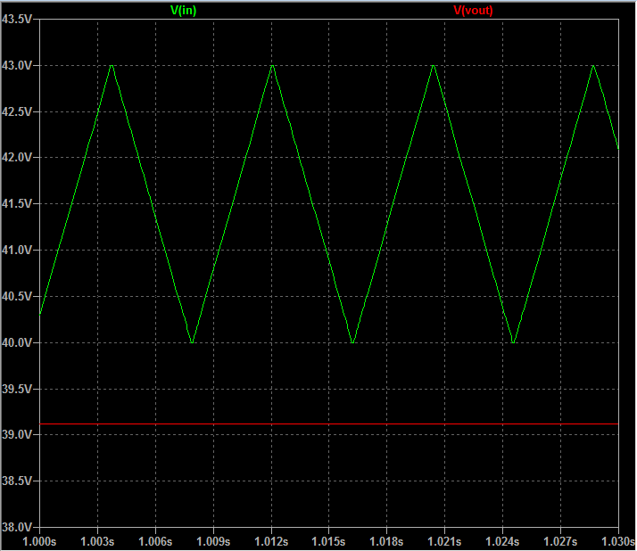

Then "regulate" to (Vtrough - 1V). Remove all VREF circuitry and use those components to build a moderately precise Vtrough sensor. When mains is unsagged and Vinput_trough is 47V, you get 46VDC output. When mains is 15% sagged and Vinput_trough is 40V, you get 39VDC output. At no net increase in component count.
Best of all, you get negative feedback. If it's a good design you get giant amounts of negative feedback. This eliminates ripple far more effectively than a no-feedback capacitance multiplier, whose ultimate performance is limited by the Early effect.
Full Dual Polarity Supply
R13, shows 10 Ohms, and R7 shows 100 Ohms, this is just to indicate anything between 10 Ohms and 100 Ohms will be ok, they should be the same value, just use whatever value you have laying around.
R1, shows 47 Ohms, R18 shows 100 Ohms, they should be the same value, just indicating anything between 47 Ohms and 100 Ohms will be ok
R19/R22 shows 4.7k and R11/R5 shows 2.2k, just indicating any value between 2.2k and 4.7k will be ok. They should be all the same, just use what you have between these values.
Refer back to this post for schematic.

One circuit, two different input waveforms. Left picture no-sag, right picture yes-sag. Output drives 2.3 ohm resistor, i.e., 20 amperes.
In both cases, (Input - Output) is less than 1 volt. Darlington will have more than 1.4 volts (Input - Output), thus 40% greater power dissipation with 20 amperes flowing.
You can reduce this by changing to a FETlington but now you have to find a Pchannel JFET with Idss > 100mA to build your negative regulator. Yuck.

I have removed the voltage references from your circuit and only get 20dB PSRR at 100Hz.
It's possible you have made some other change I am not aware of.
If you could share the unregulated version that would be helpful.
Hi Mark on the unregulated version of your circuit, I am getting a drop out of 5.5V.
The Output Impedance is below 10 mOhms
PSRR at 100Hz is around 65dB or better but highly dependent on parts and setup.
The circuit is so sensitive to part selection and feedback values it would be a nightmare to setup.
Maybe you have found a way to avoid these issues.
I will try the original regulated version you posted.
With the regulated version setup for 5V dropout to allow for mains fluctuation
I get 65 db PSRR at 100Hz
Output impedance below 10mOhms
The performance is not as good as the circuit I posted earlier, but it is a lower dropout circuit and it is still very good.
So for people that want 5V dropout instead of 8V, this is definitely good.
Hi Mark
Looks like the cap multiplier is better for the lowest dropout.
If you can get the unregulated version of your circuit working better than I can, that would be awesome. Better, as in 1V dropout unregulated.
The problem I am getting is that once you start adding some gain the voltage goes negative at the output.
It seems to work at 5.5V dropout but you may as well use the regulated version in that case.
