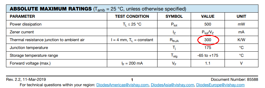

I think you will be able to gauge the safety or danger of that proposal, by looking at Figure 4 of this 500mW Zener datasheet. If your favorite Zener's datasheet doesn't have a graph like this one, then either switch to Vishay Zeners, or assume your Zener is perfectly identical to Vishay.
Also you can calculate the junction temperature, if you know (a) the temperature of the surrounding air, and (b) the power dissipated in the Zener diode, and (c) the thermal resistance of the diode + its package. Fortunately the datasheet tells you this (red circle).

At 100mW to 120mW looks like Junction would be around 30 degrees above ambient (rounding down of course) so junction temp would be around 60 degrees Celsius.
I tried adding additional bias in the manner you suggested, this did not improve the performance of the circuit further, so I will leave this mod out for now.
Since the sweet spot is around 12mA (60mW to 70mW), it looks like 0.5W Zeners will be adequate

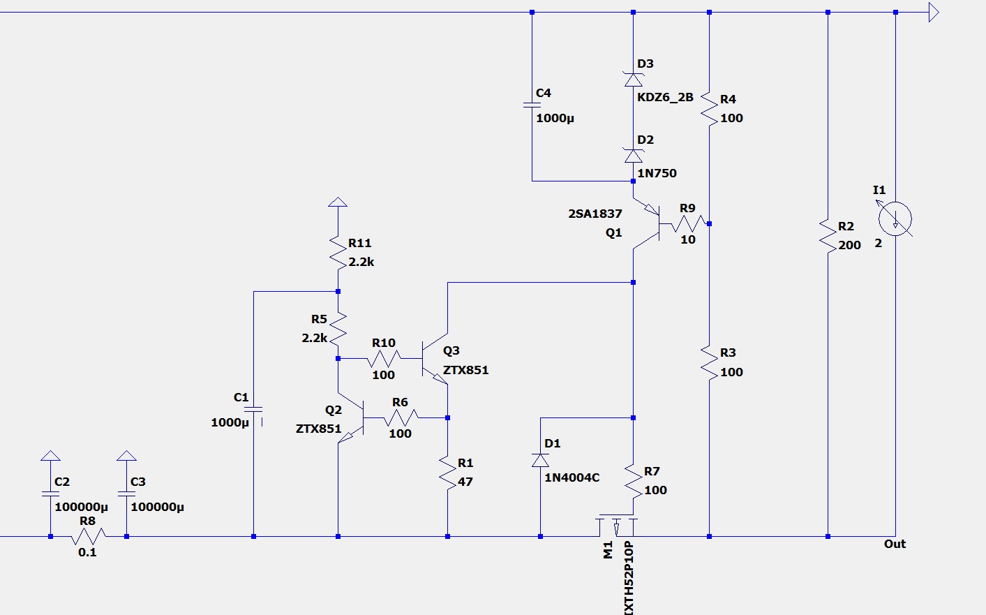

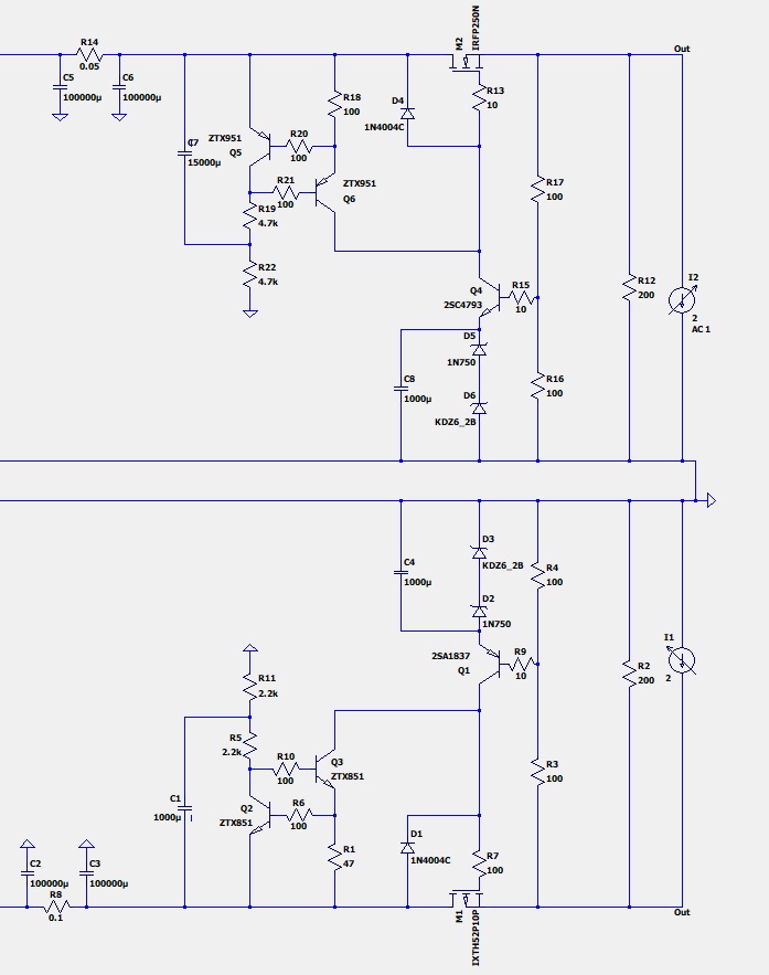

Full Dual Polarity Supply
R13, shows 10 Ohms, and R7 shows 100 Ohms, this is just to indicate anything between 10 Ohms and 100 Ohms will be ok, they should be the same value, just use whatever value you have laying around.
R1, shows 47 Ohms, R18 shows 100 Ohms, they should be the same value, just indicating anything between 47 Ohms and 100 Ohms will be ok
R19/R22 shows 4.7k and R11/R5 shows 2.2k, just indicating any value between 2.2k and 4.7k will be ok. They should be all the same, just use what you have between these values.

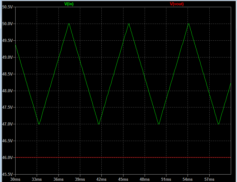

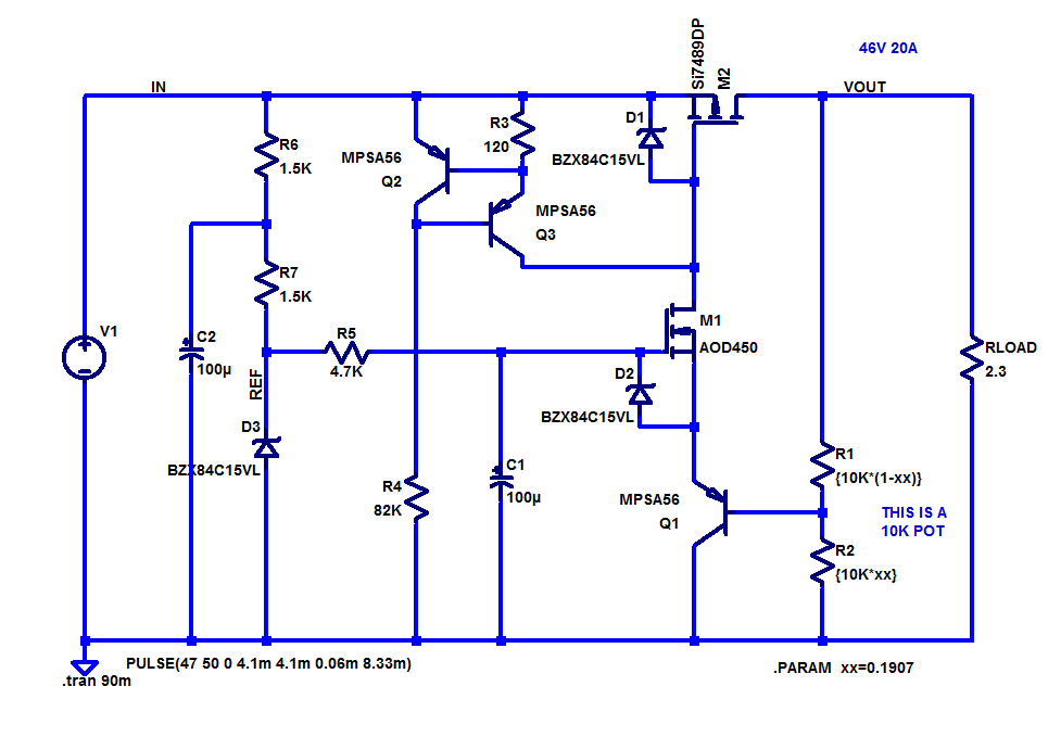

Here is a quick sketch of a 5 transistor voltage regulator which outputs +46V DC at 20 amperes. {Math check: 46V / 2.3 ohms = 20 amps. check!}
Don't assume the circuit is perfect, don't blindly drop it into a piece of audio equipment without redesigning it yourself and "owning" the redesign. In fact, I may or may not have intentionally left a few bugs, weaknesses, and flaws in the schematic, simply to encourage you to do your own design and to learn from the experience.
Notice that the dropout voltage (Input - Output) is 1.0 volt. The input voltage falls as low as 47.0 volts and yet the output voltage is a stable 46.0 volts DC.
It regulates pretty well too. Output ripple is noticeably less than input ripple.

What happens if mains voltage sags by 15% and you end up with 40V at the input?
