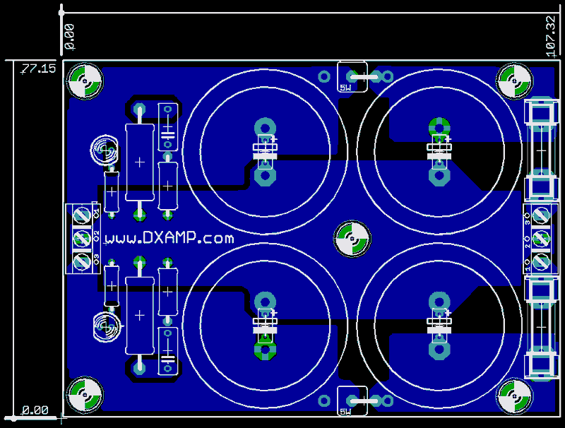

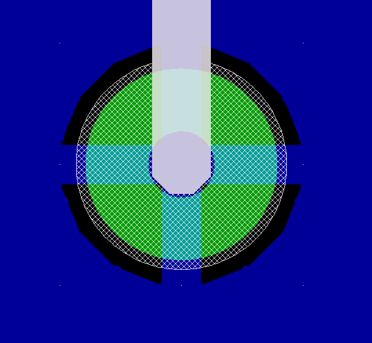

Nordic said:Greg, care to elaborate?
Hi Nordic,
I noticed you have thermals on two of the connections on the main caps but the other six are missing. It may just be the size of the picture or my bad eyes.
regards
Gotcha, what does it do?

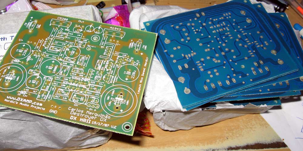

I got the boards today, I was a little unhappy, as they only put soldermask on the bottom, and used the guillotine when the v-score machine broke (apparently it is fixed again now).
Luckily they cut the boards larger than the corner marks, so a little fileing should make em look tip top again. I am happy with the silkscreen, and the soldermask is 98% ok, probably equal to normal commercial grade. Do scrape away some mask on small pads, if you are scared you can not get the solder in.... one pad that caught my eye was on D1. Some of them are just fine though.
If you don't own flux, go buy some... it will help your soldering 500%.

Hi Nordic,
Congradulations !!
When components are located on copper planes it prevents the heat from the soldering iron escaping into the large copper surface.
Soldermasks only go on the side with the traces and solder. On a single sided board that's on the bottom side of the PCB.
I always sand my PCB edges. I use a piece of fine sandpaper on a flat surface and sand until the colour of the edge matches the PCB surface colour.
Do you use rosin cored solder? I've never needed extra flux on soldering PCBs. I do clean the PCB with alcohol before soldering to ensure all traces of oil are removed.
BTW: I've soldered a lot of different metals over the years with lots of different fluxes.
regards
Congradulations !!
Nordic said:Gotcha, what does it do?
Nordic said:I got the boards today, I was a little unhappy, as they only put soldermask on the bottom, and used the guillotine when the v-score machine broke (apparently it is fixed again now).?
Nordic said:Luckily they cut the boards larger than the corner marks, so a little fileing should make em look tip top again. I am happy with the silkscreen, and the soldermask is 98% ok, probably equal to normal commercial grade. Do scrape away some mask on small pads, if you are scared you can not get the solder in.... one pad that caught my eye was on D1. Some of them are just fine though.
Nordic said:If you don't own flux, go buy some... it will help your soldering 500%.
regards
