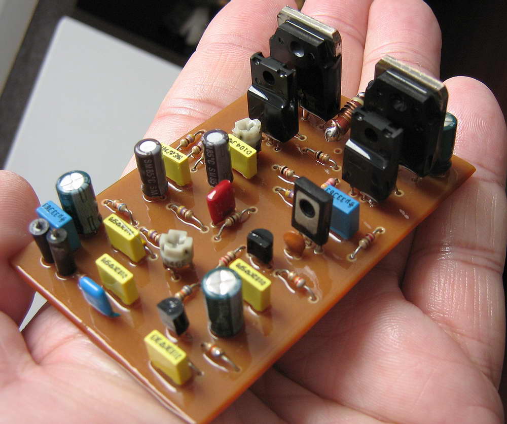

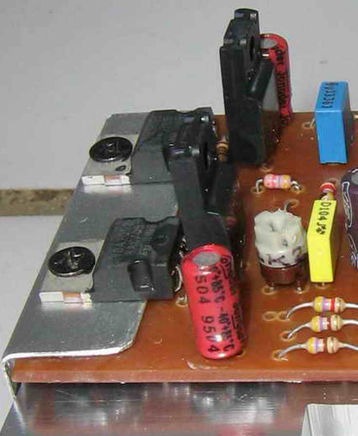

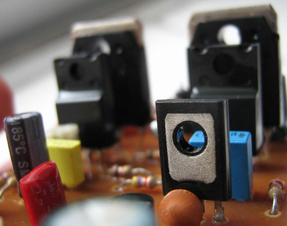

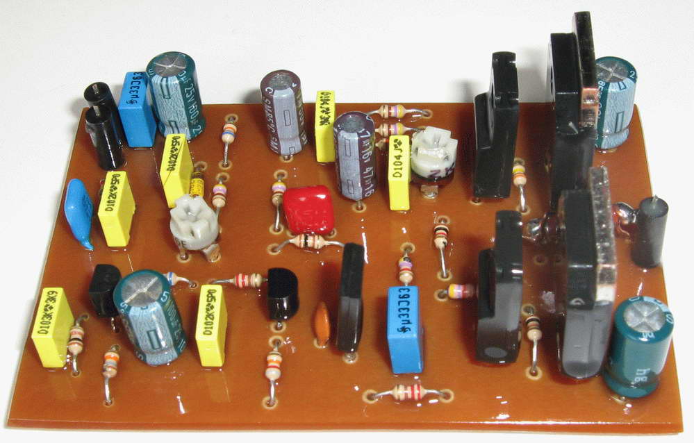

You are watching just a model...a non working thing..made to show
how the amplifier will look.... to evaluate its size...also details alike transistor mounting....those things.
The parts you may observe zooming in are not the real values..this is a non working circuit...a board with coloured parts over...respecting some positions of transistors and resistances only..something to show...a Maquette...a model only.
regards,
Carlos

Capacitor values crazy there..the drivers show are burned 7805 regulators....this is
fake construction...a fause circuit that do not works...if powered will explode...made to show you only.
Please, those boering guys, do not came to tell me that resistances have wrong value...aaaagh!
regards,
Carlos

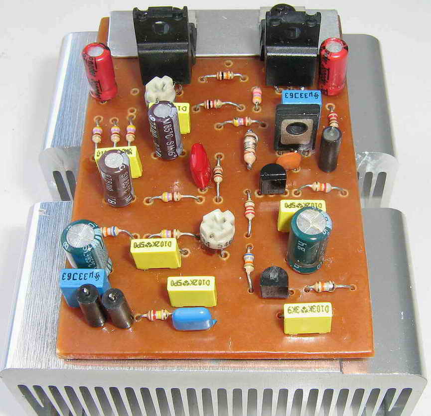

Carlos - i know that this question related capacitors C16 and C19 was discussed... and i don't ask that nobody is customizing the boards to my needs....
if i need the boards to look in some other way you know that i know how to make them suitable for me - what i am trying to tell you is that those caps can be made in front of the transistors and you can leave to everybodies choice to use them or not - avoiding the questions if somebody would like to use those caps and still bend the trensistors to L shape heatsink .... with the board that was kindly provided by Greg you can only install output transistor fromthe bottom of the board if you want to use C16 and C19....
maybe someone will have heatsinks that will not be that way and would like to bend transistors over the pcb - from the top - and could not do it or to leave out the capacitors and do it...
you know...
i hope that i am more clear now....
otherwise - the pcb is very clear and nice looking....
you know...

Hugh has made a wonderfull job Sparkle...so good that it is a hell to scape
from his good idea.
In my view...the same view you have...constructing alike Hugh did,
in his 55, will be the best idea.
I tried to avoid...as people can create their own ideas too..related to transistor coupling to heatsink..mount over heatsink...and maybe they may be able to create even better ideas than Hugh did...even telling you frankly that i have some doubts about it.... that folk...well Hugh..the one is really great!
Those condensers, placed into the rails power input lines, did not sounded here at my home... the remotion of them, will not be a problem if wiring from supply, to the board ,was made short..also if supply is good enougth.
I use, at least a 104 capacitor in that position...because those miliohms we can face, from the wiring resistance, may create a annoying "time constant"...so...the capacitor will take care of that, also will send to ground interferences that may enter from the supply...also will send oscilations to ground..supply variations of voltage resultant of HF modulations there.
Mine supply, for sure will not let interferences goes into the amplifier...It is a CarlosFM idea..very good one...but people can produce other supplies, with less care, related to avoid interferences from mains.
Yes guys!...i have installed them..those electrolitic condensers... very near the output.... into output colectors to ground.. rails to ground..and really near the transistors...but did not sounded!
So... if people decide to remove those condensers, and to install a L shape aluminium there....of course will be very pretty...and this can be fixed to non L shaped heatsinks too.
I would like to see people free to create......but not free to make modifications in the schematic shown...
The reason why is that i cannot control the hundreds of possibilities that can be made, this single schematic can hold hundreds of variations...and many of them will create a very different amplifiers.
This will need tests Sparkle, as you know..as you are an engineer.. the unit will need to be constructed, and this will be needed to guarantee that the amplifier is fine..and as i have opened the thread...i am responsable for the thread...if the one that created ideas was lazy..i will turn crazy doing all the job for him.
If those options, modified amplifiers were posted in this thread, as i am the responsable...i will have to explain those details, to test, to construct and to guarantee...and the real thing is not mine!!!...so...it is better that people, if they want to make modifications, that they open their own thread, with another amplifier name, they can mention Dx or not...their will to do this or not to do, and goes to defend their ideas, to answer the questions that will appear, of course, they will have to make schematic...board, copper lines layout and all hard work to show something "usefull" to our communitty.
This thread was created because the first one,full throotle, was crowdy... enormous quantity of things there....also this one i could not keept clean enougth of multiple schematics i have created because continuous listening and experiences made, so, there are many values and ideas....already confused enougth some guys.
I have a local friend...a Portuguese speaking friend ,that is already so confused that he is not following the thread anymore..ahahahahah!...sorry for that...he is saying that i am complicating to own some money constructing for him...ahahahaha....kidding of course..this is not honest to make.
Lineup has a pretty good idea..with lower power...but the problem is that he do not construct normally..he prefer simulations and to instruct young people about basic electronics and to discuss advanced electronics too...this way... i will not be happy to see his schematic published here....because i will turn crazy to make it, test it, and all those things...and this thread will turn even more confused.
Reason why i have invited him to open his thread, about his amplifier, that for sure will be a very good one.
regards,

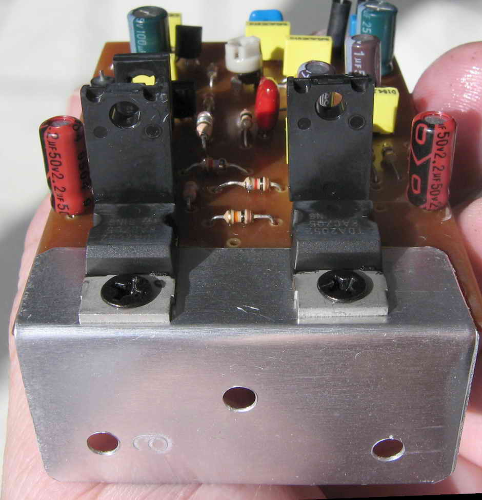

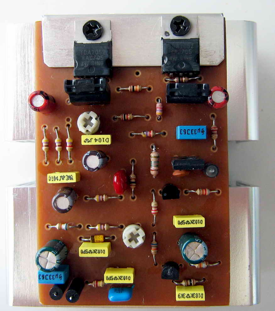

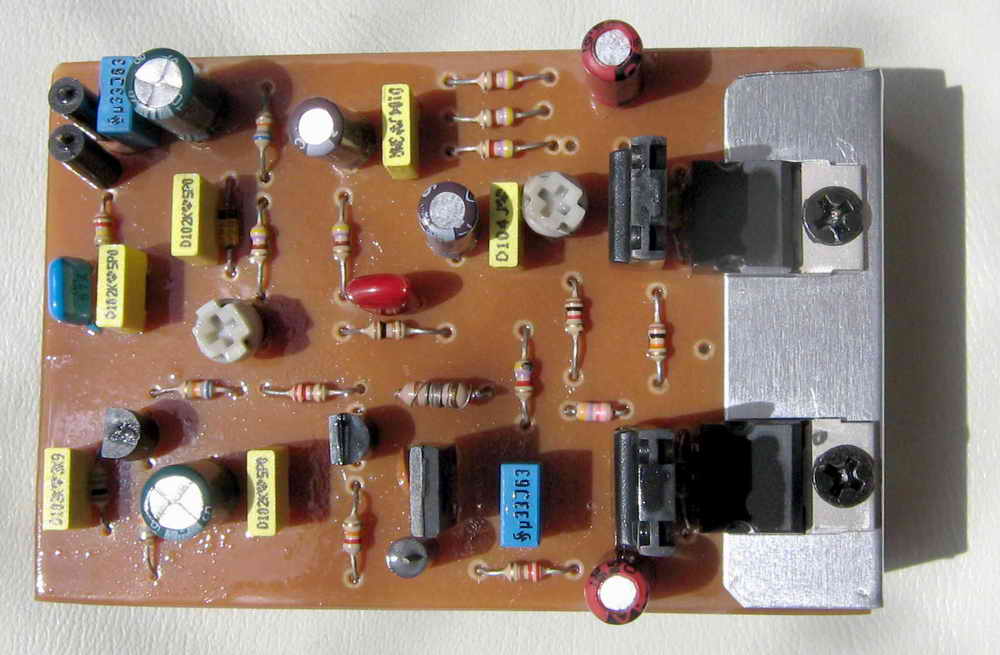

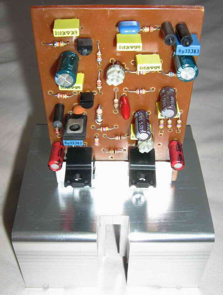

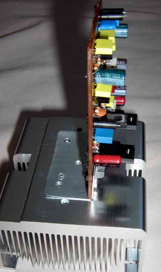

Here is one image, about the option to remove the rail condenser and to put it in another place...you may see the red ones at board sides.
Also the removal of the output coil..you may see it in the middle of the board.
Power transistors goes mounted over an L shape aluminium..screws gonna fix them in place...the longer L shape side will be screwed into some heatsink having large ammounts of thermic grease.
Of course you are watching small transistors...just to show in a model...also the rail filter condensers are fake... everything is fake in the image...but the shape, how it will look can be seen or imagined.
No insulator were use to this model...just some idea beeing shown....more hundreds ideas may exist...at your will.
The board will need some more milimeters long to hold the bigger transistors normally used.
This heatsink size can be enougth to one channel if a fan blower is used..this is able to dissipate 150 watts continuous if fan goes strong on it.
regards,
Carlos

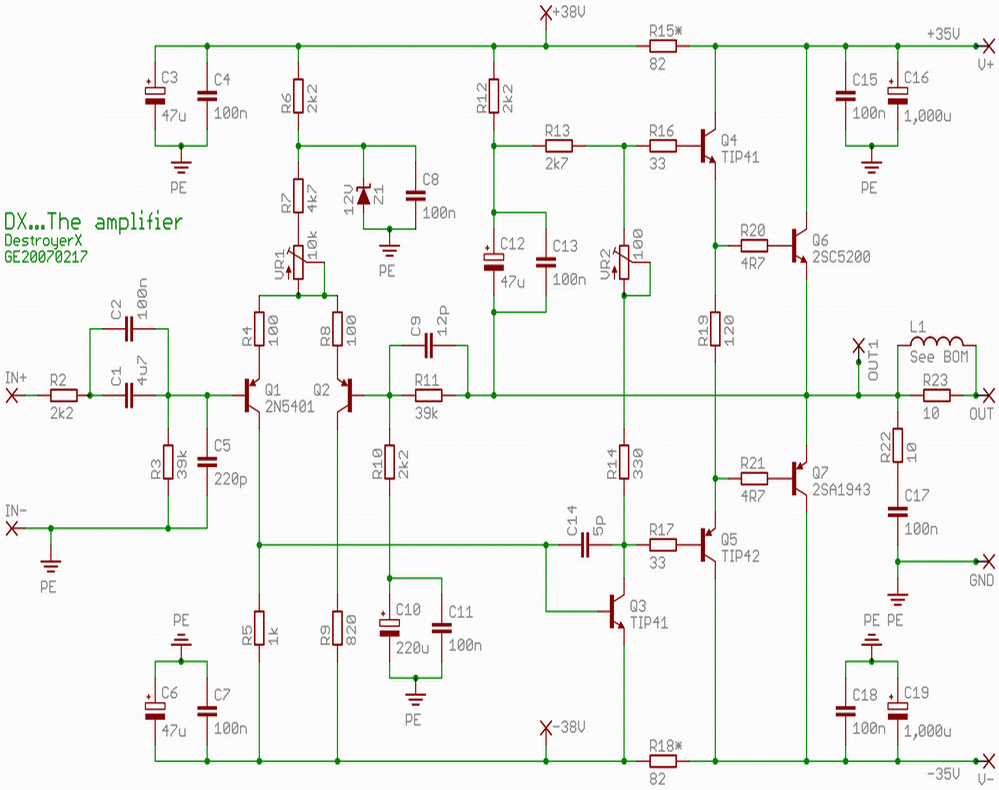

If you decide to use dual voltage supply...the one
having two outputs..one with 38 plus and 38 minus and ground
And another one with 35 plus and 35 minus and ground
Of course, as you know, those grounds are joined together.
In this case, the better is to remove the rail resistors...R15 and R18...but, if you decide to keep them there...please, increase the value to 180 ohms each one of them
Also you can avoid the dual output supply use...and you may keep the 82 ohms to the rails and will feed only 35 volts positive and 35 volts negative to the amplifier...in this last sittuation, the higher voltage to input will be not used.
But if you do nothing... assemble the way it is shown that will work fine either.
regards,
Carlos

wow, are you using dual supply.....35vdc and 38vdc ??
