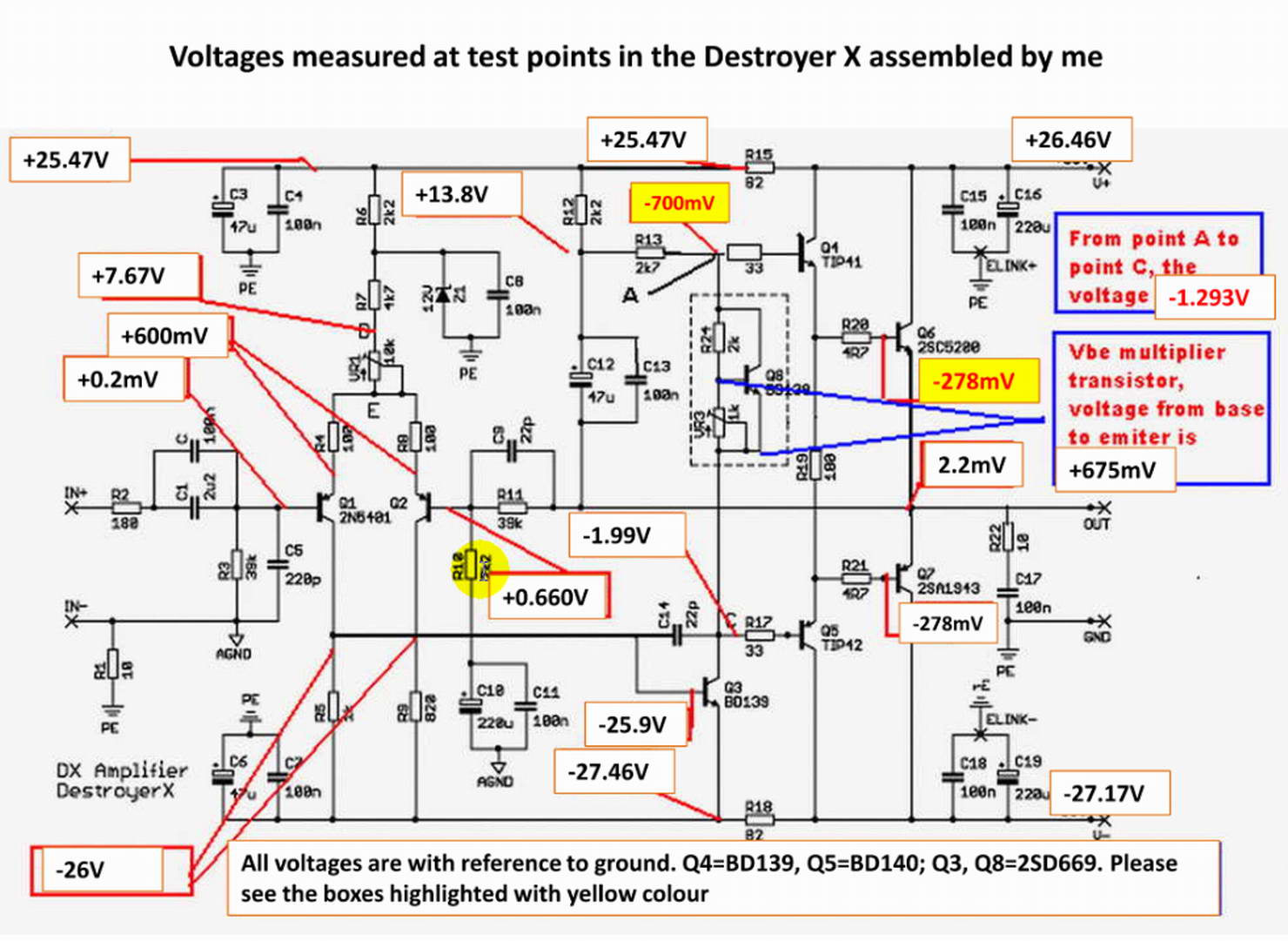

It is not naturally hot dear Manggo...you are having wrong bias
adjustment... search for instructions about how to adjust in this same thread as you are operating it misadjusted or having wrong connections from the heats sensor (BD139) to the circuit pcboard.
This may burn transistors because of excess of heat....usually, in stand by mode, the power transistor temperature never goes beyong 40 degrees celsius.
I cannot instruct you how to do it because i do not remember anymore.... thread is helpfull as for sure i have written how to do it..... i do not remember the method used.
Many amplifiers came after this one...i cannot remember details..... several years ago...uncle charlie is a little bit old (62)...i do not have good memory....my memory is what is written in the thread.

My dear friend Radhakrishan T and other people that faced
To Radhakrishnan T - YouTube
Troubles he is having because of different transistors and reduced power supply voltage... the supply voltage is too much low, to use the amplifier this way, we often have to make modifications in some resistor values.
I hope the video gonna help you.
The image attached is the one the friend from India sent me.
regards,
Carlos

Hi..Carlos..
I was tried building dx blame and i completly parts for my project,i am following the schematic
and pcb from Greg's Web Site
but..the result is not working.when i measure the output line with digital multimeter i read 35v dc more.my question is there something wrong with schematic and pcb layout?what i must to do for the solution?
when i see the top layout there is a note VR2 and R14 not used.is this right?and i see the line from ground to C17.is this a jumper ?thank you very much.
