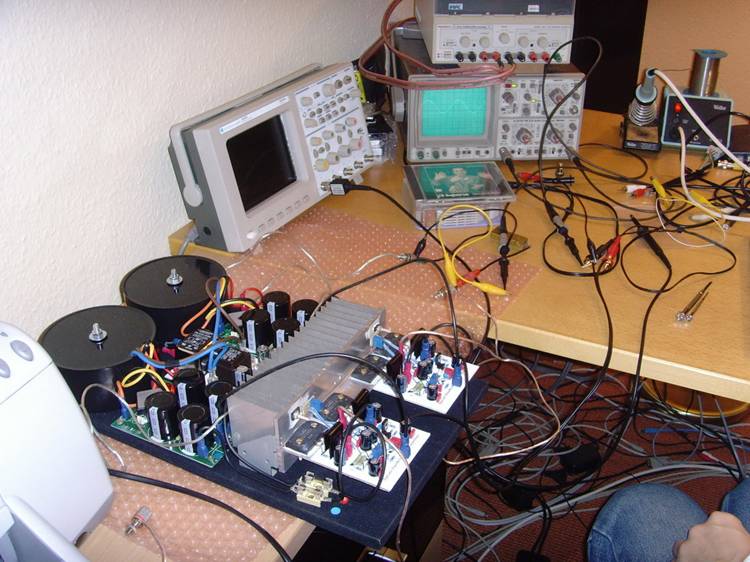

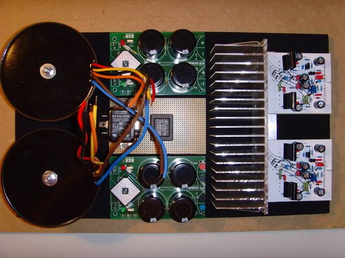

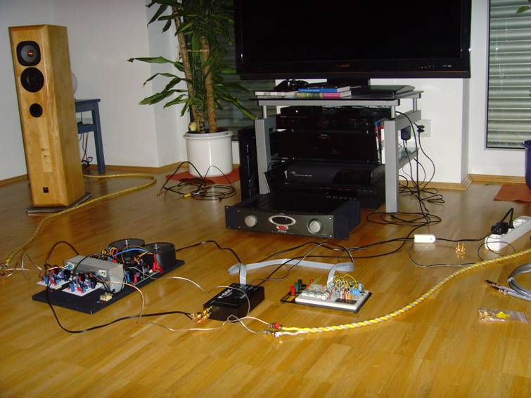

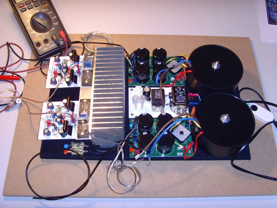

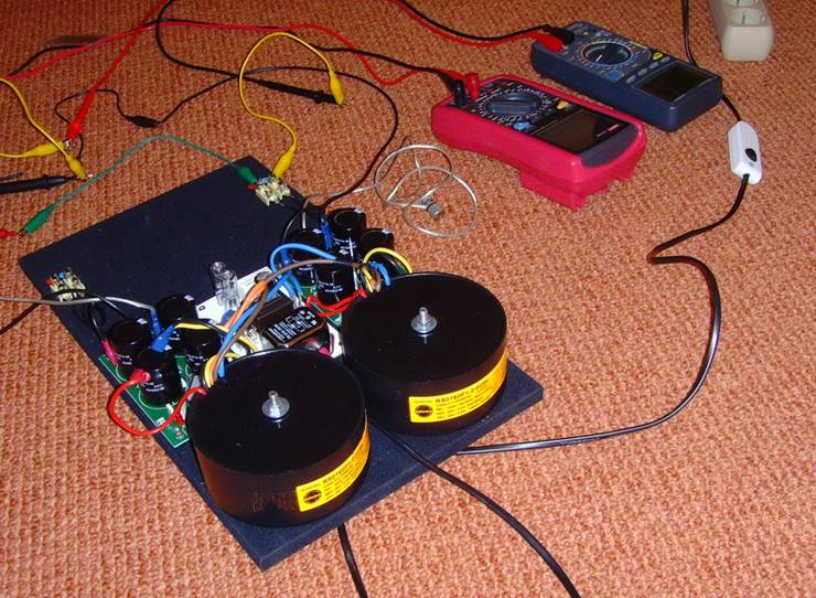

Thank you dear Max....... but i would like to post Rudi progress
about the Dx Amplifier he is assembling.
Everything tested, and he will "power on" this Sunday as he will travel, once again, working, from Hamburg to another German town.
Pictures attached..observe his special cable ...special speaker cable...low resistance one!
regards,
Carlos
regards,
Carlos
hi uncle carlos, i construct another dx amp because i sold the first one i make. one of our customer needs an amp and i let him hear the sounds of dx amp and he likes it very much. So i construct another one but as i test it everything is ok, the sonic is excellent except that the speaker will move out and in during powering up the amplifier. i havent notice this thing in my first dxamp.
i try to measure the voltage in the speaker output(without speaker) as i switch on the amplifier, my voltmeter measures 8 volts and then back to zero. maybe thats why the speaker moves out and in.
Is this normal? because everything seems to be great.
Hello Masterinvi...... this happens because of capacitors and condensers charge time
This is not normal....so, check all you condensers and reduce the value if you have increased values too much.... check if you have condenser inverted in polarity also.
This happens, usually in the long tail... sometimes people use 100uF in the place of 100n, and this means 1000 times different value.
Condensers, or capacitors takes time to charge...while charging, the voltage into those condenser extremes goes variating...under charge they go increasing, and this causes the speaker movement effect while the circuit has its voltage changing.
Include the one i am showing you.... 0.0022uf.... this means a small capacitor of 2200 picofarads.
If you have increased C3 and C6 to 4700uf you may have that too.... reduce your values to the value you have into the schematic attached.

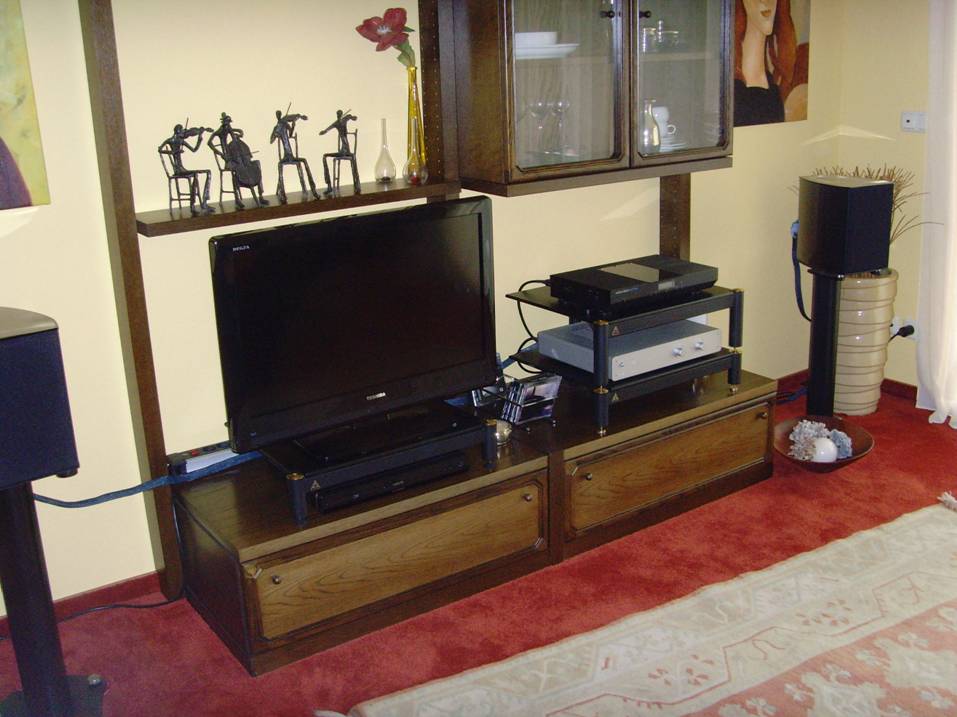

I am currently listening to "my DXAMP" (I do not know how to post a picture in here - maybe Carlos will post a picture I sent him):
"My DXAMP rocks" .
Beautifully, it has the sound and nature I love!
Smooth, natural, warm, with a kicking bass and no harshness at the heights, big and deep stage: this is how an AMP should sound in my ears.
Thank you very much, Carlos - Rudi_Ratlos
"My DXAMP rocks" .

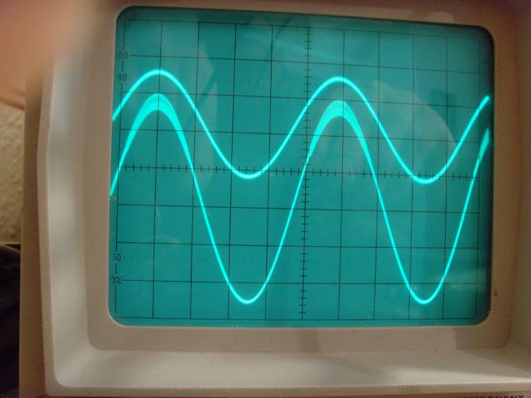

They have found 1 Megahertz oscilation superimposed into the positive cicle
I think a capacitor was missed..the 2N2 capacitor is there to take care of the long tail..it is in between the off set trimpot and the 4K7 long tail resistance.
Maybe was that the trouble..but what matter is that sounded fine, no harshing , no troubles.
Easy to adjust and worked first moment.
