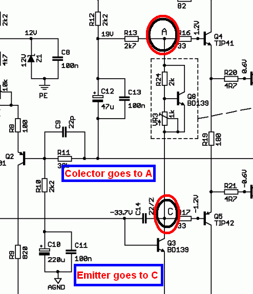

Colector goes to point "A" and Emitter goes to point "C"
Take a look at the schematic...it is all there.
Are you sure you gonna build Norazmi?... it looks you are not too much skilled, as seems to me that you're having problems with some basic things, alike to watch and understand a schematic.
I wish you good luck..but i am afraid you gonna face some problems..well... we have to start with something to produce some smoke.... put a fire extinguisher near you as a safety procedure.
I am glad you have selected my amplifier to start to do those things..but at same time, i am feeling pitty about this amplifier destiny.

Re: Colector goes to point "A" and Emitter goes to point "C"
Hi DX,
Thanks, Nah... Dont worry DX, trust me. Aha, u guess same point as you show now, and now i`m much confident, look... so thats why i`m asking to make sure before i make myself like pro, so better i`m asking you DX, its ok sometimes i`m looks like hehehe btw because of outside the board then i must be careful and the better thing is ask the owner of the board.
OK.... i`ll put anything LOL near me . Include bullet proof thing
Wish me with luck, i`m sure i`ll build this baby.
can i have 50W rms with 35 0 -35 Vdc at 5 Amp by using 2SA1302 (pnp) and 2SC3281(npn).

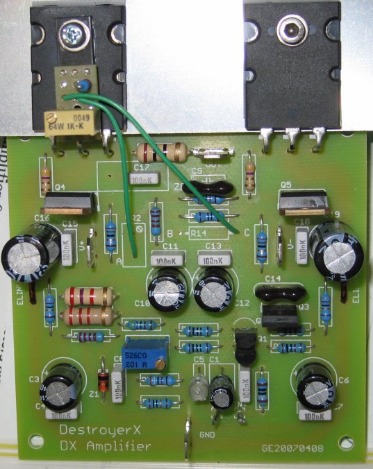

Here's a picture I took a few minutes ago. I noticed the ones I have posted on Carlos's web site is of the orginal DX before Carlos decided to use the Vbias circuit. It shows the actual Vbias in place on my DX amplifier. Works well.
regards
Greg

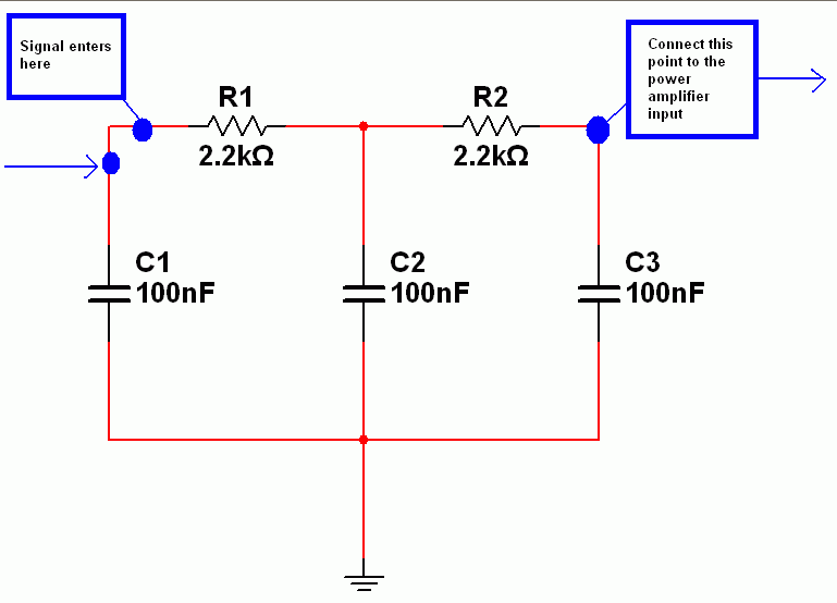

It was made to reproduce full audio range
of course you can, but you will have to provide an active or passive crossover to use it.
I have not tested..but here you have a suggestion to try..this will work into all amplifiers, not only Dx Amplifiers...this filter (send to ground) high frequencies and also some mid range frequencies (voices)
I think you may waste a very good quality amplifier (DHR Turbo) to reproduce only basses....but..... this is up to you.
Circuit UNtested!
regards,
Carlos

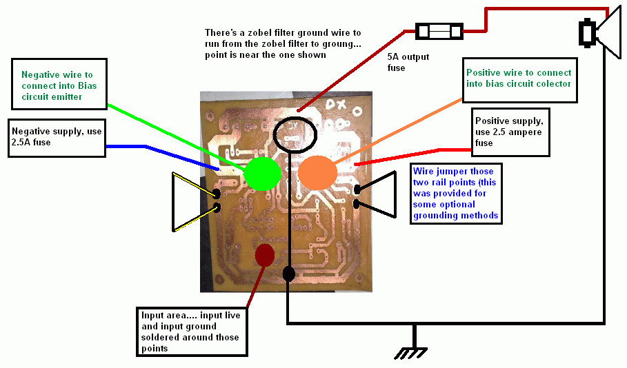

Here is the board DX
Hi Dx,
Today i`ve finish manual etch the board, sorry little late making it because i`m working. today i`ve spend time to making DX amp.
here is below, i`ll put all components today and test this baby.
Please check if i`ve any error on the board layout.
Best Regards
Azmi.

Picture not good enougth to search for errors.
regards,
Carlos
To allow me to help you, send me 6 Megabytes crispy focus image, without ligth reflections and without angle (perfect 90 degrées up vision, alike aircraft pictures).... picture must use macro function, a very good digital camera with at least 9 Megabytes with perfect exposure..unless i will not be able to help because image turns almost invisible to debugging.
The image must fill the frame entirelly not to loose pixels... no margins or frames around...only board into the image!...cannot shake hands, use a tripot and some ligth... avoid electronic flash...cannot switch it off?..them cover it with black adhesive tape.
