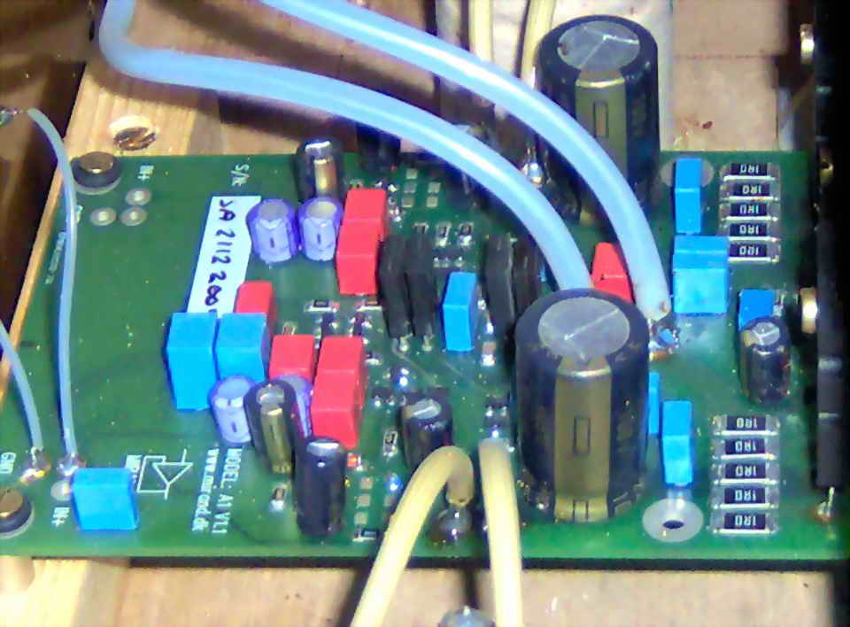

Yes Carlos, I agrree - and you would think, like others, too much, overdone, cant sound very good - but it really does sound very good
Actually Sonny changed boards with Hugh(Aksa), but we never heard more of this
But it is VERY complicated with lots of sms and fragile 4-layer board - I would think he never sold much and all delivered as assembled boards, in hand
At some time he tried to get them machine assembled, but maybe a bit expencive with big orders
I have talked with him some time ago, and he said he would tell when ready again - and nothing has happened since
Talk of being an enemy of your own skills, or whatever
My hope was maybe that you could find some small but important hidden secrets, but I guess its not that simple either
Carlos, may I ask... is those small paralel 100n caps really absolutely important - you see, like you I like it simple, which means only one single component in each place - and preferably no coil nor RC on output.... I know Sonny has done this limiting elsewhere somehow - but I know we live in real world

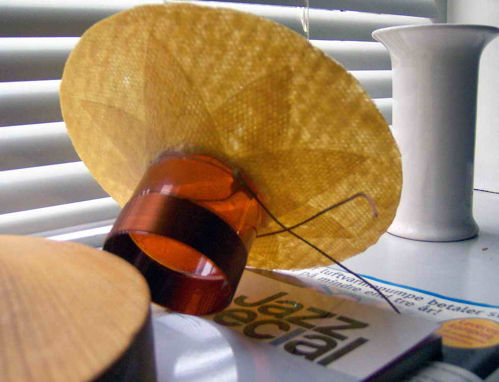

Well folks...i have discovered a hidden researcher...a scientist, humble and silent
Creating new ways to construct speaker and constructing amplifiers with pretty wood finishment...acabamento...details.....pretty amplifiers.
Tinitus is the man.... will turn this thread more rich that it was before his appearance.
Take a look in his image...no..no...no...not the image quality...not the pixels and megapixels and focus...watch the ligth, the dark in corntrast with ligth..see the image ballance...imagine as a ship..this one will not sink..weigth is ballanced both sides...image composition...an artist between us
Wilkommen Tinitus.
BTW, his name is Lars.

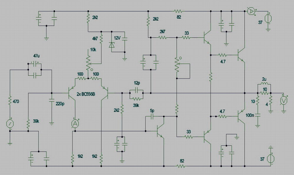

Honorable Doktor Graham Maynard simulated this amplifier...ahahahah.
Was APROVED!...by Graham Maynard...yessssss!...i am happy with that, because my respect related this man.
He told that i could remove the output inductor, that i can listen a better effect around 12 Kilohertz....listening to FM interstation hiss.
Also i have checked and i perceive that listening...nothing happenes when i have removed my rails 104 capacitors...hehe.
Better not to construct my amplifier...it is loosing fat... i am removing so many parts that maybe will finish with the input plug...and concluding that my headphone output sound the same...following the philosophie to remove excesses...than whole amplifier can be removed..ahahahahah!
I did not made Graham suggestion testings...but for sure it will work...i will remove if i perceive increasing in quality...or even in level, in this case in the upper audible spectrum.
He told me:
- "you will kick to outside earth that small transistor sound you have, just removing that coil you have in the output"
"small transistor sound" means that already remains that transistorized sound...the problem following Graham or Hugh Dean is that the amplifier will finish the same as they have designed..with their own faces printed on the board...aahhahaha..this will not be so good to mine proper own design!
regards,
Carlos

Graham told that simulating graphics were pretty clean, showing very good qualities.
Well..i have made those simulations by myself...and they appeared almost perfect...very low distortion, very flat amplifier.
I could not believe that...and i have asked Graham to check.
It is not a very good sounding amplifier..it can make Instrumentor Watcher Audiophiles happy too.
hehe...this is nice..that's why many boering bricks did not appeared here till today...ahahahaha.
I had not that visit:
- "why are you telling that your amplifier sounds good when it was distorting 0.5213456789 when reproducing 80 Kilohertz?"
- " I could see some ringing in the twenty sixth harmonic!"
- "your standards of quality are too low..your amplifier has not holes to screws."
Bat defenders!...not to disturb bat and other small animals...rats and others that can listen 80 Kilohertz!...hehe
regards,
Carlos

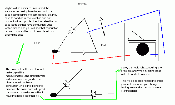

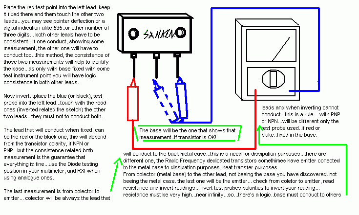

I have Sanken 2SC2922-2SA1216 and BD139-140
They are from broken amps - can I test them with a multimeter ???
I have always build kits, so to hopefully learn a little more my plan is to hardwire on a plate
To me it would give more sense to follow schematic, rather than wire accordingly to printlayout
I guess I am be able to find some factory information to tell me how to place base-collector-emitter
I may look like a fool, but if you could show correct schematic marked with letters fore transistor leg configuration
Another easier way is to understand transistor as having two diodes
connected this way inside.... if diodes are good...the measurement is very obvious.
Transistors can be opened related conduction, can be shorted, having short circuit between leads...also can show a reduced resistance..called leakage.
As in one condition the measurement will show low resistance..in the digital one will show three digits...500 or much more...and inverting you will measure infinite resistance.. measurement of resistance not possible....incredible high....tenths of Megaohms.
Of course, damaged transistor will show some resistance....but the more common is dead short between leads.
regards,
Carlos

Hi Carlos,
You know I have followed this thread, and I have e-mailed that your's is likely to be a good sounding amplifier, especially if the choke is removed, my reason for saying this being that output stage damping of loudspeaker system back-EMF is then quite phase linear at all frequencies.
Also there is not so much gain in this circuit that problems can arise relating to a need for stabilisation components which might then reduce the open loop bandwidth - which can alter reproduction when the loop is closed and louspeakers generate back-EMF.
The use of resistors around the differential stage keep the open loop response reasonably flat and well controlled, whereas with other CCS and mirror circuits etc, where gain is optimised to maximise NFB and thus minimise THD, necessary stabilising components often compromise the open loop gain bandwith with the result that reproduction suffers.
You ears have heard the proof, and yet others might still crave low thd figures, but to what end ?
I thank you for the amusement within this thread, for it has has been a fun read.

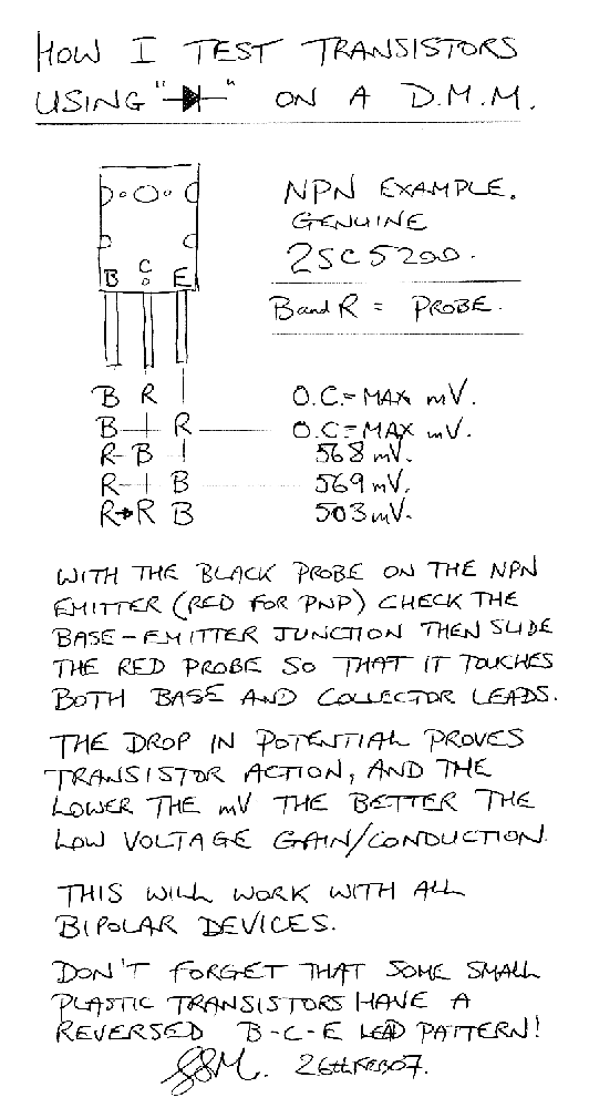

Hi Tinitus,
I'm sure Carlos won't mind me chipping in here.
I have used this base+collector method of testing bipolar transistors for decades, and it is possible to get a close match of small signal transistors for low voltage applications by doing so.
See attachment.
