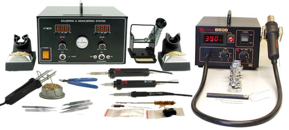

I use this solder desolder work station and hot air station. Sometimes I used them all in order to pull out some parts. Hot Tweezers are really good for SMD caps and resistors. These stations are still sold at $ 300 each. The first one accept hot tweezers and provide connection for hot air pencil, so that hot air station is maybe not needed. Regardless, I still use Solderwick in older to clean pads.

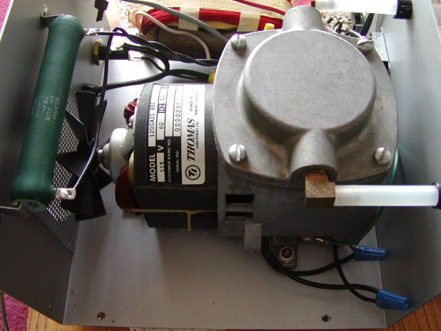

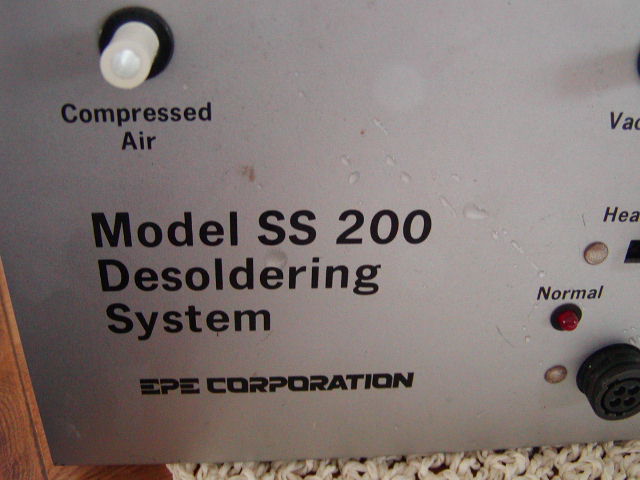

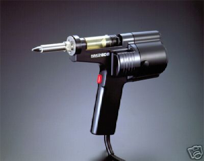

That definitely shied me away from desoldering systems for a while. then i found these old ESE/Sylvania units and man these things work great.
These things have a nice pump.

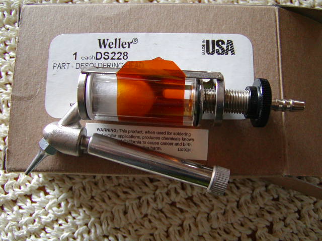

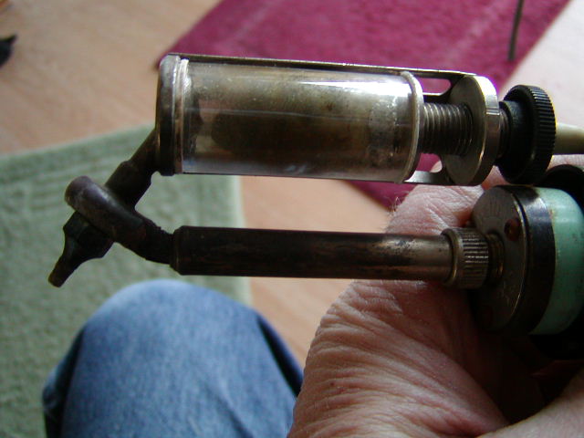

I modified mine to use a Weller TCP-1 soldering iron with a DS228
desoldering head. It works great for anything from desoldering an op amp to desoldering TO-3 case transistors.

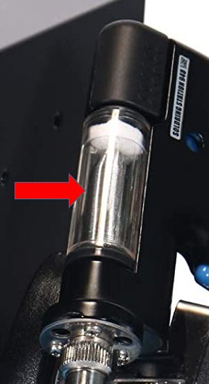

Hi ! sorry if i take up again this old but extremely interesting thread.
I am using this one
https://www.amazon.com/YIHUA-Desoldering-Variable-Temperature-Function/dp/B08BK69H2M/ref=sr_1_1?crid=99DXV1AMZRJP&dchild=1&keywords=yihua+948+desoldering+station&qid=1607701292&sprefix=yihua+948%2Caps%2C276&sr=8-1
I have opened it and it seems well built considering the price
Main problems:
1) the tip tends to get clogged
2) more serious the element inside the gun also tends to get clogged by the solder debris sucked inside
i have seen that other guns have just a spring to keep the filter in place instead of this cilinder ?
I wonder when i can find that spring ... i am quite sure it will get clogged much less easily
Moreover it is my impression that the cilinder makes much more resistance to the flow or air Much more.
Again the unit itself looks quite nice.
Thanks for any advice.

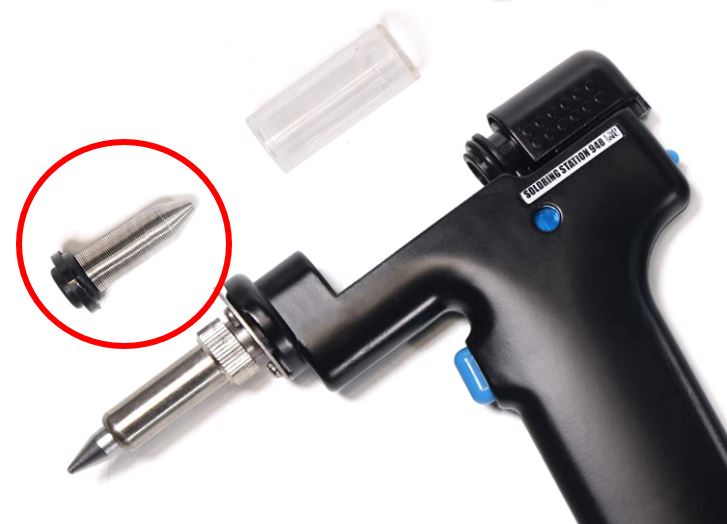

I am using this one
Main problems:

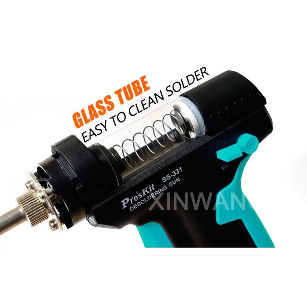

Hi ! i think i have find a solution ... i will try to make a simple spring myself with some steel wire ... winding it around a cilinder of the ID of the transparent cylinder ... i am quite optimistic that it could work just fine
Like the differente model in the attached pic
The element indicated in post 27 cloggs too easily and too frequently
For the rest a very decent unit indeed ... always considering that it is entry level
