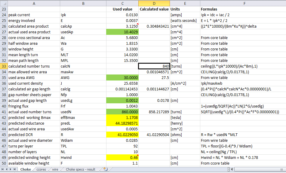

These are the formulas I found for the design of an inductor with DC, and using these the relative permeability is not needed.
N = (L*Ipk*10^4)/(Ac*Bm)
where
N = the number of turns
L = desired inductance
Ipk = peak current = Idc + Iac/2
Ac = effective core area
Bm = desired max flux density, usually 1.2T
Assuming Ac = 5.68 cm^2, Idc = 10mA, Iac = 4mA, L = 44H, and Bm = 1.2T, gives
N = 774 turns.
Next would be to evaluate the max wire size that would fit so many turns in your winding area, or window area Wa.
The wire are in cm^2 is given by
Aw <= Ku Wa / N
Ku = window utilization factor (constant), which for laminates like you have is 0.48.
Hence my question for your core Wa.
Next, calculate the gap length, in cm:
lg = (0.4*pi*N*N*Ac*0.00000001)/L
In your case lg = 0.001198 cm, which is equivalent to just butting the ends together with not paper between them, roughly. One sheet of fish paper is about 7 mils, which is about 0.01778 cm.
We should probably take into account the fringing flux
Frf = 1+(lg/SQRT(Ac))*LN(2*D/lg)
where D is the window height as seen in the image I attached previously.
Knowing F you can recalculate the number of turns:
N' = =SQRT((lg*L)/(0.4*pi*Ac*Frf*0.00000001))
There's more, I'm working on a spreadsheet too.

This is what I get for your core. This calculates one winding, assuming it occupies half the total winding area. It also assumes standard industry silicon steel core and a target working Bmax of 1.2 tesla. The method used is called the area product method (temperature rise) from the book Transformer and inductor design handbook by Col. Wm. T. McLyman.

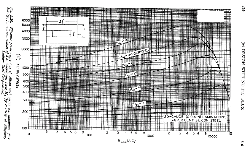

Check chapter 5 of RDH4
http://www.paleoelectronics.com/RDH4/CHAPTR05.PDF
Figure 5.20 shows how the effective permeability changes for various DC bias, for one type of core. The problem is that for most cores I have I won't have this data. If you indeed want to measure the permeability of your core, it'd be better to do it with DC bias applied.
I personally will avoid formulas using permeability because I don't intend to measure it. For me it's good enough to assume a safe Bmax somewhere between 1.0 and 1.2 tesla.

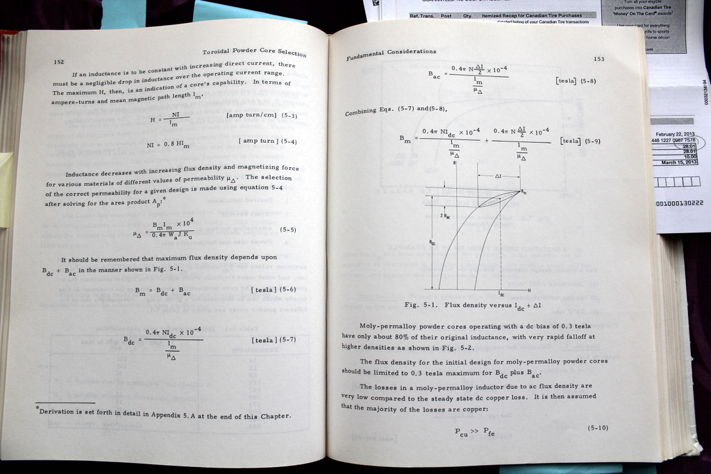

This is inconsistent with Electromagnetism, there is no magnetic field for the term Iac/2.

Sorry, I don't understand what you mean. There is DC current through the primary. This DC current flow will induce flux in the core. In the same time there is an AC current component, which, if we assume a sin wave shape, will vary between Idc - Iac/2 and Idc + Iac/2. The AC current variation produces a change in the flux. The peak current Ipk = Idc + Iac/2 will change the flux towards saturation of the material.
Surely you don't claim that AC current in the wire does not have an effect on induction.
See the attached image for an illustration. My Iac is the delta(I) in the image.
The AC current variation produces nothing, but losses in the wire.
Think a little, in a transformer, if you draw a different current, the magnetic field B(AC) remains almost unchanged, even more, major core losses occur when there is no load, so U(AC) reach a maximum, so B(AC) reach a maximum.
The confusion is that a voltage U(AC) is associated with a current I(AC), which is incorrect.
Ohm's law is in the collective unconscious, but imagine a transformer with a winding ideal conductor R = 0 ==> U = 0 ???

Here we go again, lets consider Maxwell's equations
∇ . D = 4 π ρ (1)
∇ . B = 0 (2)
∇ x E + (1/c) ∂ B / ∂ t = 0 (3)
∇ x H – (1/c) ∂ D / ∂ t = (4 π/c) J (4)
And constitutive relations
D = ε E (5)
B = μ H (6)
If the medium is homogeneous and isotropic, ε and μ are constants.
In ferromagnetic materials
B = f(H)
The curve B vs H is called the magnetic hysteresis curve.
The area within the magnetic hysteresis curve is proportional to the energy dissipated as heat in the irreversible process of magnetization and demagnetization.
From eq.(4) it follows that
B(DC) = 4 π μ N i(DC) / (9 l) (7)
Therefore, equation (5-7) in the attachment is correct.
From eq.(3)
B(AC) = U(AC) x 10^8 / (√2 π f S N) (8)
Therefore, equation (5-8) in the attachment is a joke, and eq.(5-9) is clearly incorrect.
Fig.(5-1) in the attachment is also incorrect, the author confuses ∆H with ∆Iac, and/or Iac with ∆Idc.
This can be clearly seen if we consider a transformer with a given nucleus which corresponds to it a certain magnetic hysteresis curve.
If, eg. apply a voltage U(AC) in the primary, we have a magnetic field given by (8), regardless of the current i(AC).
Even more, as has been mentioned, is a consequence of Maxwell's equations, that the greater area inside the magnetic hysteresis curve occurs when there is no load, so i(AC) reach a minimum, in open contradiction with fig.(5-1)
This is also a fact observable and measurable.
Take a power transformer and do the experiment, and do not believe everything the books say. 😉
