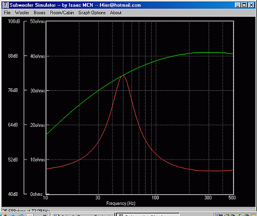

This is just a little 6.5" Peerless 833599 speaker in a 36 liter seled box.
The red line is the impedance. As you can see, there is a region of high impedance near cutoff that a high impedance amp can deliver more power into, therefore boosting output at 30 Hz and 40 Hz.
Same story for a 36 liter vented box with the same Peerless 833599 woofer. High impedance in the 20 and 40 Hz region allows extra boost if the amp delivering the power has high impedance.
