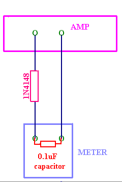

Another, simpler to many, method is to avoid using the meter's own rectifier.
A simple rectifier can be made using a small signal diode and capacitor, Eg 1N4148 and 0.1uF. Put the diode in series with one probe, and the cap across the meter. It doesn't matter which way, but the reading may indicate a negative voltage.
The voltage read will be the "peak". To calculate the RMS value, multiply by 0.707. This rectifier configuration will not work at small signal levels, so make sure you've got a volt or so.

I think this is the setup John, (Dhaen) was referring to. Of course, you can put the diode at the end of the probe, and hook it up to the amp.
All this stuff is available for really cheap at any Radio Shack for a couple of bucks. Since this is AC, I don't believe it makes too much difference which end of the diode hooks up to which-but you can switch it if you want.

As you can see, this setup is quick and easy to do.

The 0.1uF value assumes that the meter has a high input impedance 1M -10M ohms, (as all digital meters I've come across do). If you find a fall-off at the LF end, just increase the cap value.

Just note the circuit as shown by KC will under-read by
0.6 V and will not register anything below this voltage.

So if he uses the illustrated setup and his meter reads 2.0 V, it really is 2.6V? That is good to know. :)
Maybe it would be good just to record the readings straight off the meter, then we can add the extra voltage when figuring the slope. That is, if he decides to use the setup at all.
He might just decide to compare the AC meter readings with the illustrated setup's readings at 30 Hz and 400 Hz, correct for the .6V, and if they check, that is that.
