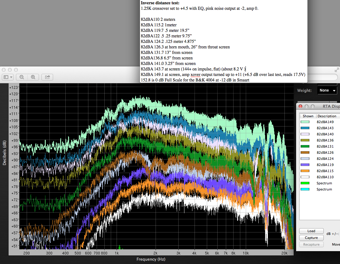

The inverse distance drop starts at the driver diaphragm itself and continues throughout the horn.Going back to pages 23 and 24, there was some speculation on how low the BMS mid range could go. The long answer seems to also be 300hz.

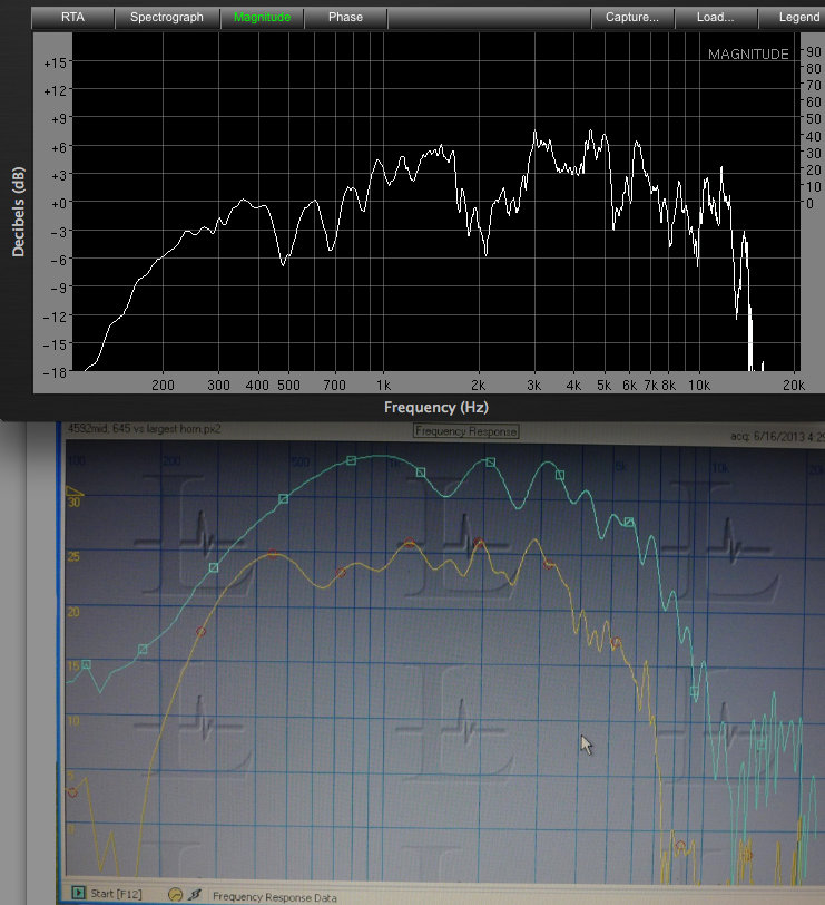

Here is a screen shot of two different horns with the BMS 4592 on them. One is a DDS horn, about 22"x22" in size. The other is a much larger horn, about 48" x 33", and about 5' long. (56cm x 56cm, and 122cm x 84cm x 153cm) The smaller horn is limited by its size, but the much larger horn shows the lower limits of the mid driver. Which is right at 300hz.
I am not sure why of the differences in sensitivity. I am wondering if it is mostly distance. As in, the larger horn, the mic is over one meter further from the driver. I would think that the volume would start dropping as the distance gets further from the horn mouth, not from the driver mouth. There is also the possibility that something else such as amp volume changed from one test to the other.
If you took measurements 1/2 meter and at the horn mouth, then inside the horn you will notice SPL will continue to increase at roughly 6 dB each halving of distance.
Horn low frequency cut off and sensitivity is a function of flare rate and other design features, I'd expect the 4592 could go lower than 300 Hz on some horns.
As an example, the response of an EVDH1AMT (3" diaphragm driver) on a 22.5" x 11.25" x (approximately) 17" deep horn is shown.
In spite of being a fraction of the size of either of the horns you tested, the LF cut off of this horn (a WS Paraline) is much lower, around 200 Hz compared to 300 and 500 Hz for your larger horns.
Art

For me to opine on what you are interpreting I'd have to see measurements of what you are interpreting .
I have only tested "inside" of one horn, my conical 13 x 13 degree Maltese horn.
http://www.diyaudio.com/forums/multi-way/212240-high-frequency-compression-driver-evaluation.html
My inverse distance test on that horn shows more LF the closer to the throat measured, which seems opposite of what you are writing.
Also, there is a "bubble" of sound surrounding the mouth of a horn, within which the inverse distance law does not work as expected, while within the horn it appears to work normally again.
Art

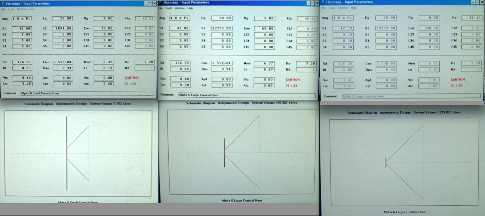

If all four sides are "straight sided" the horn has a conical expansion.
Counter intuitive (to me), a one foot long conical horn has the same cutoff as a 5 foot conical horn.
Earl Geddes (repeatedly) pointed this out to me recently, until I actually ran some simulations myself, I had a hard time believing it, and admitting I was wrong in stating otherwise.
Pattern control does extend lower with a larger conical horn, but the LF corner is not extended.
The conical Synergy horns "cheat" the LF corner with multiple drivers tapping in to different points of a conical horn, allowing a lower cut off than the sidewall angles would otherwise indicate.
A rapidly flaring exponential horn can go lower in a much smaller package than a conical horn, but will not have constant directivity as a conical horn does.

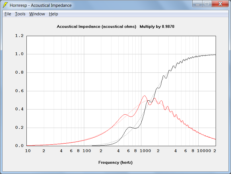

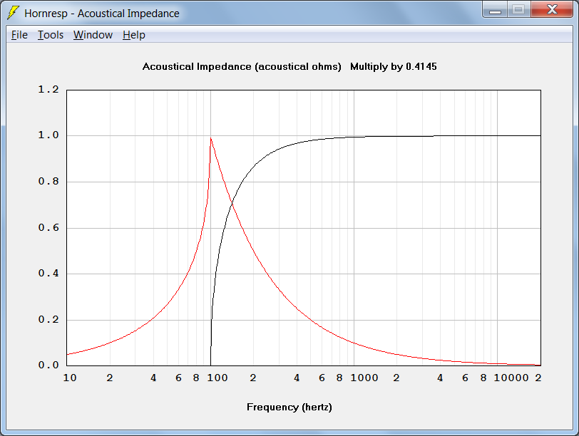

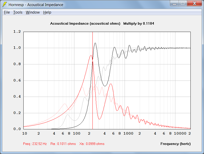

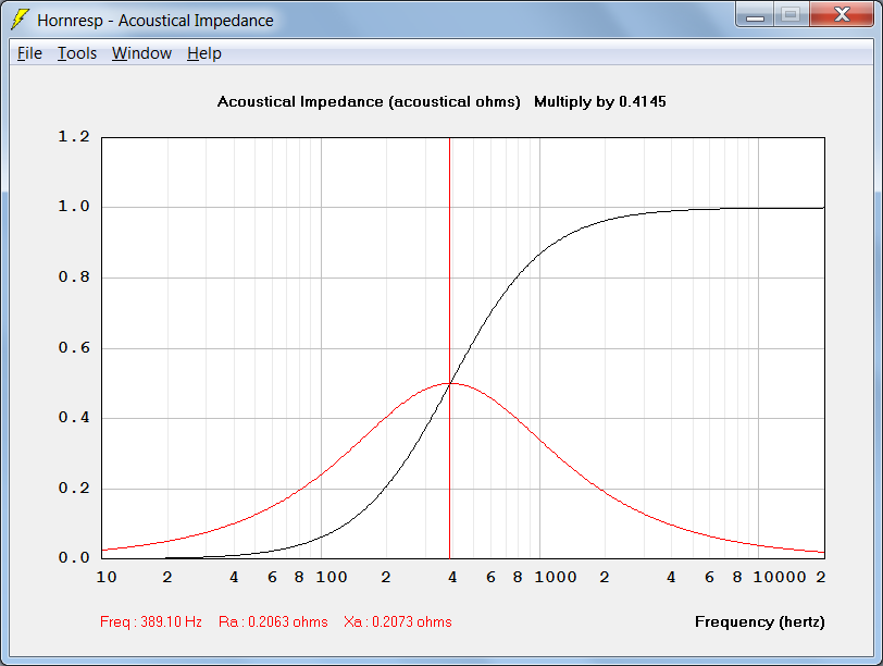

Hi Art,
How are you defining cutoff?
The attached screenprint compares the power responses of two conical horns:
Horn 1
S1 = 350
S2 = 20000
L12 = 150
Fta = 24.78
Horn 2
S1 = 350
S2 = 1871.03
L12 = 30
Fta = 24.78
The horn axial lengths are different but the throat areas and conical flare tangent angles are the same. It seems to me that the longer horn (light-grey SPL trace) has the better bass extension, and therefore a lower 'cutoff'.
Kind regards,
David

David,Hi Art,
Horn 1
S1 = 350
S2 = 20000
L12 = 150
Fta = 24.78
Horn 2
S1 = 350
S2 = 1871.03
L12 = 30
Fta = 24.78

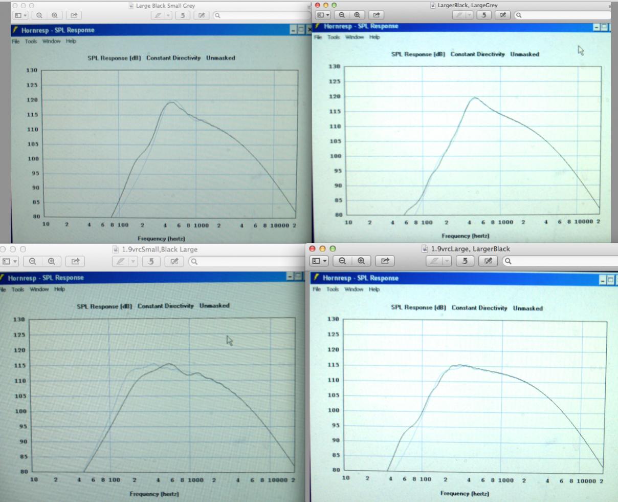

I define cutoff as the corner point where the low frequency response of a horn starts to rapidly drop.
Earl Geddes wrote in post #5974 of this thread:
http://www.diyaudio.com/forums/multi-way/103872-geddes-waveguides-599.html
"I objected to the statement (made by weltersys in post 5966) "A larger diameter round conical horn with more mouth area has a lower cutoff frequency than a smaller horn." It was incorrect when it was stated and its still incorrect. I don't understand why everyone keeps wanting to change the discussion - maybe to avoid having to admit that this statement is wrong?"
After doing some sims in Hornresp to prove my statement correct, found I was wrong, and posted my retraction in Post #5984.
Not able to find published T.S. parameters for any compression drivers, used a familiar driver found to be useful in horn mid designs, the Eminence Alpha 6, which has a lower Fs (and far more Xmax) than the BMS 4590 or 4592 being discussed here, or the B&C HF drivers Earl tends to use.
I had used a very small VRC (compression chamber volume) volume which restricts driver excursion and LF output, but causes a rising response above cutoff. With the small back chamber, changing horn size (with sidewall angle the same) makes virtually no difference.
Today I tried increasing the VRC from .4 liter to 1.4 liter to allow the driver to reach it's 3.5mm Xmax at 100 watts, which lowers the cutoff frequency by around an octave.
The upper SPL charts show the .4 VRC, (perhaps similar to the small compression chambers used by most mid/high compression drivers) the lower show the 1.9 rear chamber volume optimized for the Alpha 6.
The enormous differences in the horn size required for minimal changes in the LF cutoff are rather striking.
The "small" horn at 15 cm deep(about 6 inches) LF corner is 112 dB at 265 Hz, F3 of 109 dB is at 210 Hz.
Quadrupling the length, and with 38 times the volume, the "large" horn results in a LF corner of 113 dB at 190 Hz, F3 of 110 dB is at 152 Hz, a bit over one third octave lower response than the "small" horn.
The "larger" horn is truly a monster with a mouth of 99999 square centimeters, (107 square feet) the largest input available in Hornresp. This mouth size was still not large enough to maintain the 45.1 angle used by the other horns with 180 cm (5.9 feet) of length.
Even so, it had a higher LF corner than the large horn, with 115 dB at 230 Hz, F3 of 112 dB at 180 Hz, less than 1/3 octave lower than the small horn, although it occupies 856 times the volume.
Perhaps you can explain why your examples results are so different than mine, and explain to Earl Geddes why he's wrong .
Art
Hi Art,
Thanks for the comprehensive response, and for explaining what you mean by the cutoff of a conical horn.
I sought your clarification on this matter because strictly speaking, a conical horn does not have a theoretical cutoff frequency in the same way that an exponential horn does.
This can be illustrated by comparing the throat acoustical impedance of an infinite exponential horn (attachment 1) to that of an infinite conical horn (attachment 2).
The throat resistance of an infinite exponential horn is zero below a cutoff frequency given by fc = m * c / (4 * Pi) where m = ln (S2 /S1) / L12. For frequencies lower than fc, no power is transmitted down the horn, and the impedance at all positions along the path is purely reactive. For the example given in attachment 1, the cutoff frequency is 100 Hz.
Traditionally a conical horn has been considered not to have a specific cutoff frequency, but I notice that the new Beranek & Mellow 'Acoustics' book published in 2012 defines the cutoff frequency of an infinite conical horn as fc = c / (2 * Pi * x1) where x1 is the distance from the cone apex to the horn throat. This is the frequency at which the throat acoustical resistance equals the throat acoustical reactance. For the example given in attachment 2, the cutoff frequency becomes 391 Hz.
The reason why our results are different can best be seen by examining at the throat acoustical impedances of the various horns.
Attachment 3 compares your 'small' and 'larger' horns. Notice how the results are quite similar.
Attachment 4 compares the two finite conical horns I used as examples in my previous post. Notice how the results vary considerably, even though the theoretical cutoff points (as defined by Beranek and Mellow) are the same for both horns.
Earl is correct in that theoretical cutoff frequencies are influenced by horn flare rate rather than horn length or mouth area. However, the practical power response cutoff can be significantly affected by horn length and mouth size, as demonstrated in my previous post.
In my view, therefore, you are both correct - based on your different interpretations of cutoff .
Kind regards,
David
