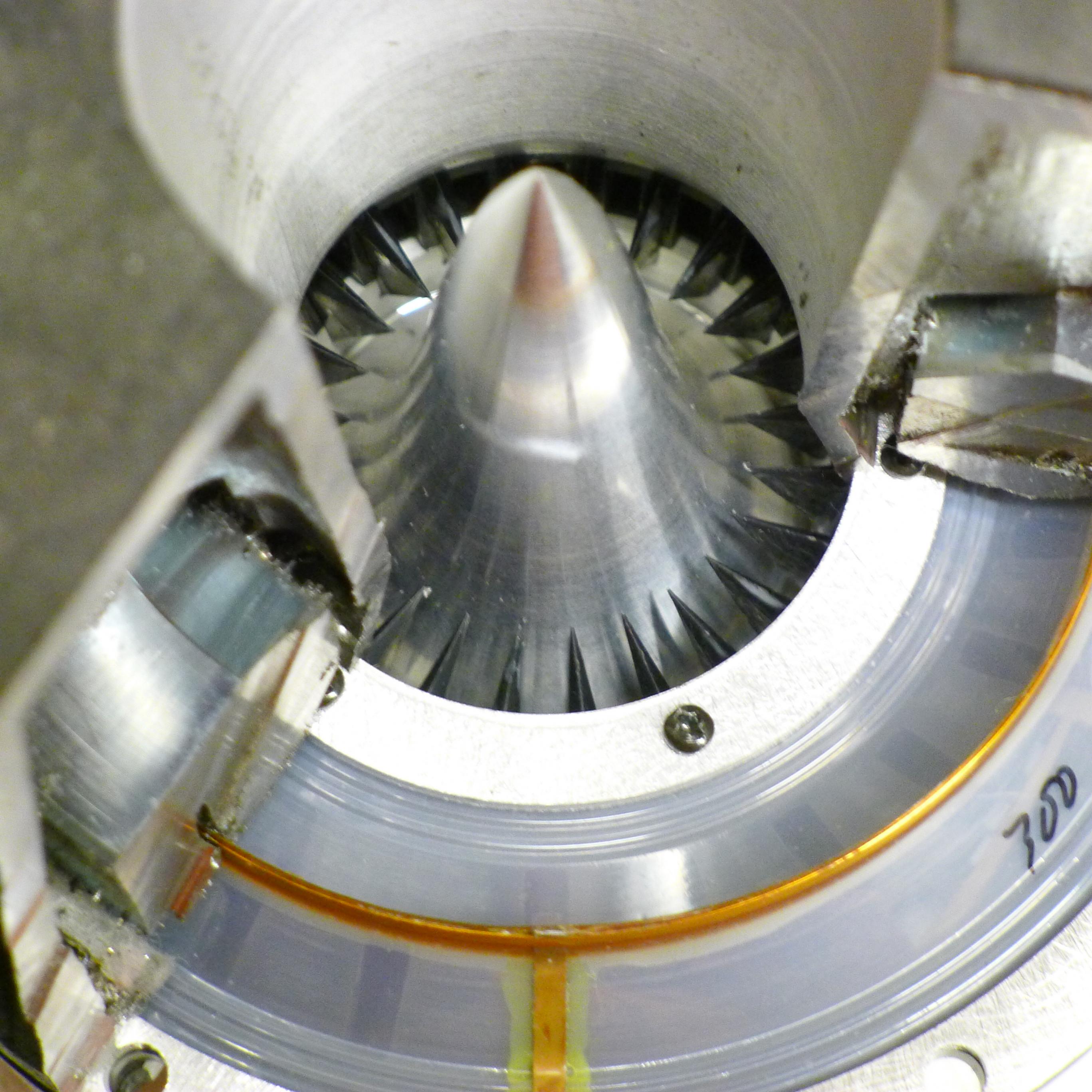

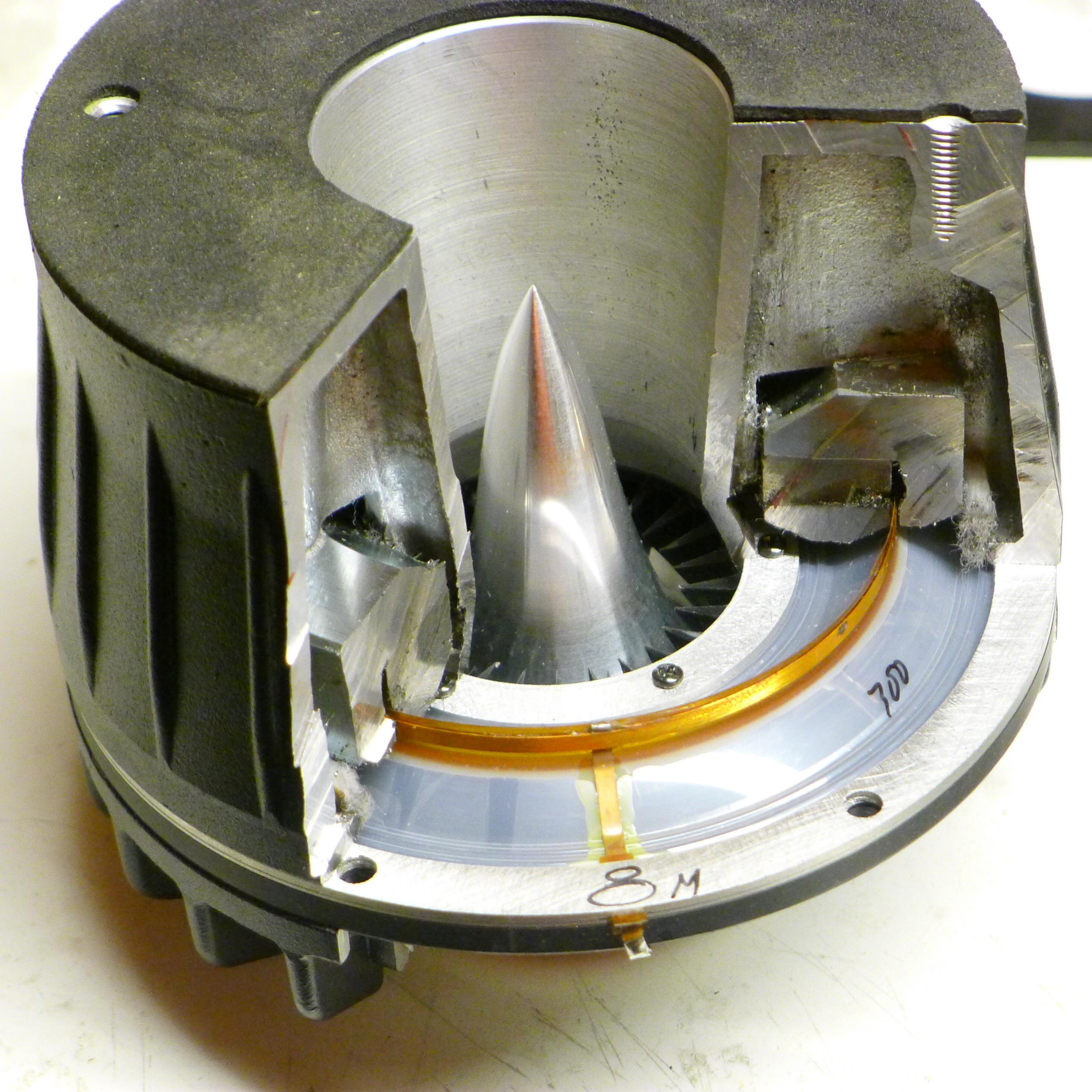

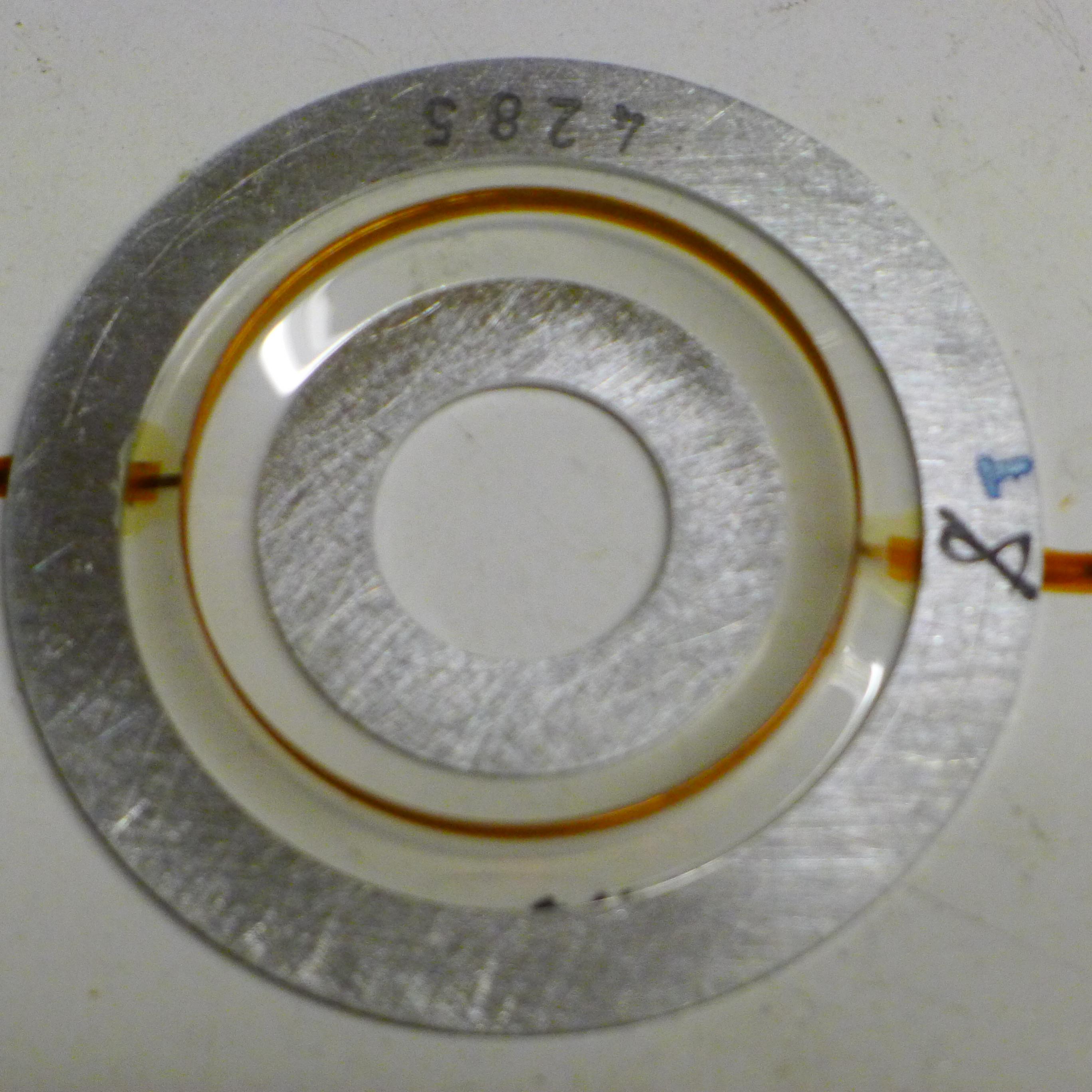

The BMS 4590 is a dual concentric compression driver. It has a mid and high diaphragm. 3.5" VC for the mids, and 1.75" VC for the highs. 500hz to 6,3 on the mids, and 6,3 on up on the highs.

Hi Kindhorman, The driver has two voice coils too. It's justdrivers in one, with a common 2in output:

The sound from the mid diaphragm goes off the back side of the diaphragm and goes through slots that are behind it. The sound goes through tubes, and into the center, where you can see the tubes terminate as fins where they meet the pole piece. In the photo that is more straight on, you can see the ring in the very back behind the fins for the mid range tubes. That is the exit for the HF, the sound from this diaphragm merges with the sound from the MF diaphragm near the pole piece where the slots meet the pole piece. The HF diaphragm is set back slightly, so that the HF and MF are time aligned.
