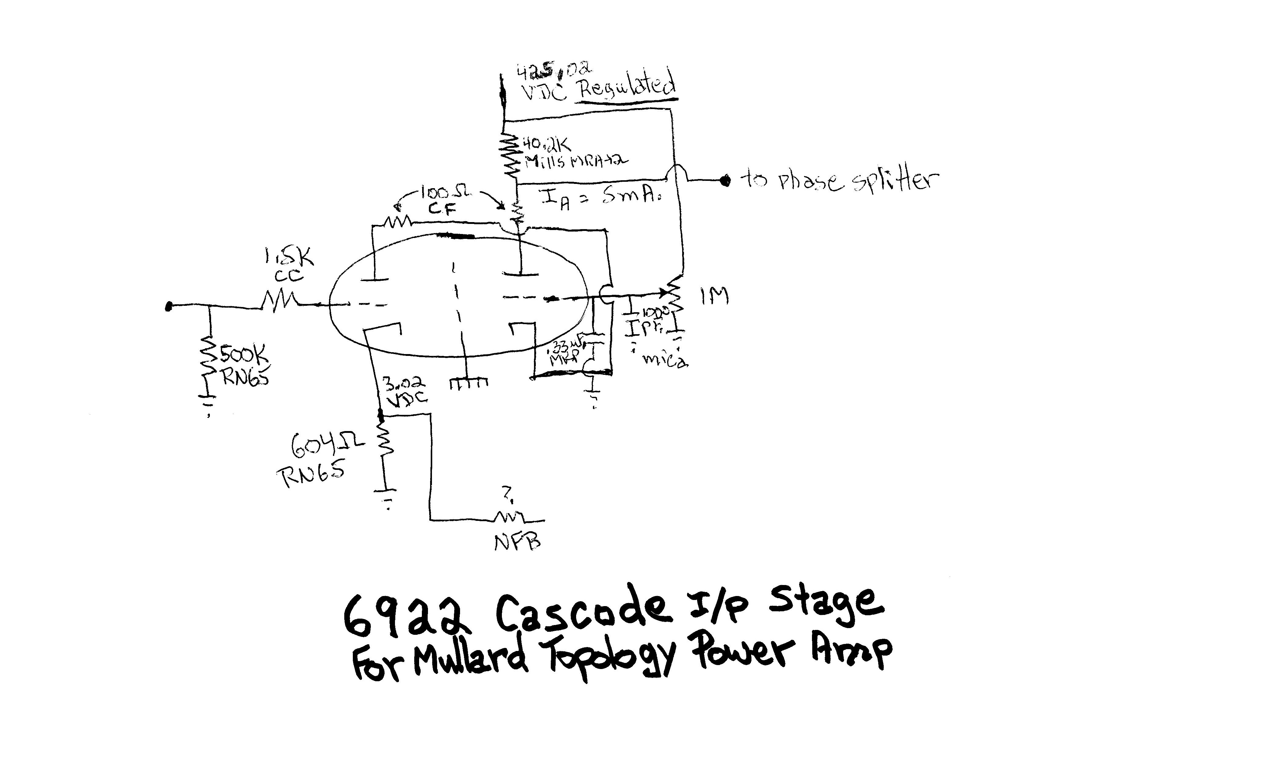

Carefully peeping in so as not to disturb - but where did you upload the 6922 cascode? Cannot find it in this thread; elsewhere or must I go wash my eyes out?

An added refinement, for better parasitic oscillation suppression, is to cement a tiny ferrite bead to the socket surrounding the "upper" triode's grid lug. The bead should not make contact with any socket lug.
The "upper" triode's grid in a cascode is supposed to be at AC ground. Therefore, I eschew a resistive stopper.

Using the cascode presents another regulation challenge. Fortunately, a little TO92 case LR8 3 terminal regulator in each monoblock disposes of the issue. Power supply rejection ratio (PSRR) is abysmally poor in cascodes. Therefore, cascode B+ must be regulated.

"Once more, into the breech!" ;)

I can find no reference for 7503. :( Perhaps you mean 7308/E188CC.

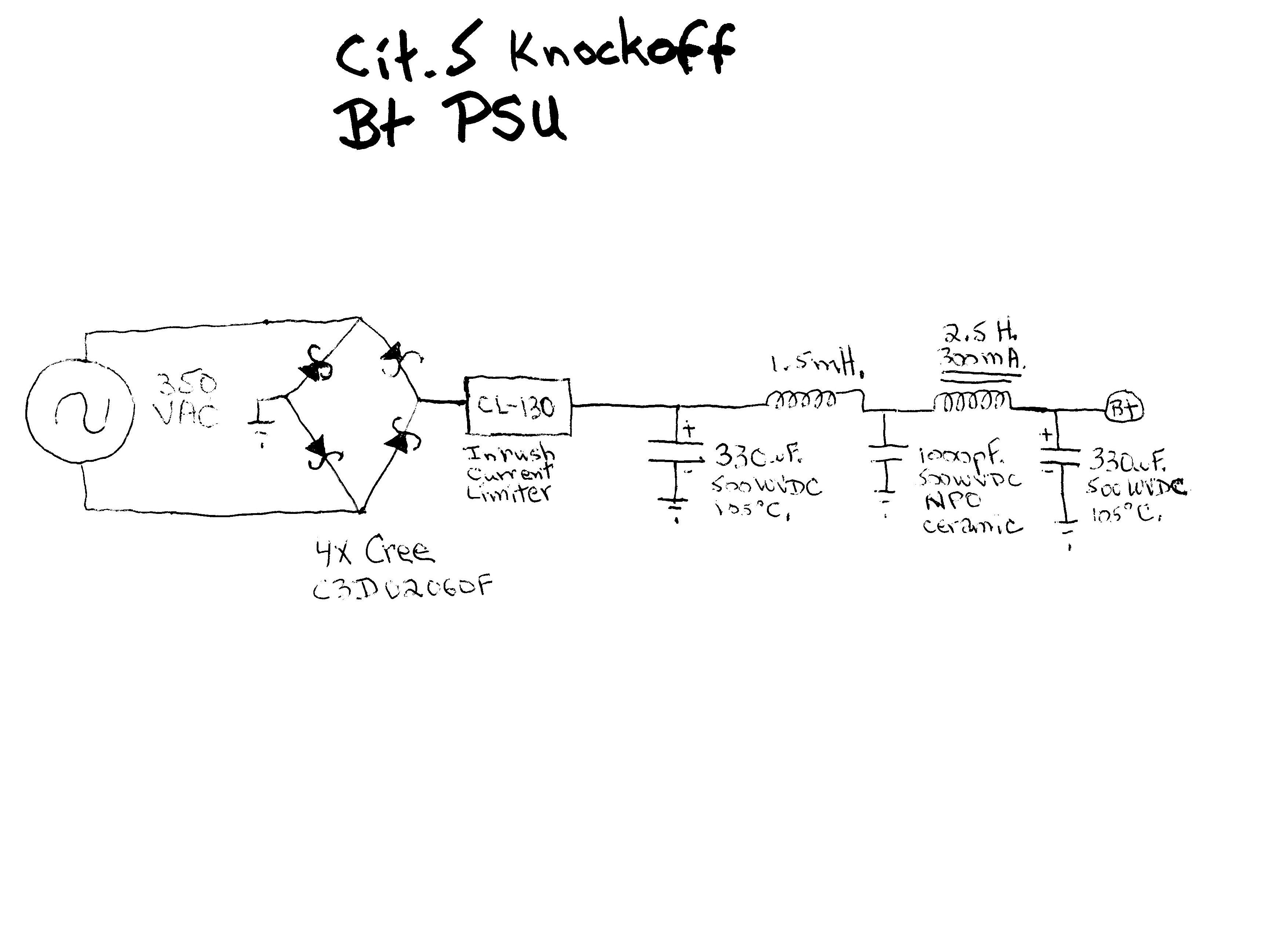

The capacitor after the CL-130 might be a bit large for it. The data sheet recommends 145uF max when the supply is 240 vac. Maybe the CL-180 would be better. C max = 400uF at 240vac.
http://www.farnell.com/datasheets/85914.pdf
On the other hand, it might be fine. I don't have direct experience with these devices.
Also, the middle capacitor looks a bit too small to really be useful. I'm not sure what your intention is with this value.

You have to look at the max. current allowed through NTC thermistors, in this situation. It's highly likely, in this case, for the device to run relatively cool and continue to introduce some resistance, in the "steady state". While the B+ rise delay introduced by the thermistor is small, it's enough to allow a SS rectified bias (C-) supply to turn on, fully.
The 1.5 mH. RFC and the 1000 pF. cap. comprise a "hash" filter. The "hash" filter suppresses HF noise riding on the B+ rail, regardless of said noise's origin. Such HF noise could sneak into the reservoir cap., via the main filter choke's winding capacitance. A more "black" background is the result of installing a "hash" filter.
BTW, large valued cap. I/P filters are inherent "hash" generators. Look at the ripple current waveform and apply Fourier's Theorem.
@Eli, you posted a "new" scheme to my eyes, will try it in my next build.....in my case, will usually start with smaller cap as first cap and then make the last cap the biggest...
Don't use a large valued cap. at the I/P of a CLC filter, when the power trafo is not "hefty". Trying to pull more than 50% of the rectifier winding's rated RMS current is asking for big trouble. The bigger that 1st cap. gets, the worse I2R heating in the rectifier winding becomes. Also, the bigger that 1st cap. gets, employing a "hash" filter becomes ever more important.

The 12BY7 the Cit. 5 employs as its voltage amplifier is out of production and, IMO, the available stock should be reserved for amps already in existence. That fact set is really a non-issue as I've uploaded a 6922 cascode voltage amplifier schematic that's specifically intended to dispose of the matter. :D
