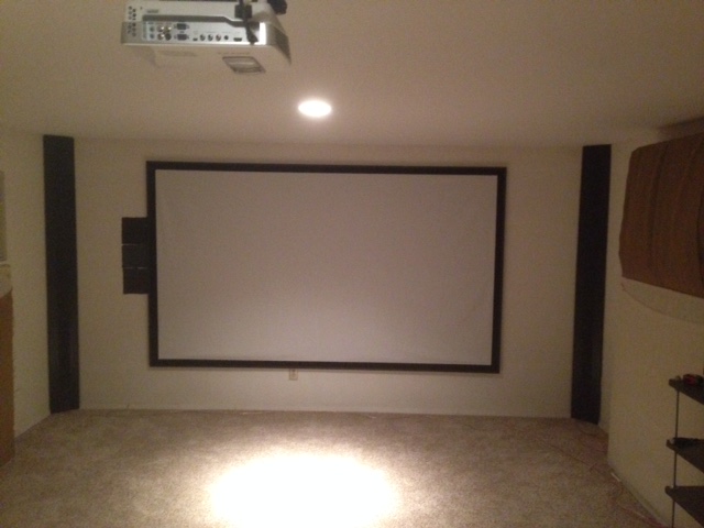

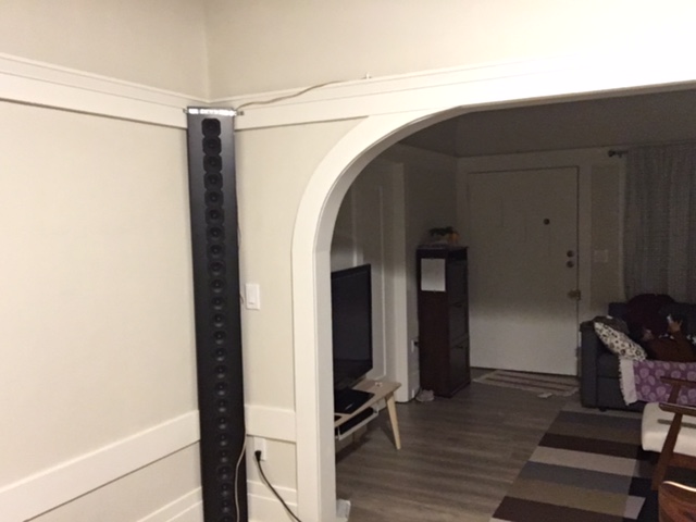

I've had corner floor-to-ceiling line arrays for a while and my experience has been different. They were in a relatively large basement (it was a fantastic man cave, which I unfortunately no longer have the pleasure of owning--picture 1), about 14 feet apart, and my listening position was about 2/3 in the back of the room about 16-17 feet away. The whole reason I chose to go down the "corner floor-to-ceiling line array" path is because I wanted to eliminate the front wall reflection and the floor and ceiling reflection.
There was very good soundstage depth. Closing the eyes definitely helped make the depth much more real. With the eyes open, there was depth, but the front wall sort of clouded your judgment. It was very hard to get past what your eyes saw. I've also listened to one of Pano's VOTT systems, and it had even more soundstage depth, but they were placed away from the front wall.
I moved to a new, much smaller house. I've setup the line arrays in corners adjacent to arches that separate two rooms(picture 2), i.e., there is no back wall. Now, I don't have to close my eyes to be completely immersed in the soundstage--it just happens. This space is also much more reverberent and I haven't had time to add treatment yet. But I suspect the main reason for the improvement in imaging is that my eyes are now telling me there is a huge space behind the speakers.
So, the conclusion is that the eyes, they deceive. I agree with krivium that there is no right or wrong way to do this. The key is in the BBC paper, i.e., early reflections should be suppressed but the energy is preserved. There isn't any particular directivity that is preferable, but a smooth power response is important, i.e., no sudden changes in the power response. Of course, a smooth, resonance free on-axis response is THE MOST important of all.

I've had corner floor-to-ceiling line arrays for a while and my experience has been different. ... I moved to a new, much smaller house. I've setup the line arrays in corners adjacent to arches that separate two rooms(picture 2), i.e., there is no back wall. Now, I don't have to close my eyes to be completely immersed in the soundstage--it just happens. This space is also much more reverberent and I haven't had time to add treatment yet. But I suspect the main reason for the improvement in imaging is that my eyes are now telling me there is a huge space behind the speakers.
So, the conclusion is that the eyes, they deceive.'= ...
