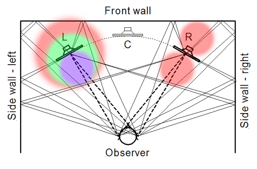

The eyes do deceive, but I've found it's not the whole story. In your new house you really do have depth and you can hear it. The visuals help, but the reality of actual depth is there and you hear it. Your fortunate to have that space. Are you getting various levels of depth?
Hey Pano! My point was that in both locations, having no front wall reflections (through the use of corner loading), the imaging is about the same, but it is just more believable in the new place because there is no wall there anymore. In the garage trick you experienced, new early reflections from a front wall were added and that will definitely cause the depth to reduce.
Yes, I do get layers of images. For example, the horns and flutes are located in the back relative to the violins in an orchestra. Even the timpani has a location and it is in the back (when well recorded, of course).
