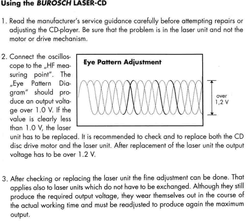

Many Denons have over-scan mechanisms that detect low reflectivity CD-R and CD-RW, and adjust laser output accordingly.
The only proper way to adjust reference laser output current is by turning the little laser pickup trim-pot clockwise to increase the laser current until the correct eye-pattern amplitude is achieved.
What many people don't understand is the fact that brand new mechanisms HAVE to be adjusted for the correct laser current once the mechanism is installed inside individual player.
99% of the time, the new mechanism is not needed. What is needed is slight laser current increase to get the transport section back within its nominal specifications. This will NOT cause any dramatic decrease in life expectancy of the laser pickup - the laser will still work just fine for another 5-10 years.
Professionally "pressed" music CD's bought in music stores have varying reflectivity. Some have really low reflectivity. Good quality CD-R copies of low reflectivity original CD's (bought in a music store) can play really well in a player with poorly adjusted laser current output.

I've attached some additional info If you want to learn more about RF adjustment. Try to obtain the Service Manual for your player to find out the exact RF amplitude value and the tolerance.
Boky

Thanks Extreme_Boky. In fact I own the service manual, but saddly not an oscilloscope, so the adjusment had to be made by test and trial. Anyway, I'm confident that the experience was useful for those not owning an oscilloscope but onwing a rebel laser pickup :)
So, summarizing, my experience matches the opinion exposed by Extreme_Boky: Once replaced, most pickups need to be trimmed in order to adjust the laser amplitude, or speaking in a practical fashion, in order to allow player to deal with CDs, CDRs and CDRWs.
Since long time ago I replaced my old pickup by one brand new I cannot check part of the opinion of Extreme_Boky: Most of pickups must not be replaced, just trimmed. So if you, dear reader, are dealing with a player not reading some (of all) CDs (famous 00:00:00 error) give a chance to the Extreme_Boky opinion, try to trim it before changing it and share your experience.
Sure: What I tried to say is that pickup WON'T work better as much as you turn the pot clockwise, ie, there's an exact pot position where pickup will work... or speaking in technical terms, laser wave must be fit to accurately get an amplitude of 1.2V, so you must fit the pot for allowing the laser getting exactly that value.
Since I didn't have the right lab device (oscilloscope) I couldn't follow the instructions that Extreme_boky attached and that are included in the service manual. So I had to trim the laser amplitude by test and trial: Unmount, slightly trim clockwise, mount, test. I followed that sequence until I got the most of my CDs being read.
Please, be extremely careful since you will have to repeat the procedure some times until you fit it and there's a possibility of damaging the device when manipulating it (that possibility multiplied by x times gets a higher value).
