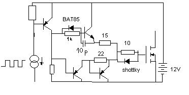

Hi Markus
Thank you for your reply, I always admired you for ability to talk about difficult issues in relatively simple words, very educational, unlike some knowledgable wiseguy posers.
I think you already have good slew values. If slew time were lower, than the actual dead time should be higher to avoid cross conduction, right?
What do you think such a discrete half bridge mosfet driver works like?
It seems to me, that it could give both high slew, resonable dead time and low conduction losses. I am just beggining to learn though.
best regards
That's Ok but I find there's redundancy in it, unless those series resistors to the gate is a pot for helping to calibrate deadtime.
Better done by moving that elsewhere, say by varying the level of collector current of the first transistor, and /or between the bases of the following two. Your turn off schottky diode is going to hold the gate source voltage up an extra diode drop in that location.
In fact you could replace the 10ohm resistor and paralleled schottky with emitter followers, and whatever snubbers required to control ringing ..slew rates.. emi
