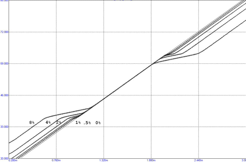

Guys, maybe i'm too late, but this is simple simulation can help figure out, how PWM linearity depends from the dead time (8,4,2,1,.5,0% of Tswitch). Easy to see, that the process haven't frequency dependance, so 100hz, 1khz or 10khz is no matter. BTW, several watts power region will have no dead time dependance also -only much more power level shows real THD, in other words, if your home cooked class D amp gave .002% at 1W, try to check it for 1/2 max power first.
