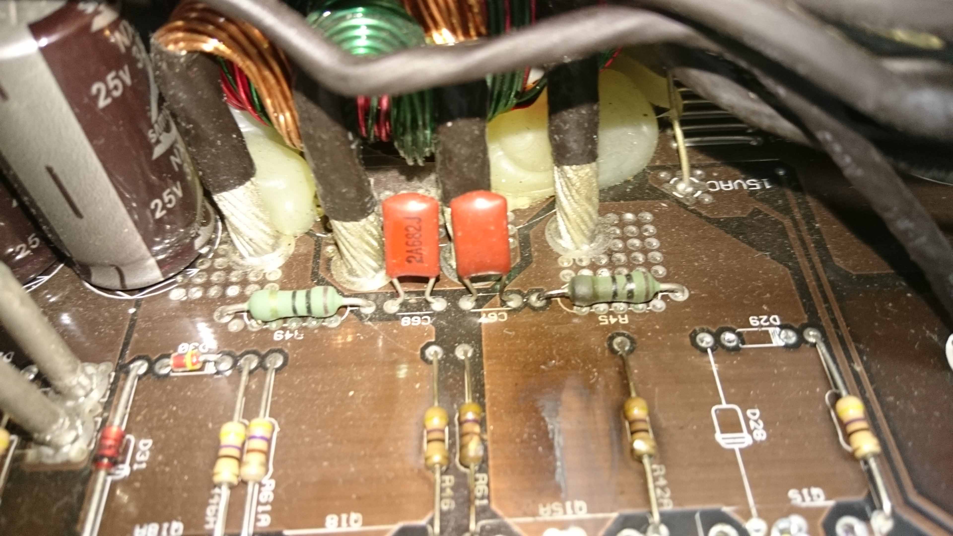

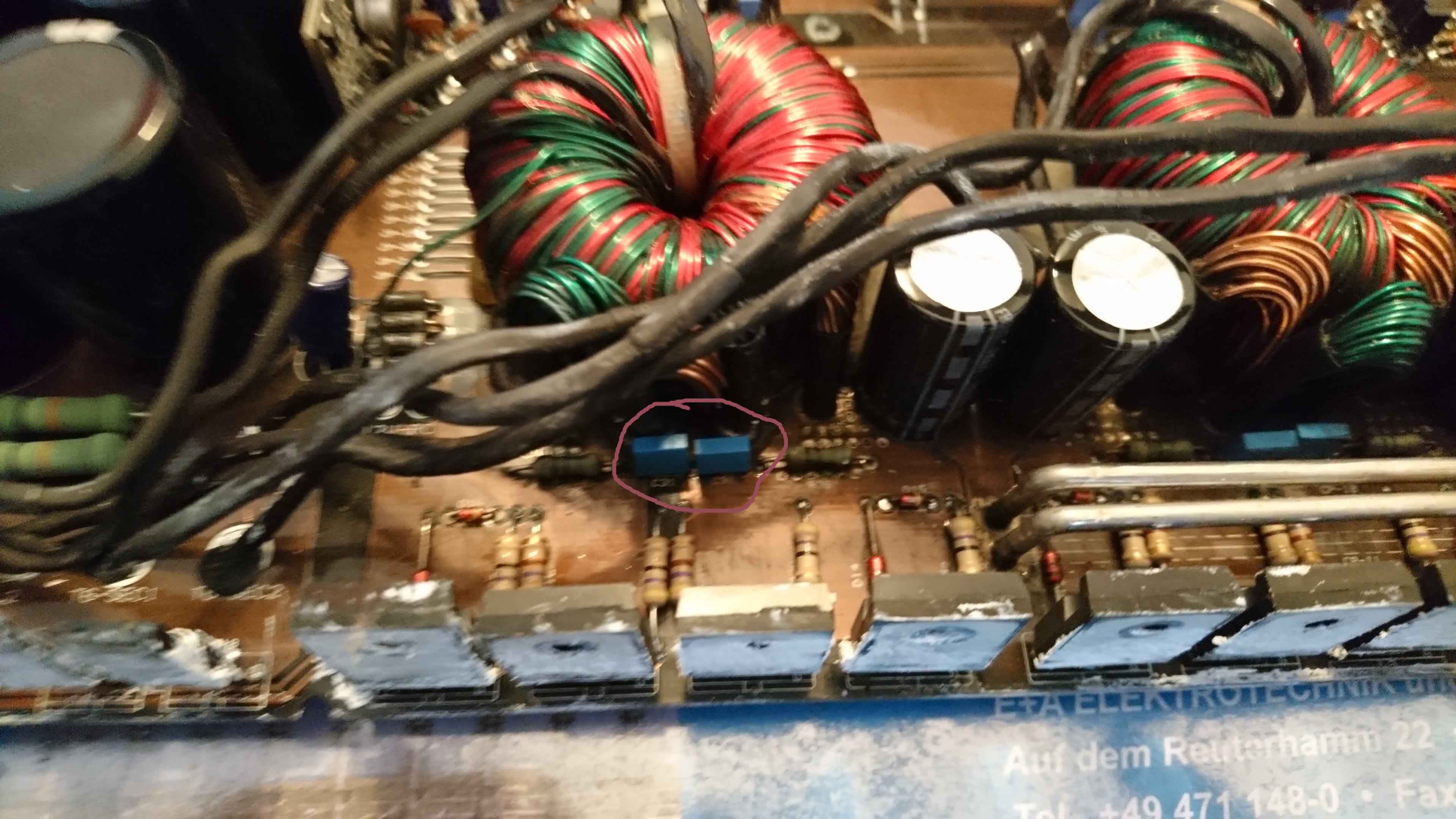

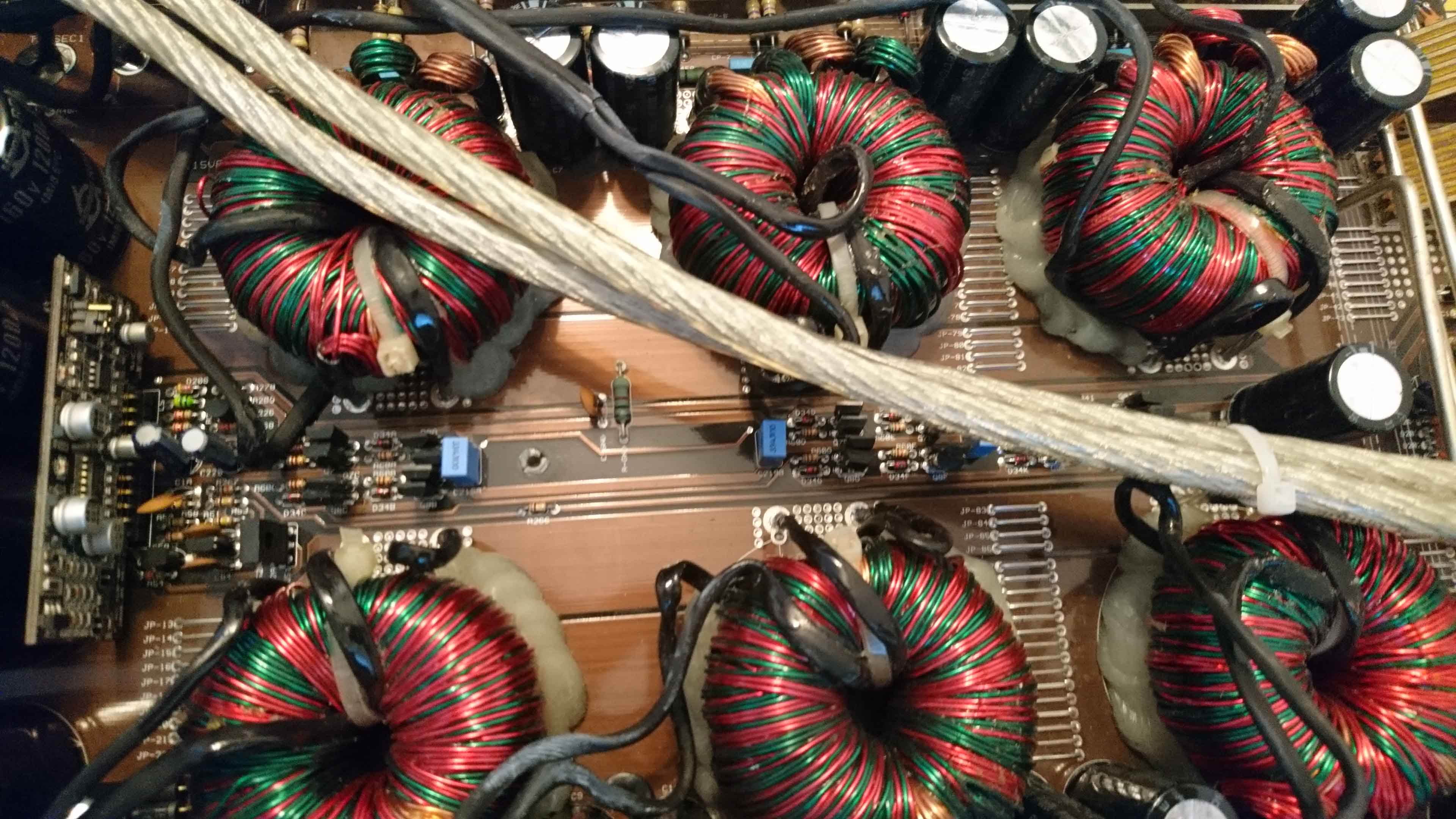

So, received my amp back. First opening shows, that the Audiopart is damaged. Removed the parts, and run the Amp without Audio Fets an Dig. Controllboard.

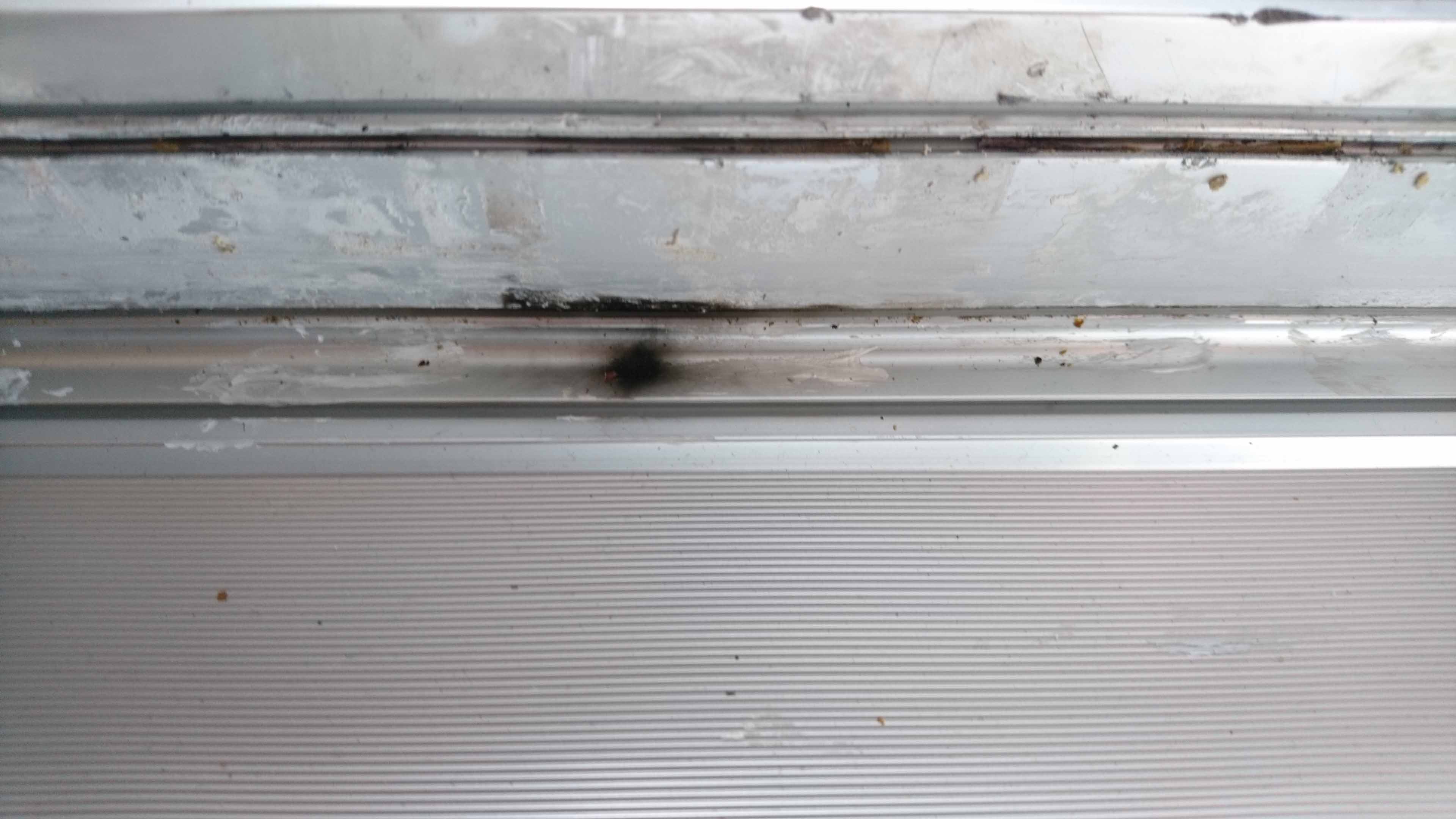

Powering up and have a Rail Voltage from 144V DC. I saw, that i have one burning mark on the Heatsink below the Mainboard in the height from the Audio section. Maybe the board had contact and damaged this...

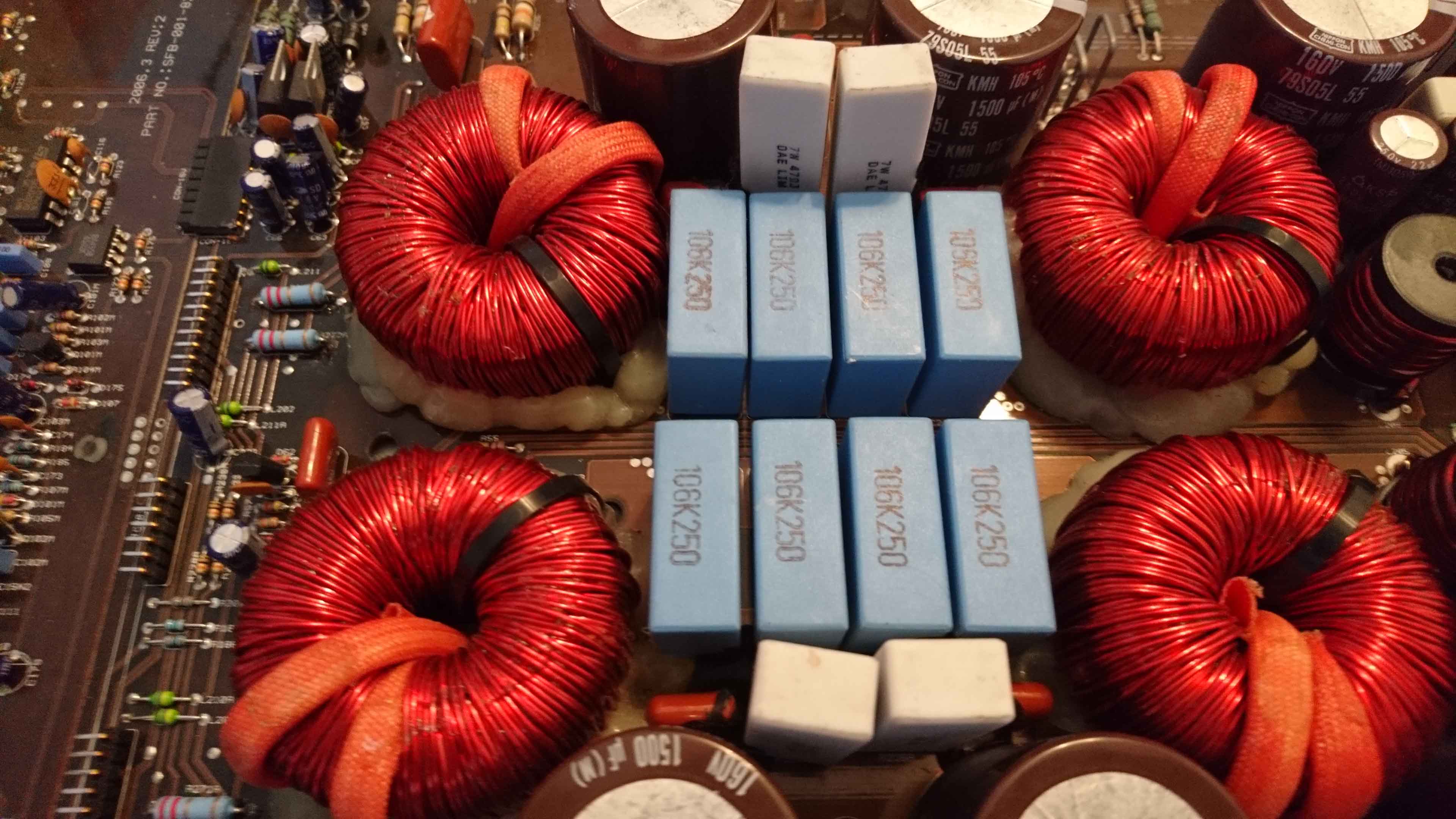

Anyway, you can see on the Pictures, that i have changed the brown foil capacitors from the Powersupply with mkp type, because all of them was open as i received the amp first time. I think i will try to heat the transformers with a hairdryer to see if something happen with the railvoltage.

Ok, so i put the board back in the heatsink, and clamped the Power supply mosfets. Run with 13,2 Volt input and got a Rail Voltage from 165V. Is this normal? Maybe because of missing Parts in the Audio section? The Capacitors can handle only 160V, so if i go up with the inputvoltage i expect, that the rail will rise more.
I tried also to twist and press the transformers, but nothing happen. Everything looks allright. The Transformers got allready temperature ( Handwarm). Still the same. Railvoltage is steady at 165V.

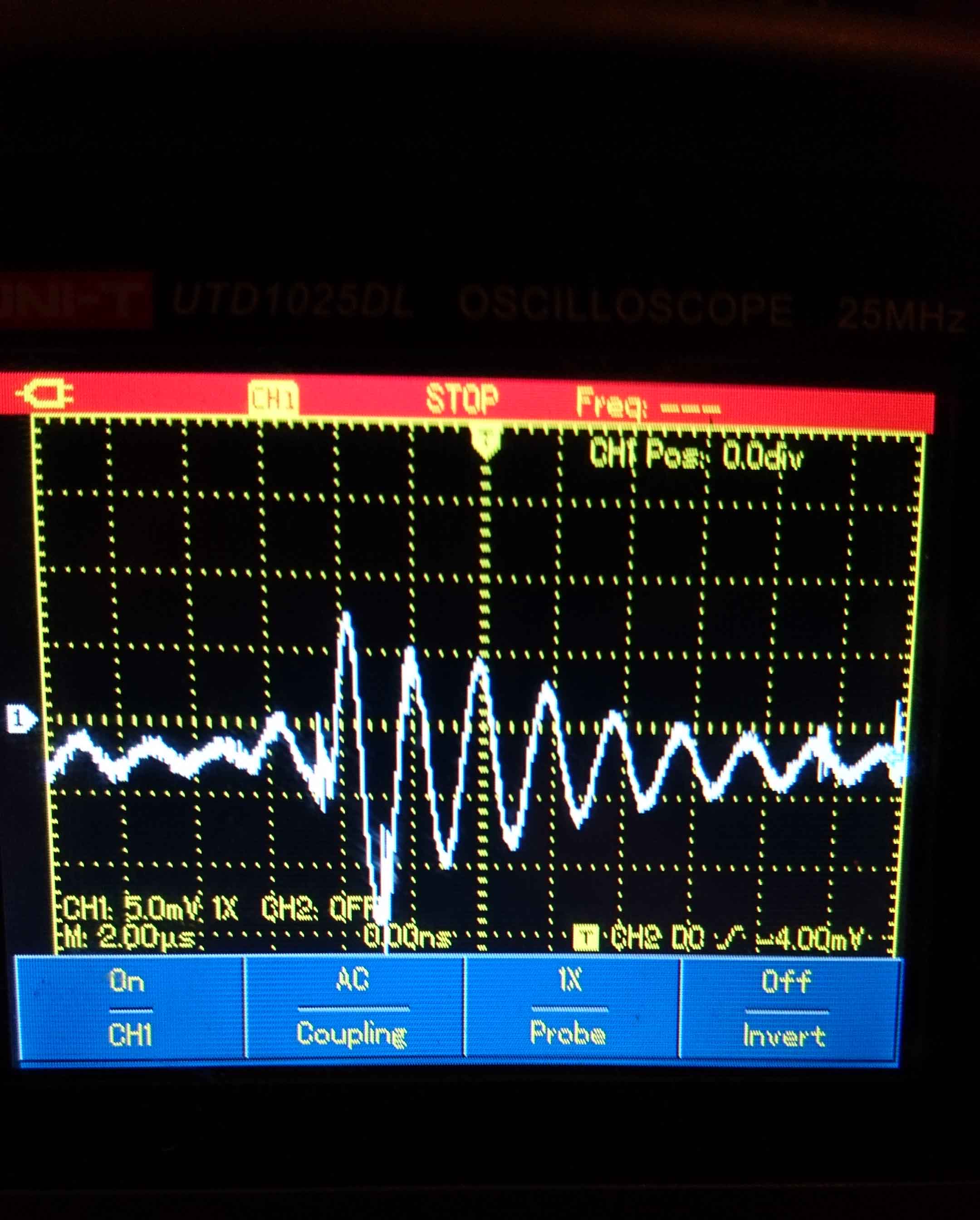

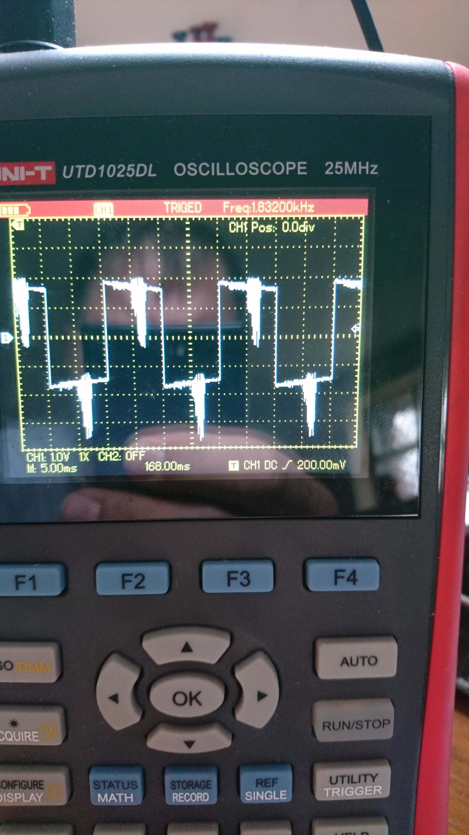

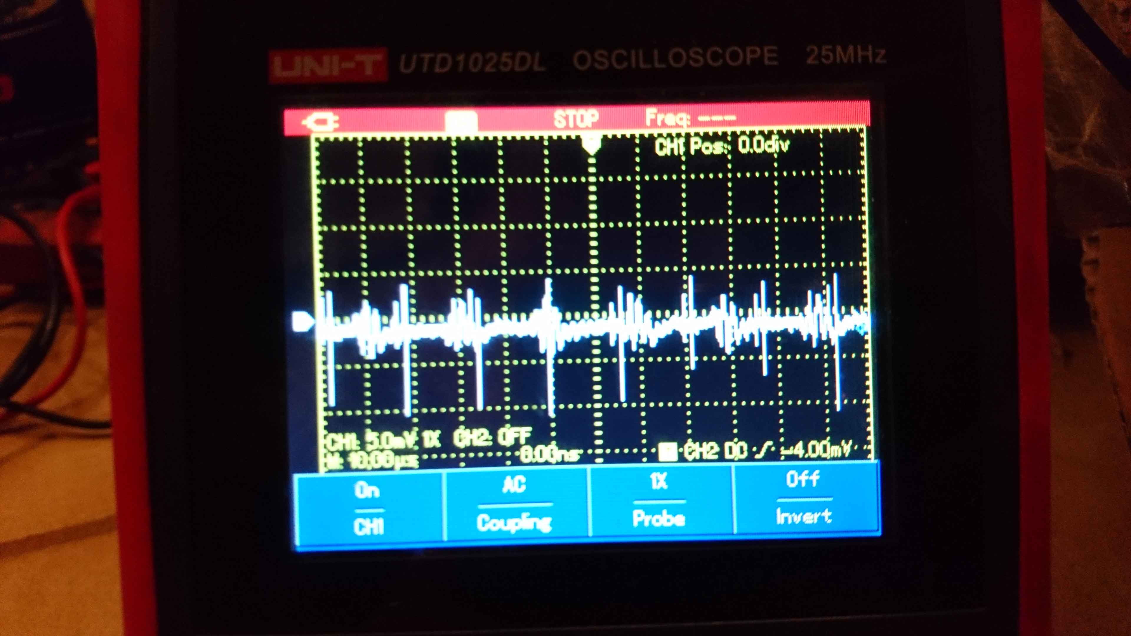

Hello again, the spare parts arrived, so i continued. Repaired the drive board for the audio section, installed new fets for audio section and give 12V on the amp, without rectifiers mounted. I got no Signal on the audio fets. Drive a strong 50Hz signal into the amp, the same. After that i installed the rectifiers and the amp draw execissive current. Two fets in audio are damaged, not blown.
Dismounted the rectifiers and fets for audio, give 12V, the Amp goes into protect. Dismounted the drive board aggain and checked:
Pin 2 and 21: I give +12V
Pin 13 i give +12V
Pin 16 i give -12V
Pin 14 i give +5V
Pin 15 i give 50Hz TTL signal.
Oscilloscope is showing this on Pin 29 and the most other Pins.
Also what i found on that drive board is, if i check the voltage between Pin 16 ( -12V) and the Diodes D1 D5 D6 D3, at the Diodes D1, D6 and D3 i have 12,4V , at D5 only 11,9V. Is the Diode still in range or should i replace?
