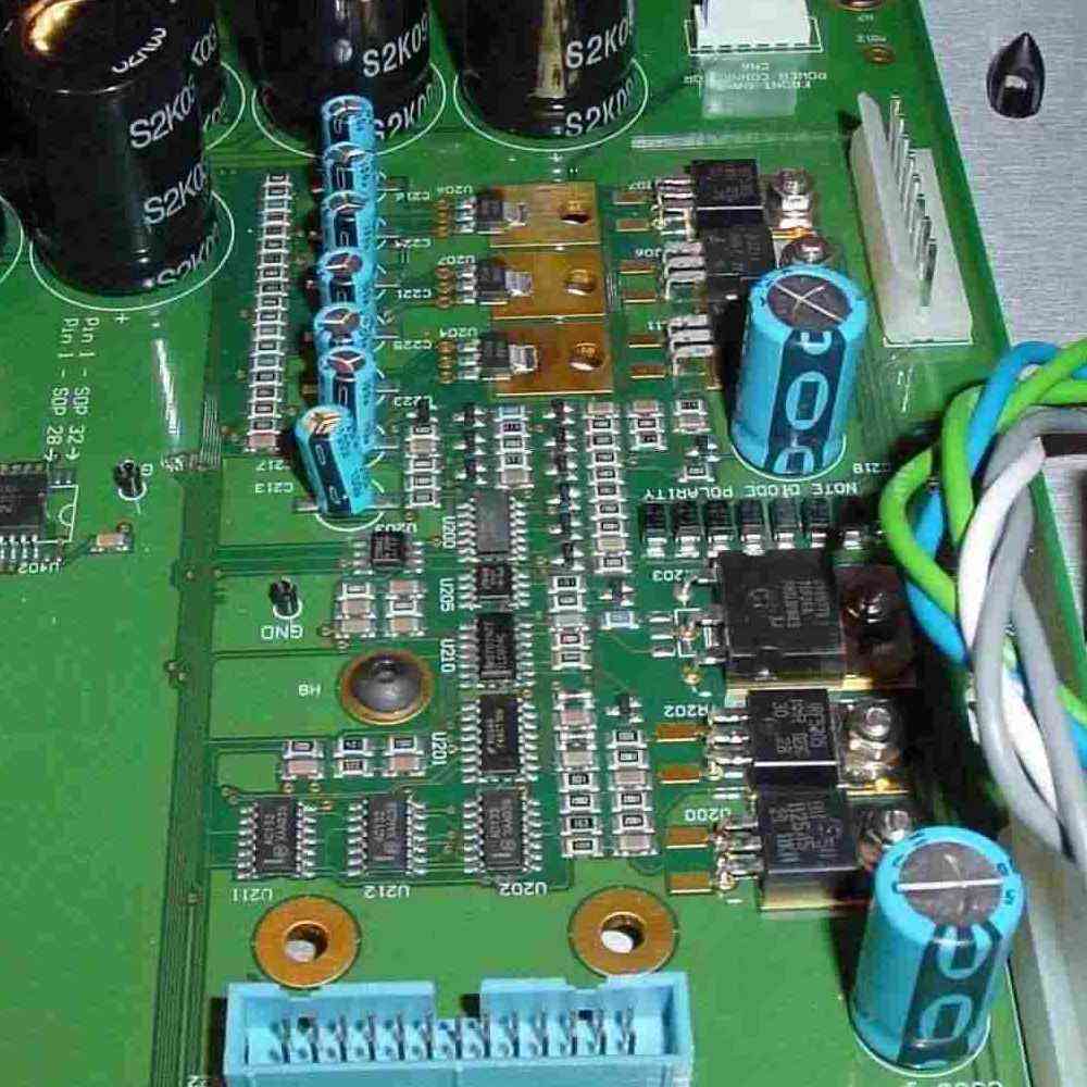

Somebody e-mailed me about the mods I did to ML37 transport. Here short description:
Normally the transport was very uninvolving and annoying, with lifeless hypnotizing sound signature. Switching from ML31.5 I couldn’t listen to it for more than half an hour.
The initial mods were as follows:
The main filter caps (in transport section) have been changed for 6,800 Panasonic Audio grade (previously 10,000u Chemi-Con); in digital section I used BG N 1000/50 (previously Chemi-Con 6800/35).
Bridges have been replaced by discreet diodes, RGB 15B (the same as used in ML31.5); they work better than MSR860 and need cap bypasses.
I didn’t touch regulators yet, as I feel pretty good about the sound as it is. The caps after two main regulators have been changed to BG N 47/50 (previously Nichicon 330/25).
The caps after 3 additional regulators have been changed to BG N 33/16 (previously Nichicon 100/25). I also removed all ceramic bypasses, as well some of tantalum bypasses (BG N work better without those additional caps).
All other places on board got BG N 10/16 or BG N 4.7/16 caps (previously 100/25).
The output coupling caps have been replaced to Vishay ROE 0.001. I also simplified the output signal path and removed ferrites and ceramic filters.
All caps have been placed in special sockets and many different values/types tried until optimum sound was achieved. I also tested STD, FK, different Nichicons, Rubycons and Oscons. The BG N were the best, but the sonic signature greatly depended on actual cap value. If I placed the originally used values, the sound would be unlistenable.
One cap was completely removed.
Such modified transport is better than ML31.5. I still consider modifying ML31.5, but the usage of cascaded regulators make it a bit too laid back for may taste and I’m not completely convinced such use of regulators is really neccessary. While ML31.5 does not benefit at all from air suspension table (it actually sounds worse), the ML37 is greatly improved when using it.
