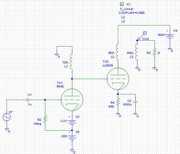

This is a bit counterintuitive, but adding a resistor on the top/cold side of the inductor screws up the frequency response in the low end -- at least according to my spice sim. Basically, when the load impedance for the input tube transitions from being resistive to being inductive dominant, there's a hump in the frequency response. I think it's better if the plate load is as close to an ideal inductor as possible. One could add a cap across the resistor (R1 in my schematic below) but that gets us back to having a cap in the signal path. Though, it could be a smaller, hence, better quality cap than that used in the cathode on the 300B in my schematic earlier.
Note: I made the input cap 100 uF so it wouldn't interfere with the LF response of the circuit. In reality, it'll be smaller of course. Or completely eliminated as I do plan to use an input transformer.

Latest contemplations...
I noticed that in many designs the cathode cap on the 300B goes to the B+ supply. Does anybody know what the advantage of this is compared to letting it go to ground? Better transient response?
In the final version I'll probably use an input tube with a bit higher mu. ECC81/82/83, 6AN4, or D3A come to mind. I just haven't bothered creating a spice model for those yet.
~Tom

Tom, The Cathode cap of the 300B returning to B+ rather than ground topology is what is known as "Loftin White" circuit I believe. By doing this it keeps the 300B AC primary (primary amplified current) returning without going back through the power supply picking up extra noise. The incorporation of this along with the DRD in Jack's design is what attracted me to it when I decided to built my amplifiers. Mickeystan

Nope, what you describe is an Ultrapath or Western Electric type connection. Loftin White is a dc coupled SE topology originally depending on a tapped resistor to derive all of the different operating voltages.
No worries. Actually, it's pretty common to see pretty much any direct coupled SE amp called Loftin White. A true Loftin white uses a specific type of ripple canceling. This was novel and important at the time, because high value capacitors were not available at reasonable cost or size. Their approach takes a bit to get your head around, but is quite elegant.
Sheldon
If you can slog through this thread, you will get the full picture: http://www.diyaudio.com/forums/tubes-valves/123211-darius-loftin-white-explained.html

I'm settling on the Loftin-White circuit with the mods showed earlier. I'll control the negative B+ (C- ?) for the input tube with a Maida regulator. The supply for the 300B will be about 470 V. This leaves about 400 V anode-cathode on the 300B (there's a 15-ish V drop across the plate choke on the input tube).
Currently I'm using a triode-strapped D3a as the input tube. I like it! But there are other high-mu triodes out there to try.
