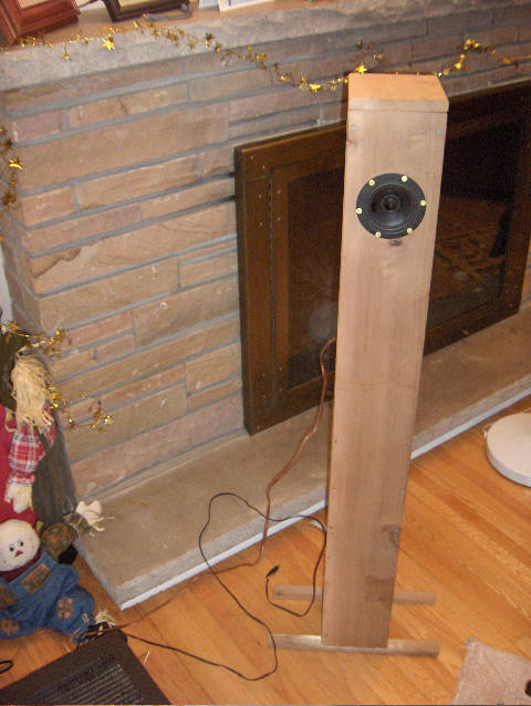

I finally got some baffles built for these little devils. Check them out, I think you just might like them.
http://www.hawthorneaudio.com/photos/displayimage.php?album=lastup&cat=0&pos=3
http://www.hawthorneaudio.com/photos/displayimage.php?album=lastup&cat=0&pos=4
They're made out of PVC to look like wood and leather. They actually look better in person d/t the poor resolution of the shots, but they are all I know how to post on that site.
Dan

RS100s-8
Just picked up some of these little Daytons and have been running them full range for about a week. I have them in cabinets that really shouldn't work. They are 1.7 cu. ft. boxes with ports tuned to 45hz.
(While the 45hz tuning probably isn't too far off for the RS100S-8 the 8" hole in the baffle where the woofers used to be in the previous project should be detrimental right? Weirdly, they sound better with the gaping holes left open than when I covered them. (?))
My first impressions of them are quite positive. They are a very fast, very detailed and very cohesive driver. The bass isn't ideal-- that is to say, in the imperfect cabinets I'm using, the bass is not very deep (but better than I would have expected from a 3" driver) nor is it very fast. The rising distortion below 200hz translates to slow but tuneful bass-lines. The rest of the audible range, however, is really stunning. Even off axis the top end is quite reasonable and the mid-range is (sorry to be dramatic here, take this with a grain of salt as I've only had them for a week) better than I've had since I got rid of my ESL56's. The real strong point of these drivers is to make music-- cohesive, involving and tuneful.
I need to make better cabinets for these but before do I have a question:
Does anyone have experience with the Jordan drivers? like Vautrin, I was really expecting to order XJ92S's but bought the Daytons on a whim ($26 dollars is quite preferable to $180). The Jordans should have better bass but do they equal or better the Daytons' midrange and top-end? I heard a Jordan-based speaker years ago that used fuzzy-flocked polystyrene foam cabinets but don't really recall how they sounded.
Efficiency isn't really a concern as I have around 60 watts from my home-brew Naim NAP-180 clone. But a little deeper and more accurate bass would be nice as long as it didn't come at the expense of the mid-range clarity and nice top-end I'm getting from the RS100's. If the Jordans are better I want to make a move on them while they are still on sale.
