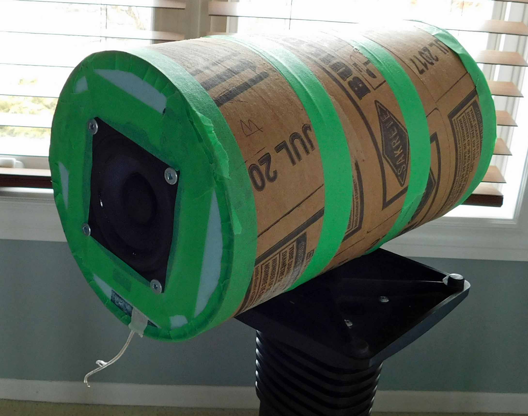

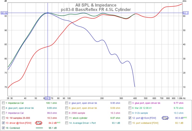

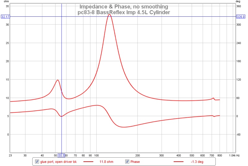

Bass Reflex 4.5L Cylinder
The same design as before, only implemented in a cylinder with stiffer walls.
The bass extension response matches what was predicted in HornResp. I get a flat combined response from 600 Hz down to 60 Hz. No more saggy bass when using stiffer walls. The port and driver are on opposite sides so they were measured seperately and combined (green curve) So I think it is behaving properly from the FR perspective. However .....
I still have to address the impedance curve issue. In my other larger driver designs (8", 12") I can get symmetric peaks. With this smallish driver I always get asymmetric peaks. Although the peaks are more defined now, there is a 2:1 difference in the amplitudes that I cannot seem to correct. I have tried taping, sculpting open the driver rear path, filling, and port length adjustment. Nothing will raise that first "mole hill into a mountain". Perplexed :scratch:

I'm not certain why you worry about the impedance peak symmetry. Under normal circumstances, this will only happen when Fb=Fs, which does not appear to be the case here, where Fs=82Hz (as per spec sheet) and Fb~63Hz. Change the tuning to Fs and you'll see the peaks even out, not that this is necessarily a goal here.
I might be expecting too much from this. The Impedance peaks don't need to be exactly equal but more similar than they are now. Even though the box tuning is correct, it appears that the first peak is over damped. It might be from such a small port diameter or something else.
I would expect the first bump amplitude to be a "little" lower amplitude than the second bump amplitude because the box is tuned lower than driver Fs. In my case the first bump is a lot lower.
Did you measure the T/S parameters on your driver? I'd venture to say its Fs is slightly higher than published, which would account for the lower impedance peak's lesser amplitude as the actual Fs is further from Fb vs simulation. Suspension stiffness also often differs, causing both Fs and Qm/Qt variations which is reflected in the maximum impedance.
Thanks @IC81 for the suggestions. No, I didn't measure this driver T/S and that would be interesting to see how close they are to the spec sheet.
I did suspect the driver parameters at one time but when I varied them in hornresp I could not replicate the impedance behaviour I'm seeing. Hornresp has been very good at predicting the impedance profiles on my other designs (different threads) so I have a bias to believe it.
More recently I decided to test my "too small (3cm) port" idea and tried another solution using a larger port diameter (5cm) and longer pipe length. The peaks are in the same location, only the lower peak increased from 15ohm to 18ohm. A small amount of poly stuffing in the port will erase the first impedance bump.

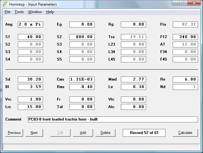

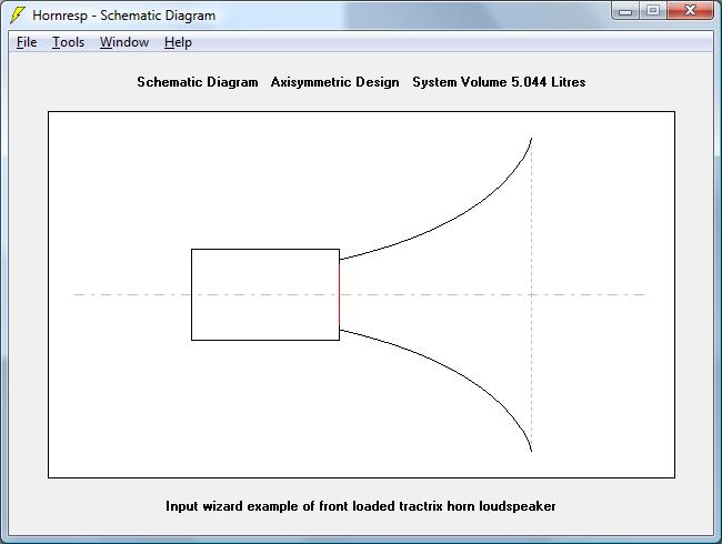

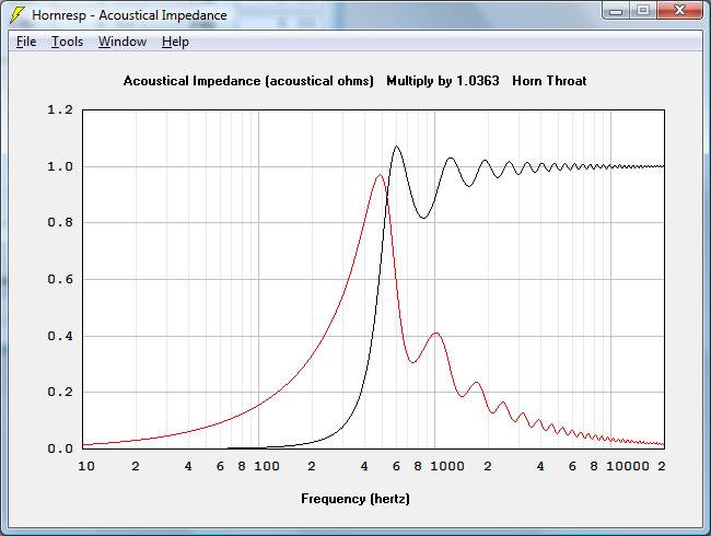

Tractrix
I decided to try another horn. If cardboard worked, maybe foamboard would work as well. Ideally I'd like a low distortion midrange 800Hz-4000Hz range with some gain (>6db over bare driver).
This time it's a rectangular tractrix. HornResp snapshots below.

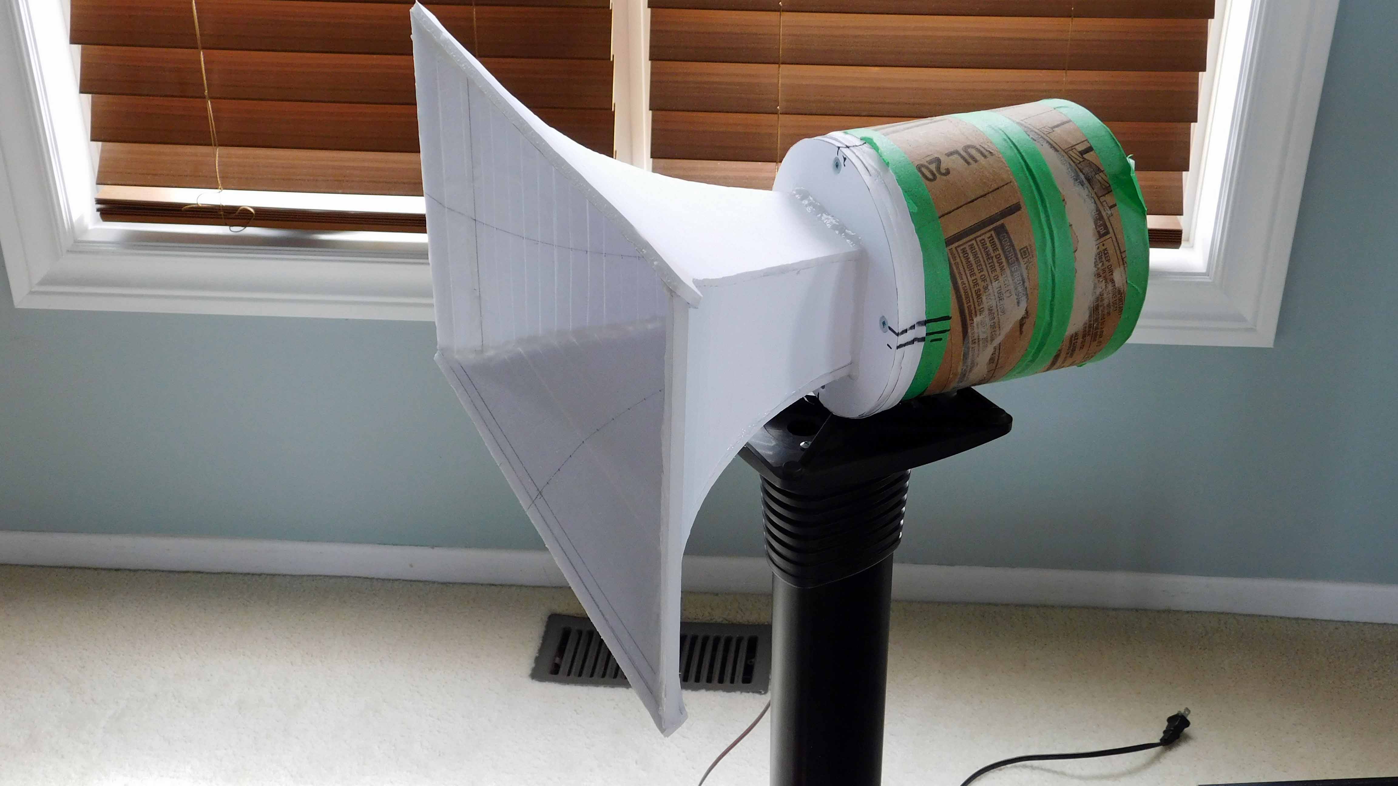

Tractrix - built
It's a little tricky to bend foamboard. The panels have been scored on one side at regular 1cm interval then bent. The panels were hot glued together, then the interior surfaces were "painted" with hot wax to create a smooth surface.

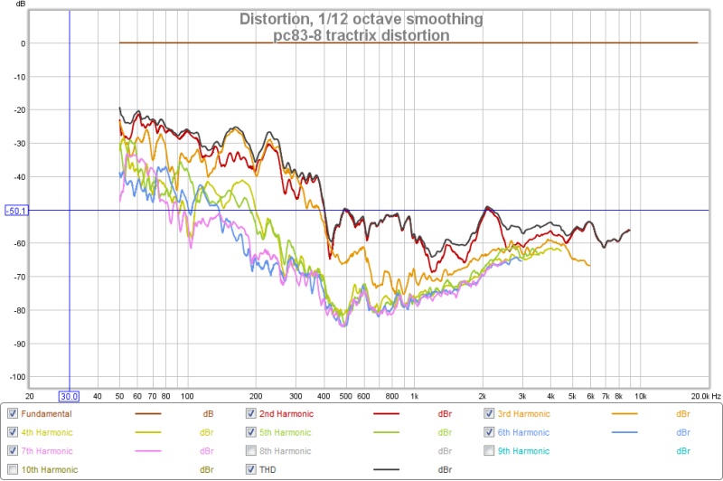

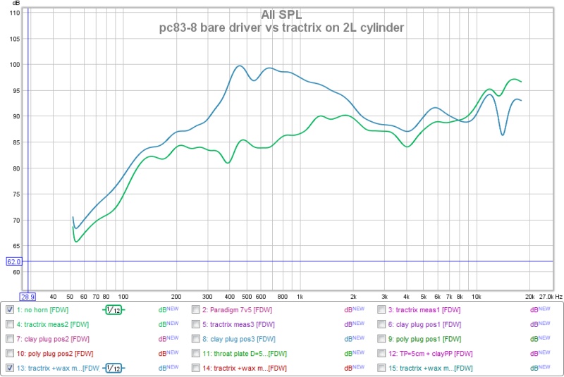

It still has that "saddle" shape in the FR like the other horns. The horn gain in the 400-1.2Khz region is significant compared to the stock driver (graph#1). The distortion is also reasonable at -50db at >400Hz (graph#2).
I wish I could increase the horn gain in 2Khz-4Khz region. Suggestions, anyone ???
You could add a phase plug to get some gain at higher frequencies.
Phase Plugs
Even simpler than 'simple' type would probably be fine, e.g just a wedge.
Some commercial horns have a phase plug that are approximately the shape of an axe head:
China Speaker Phase Plug 8 Inch Cabinet (084C) - China PRO Audio, Phase Plug
Alternatively: rebuild the horn, and make the throat smaller and asymmetric, such as a 6x3cm rectangle.
Phase Plugs
I did try to reduce the throat area to 20cm^2 to increase compression ratio. It causes a resonance because a chamber is created with the cone.
I like the driver dust cap shapd phase plug idea. That would eliminate the chamber and increase compression. Easy enough to try. Thanks.
