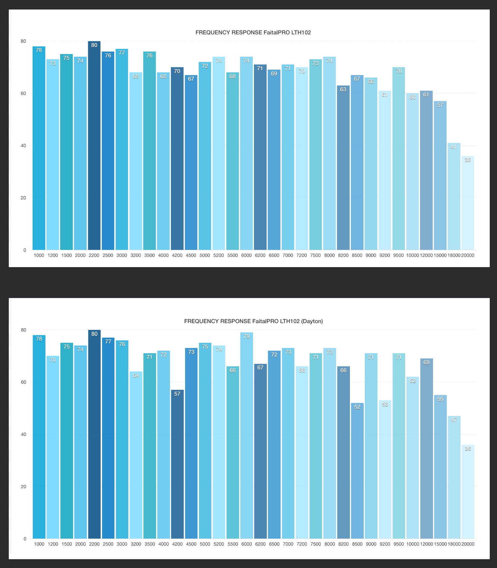

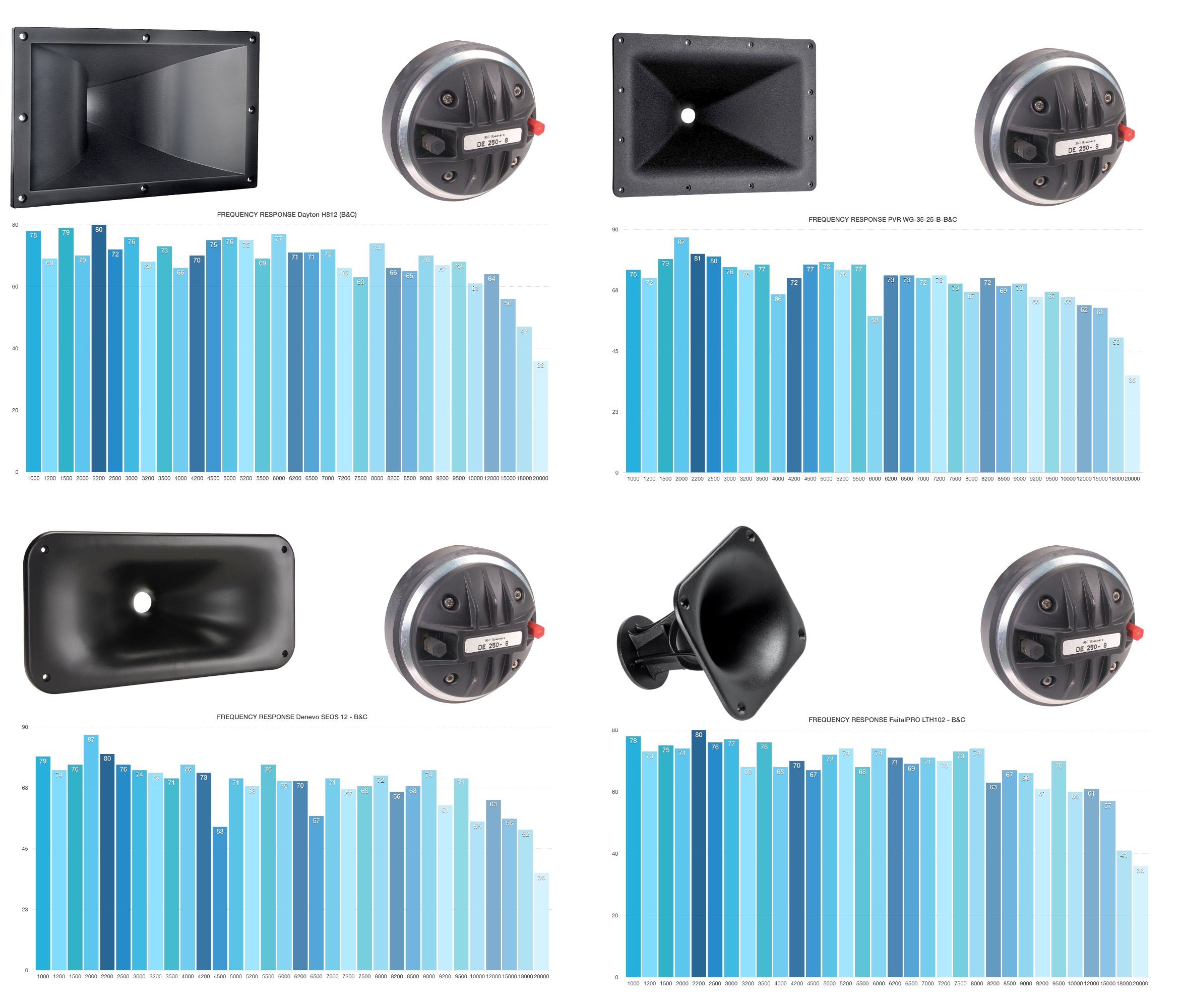

I bought the B&C DE250 and compared it to the Dayton D250P. They are physically similar. The Dayton's back cap is plastic and doesn't perfectly cover the element inside which exposes it to backwave pressure from the woofer. The B&C's back cover is metal and fits perfectly. For my testing, the drivers sat on top of the cabinet uneffected by the backwave.
Subjectively, the B&C has a more liquid sound, the Dayton is dryer and more garbled.
Here are my in room measurements. I used the very nice looking FaitalPRO LTH102 horn. Clearly, the drivers don't measure the same.

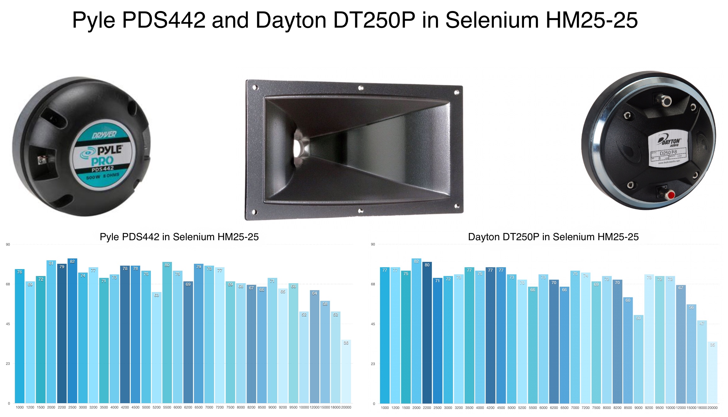

Pyle PDS442 and Dayton DT250P in Selenium HR25-25. These are both good budget drivers to cross over at 1600Hz. I haven't seen any measurements on the Pyle PDS442 so I thought I'd post mine. It sounds better than it's low price suggests. Neither of these drivers produce much sibilance. Neither is better - they both sound good. Maybe the Pyle sounds a bit more colorful.
