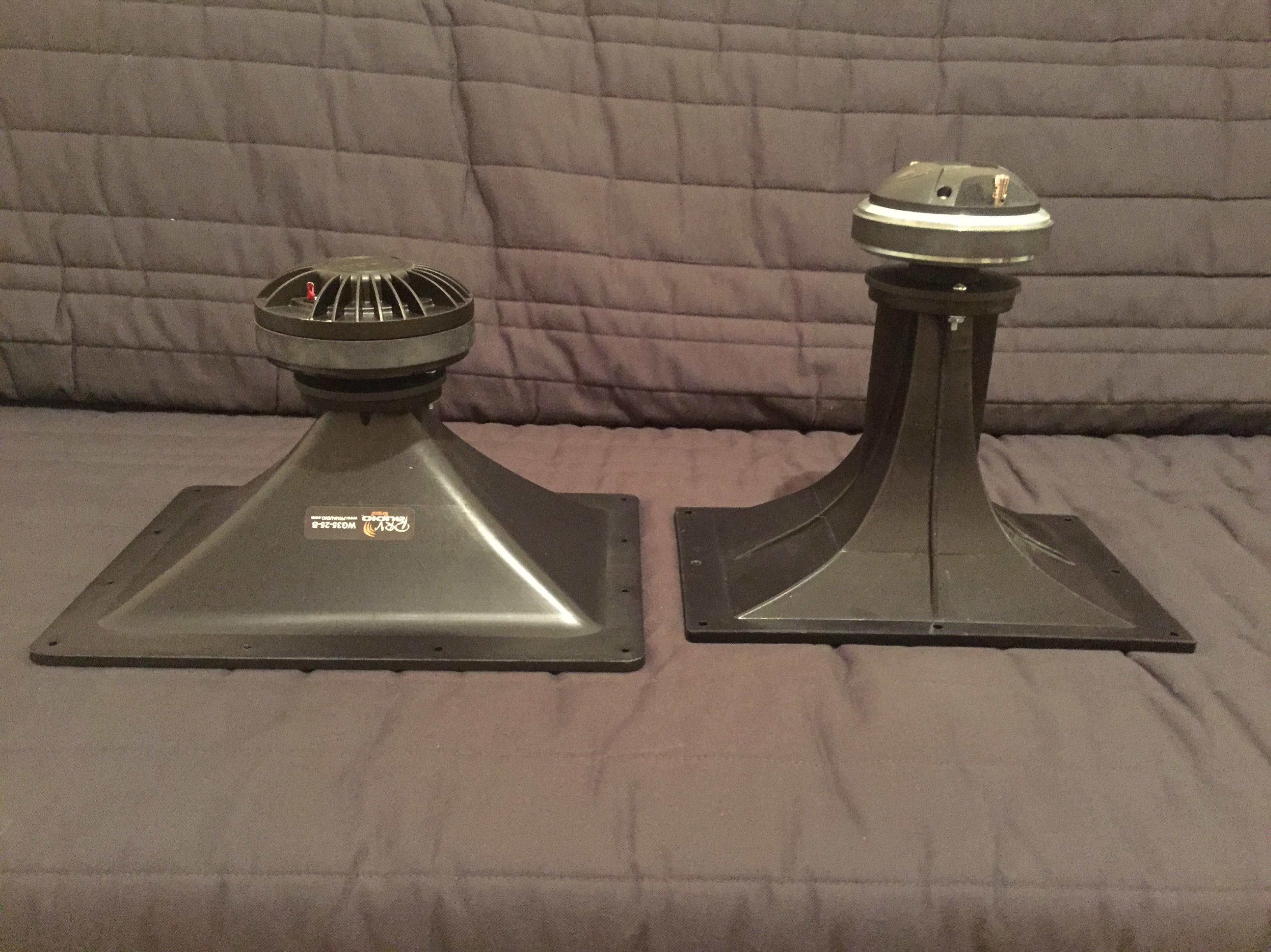

A nearly two hour listening session showed me the DT250P with the Dayton H812 sounded better (to me in my room) than the Eminence PSD2013 (which is more sibilant but still very nice to listen to in the H812). I preferred the sound of both drivers in the H812 to the PRV WG-35. I didn't directly compare the H6512 but upon memory the sound was better with H812. I guess I'm an exponential guy.
The horns fitted with the drivers pictured here. I swapped things around and listened until choosing the one I liked best. As EarlK's measurements show, there is a treble lift with the H812. It's audible. With the exponential horn there was no deficit in treble. Brushed cymbals were much more apparent without calling attention to themselves. I thought vocals sounded more natural too. Guitar strums and violins were more 'there' in the room with me. Very enjoyable, relaxed presentation with a slight treble boost.

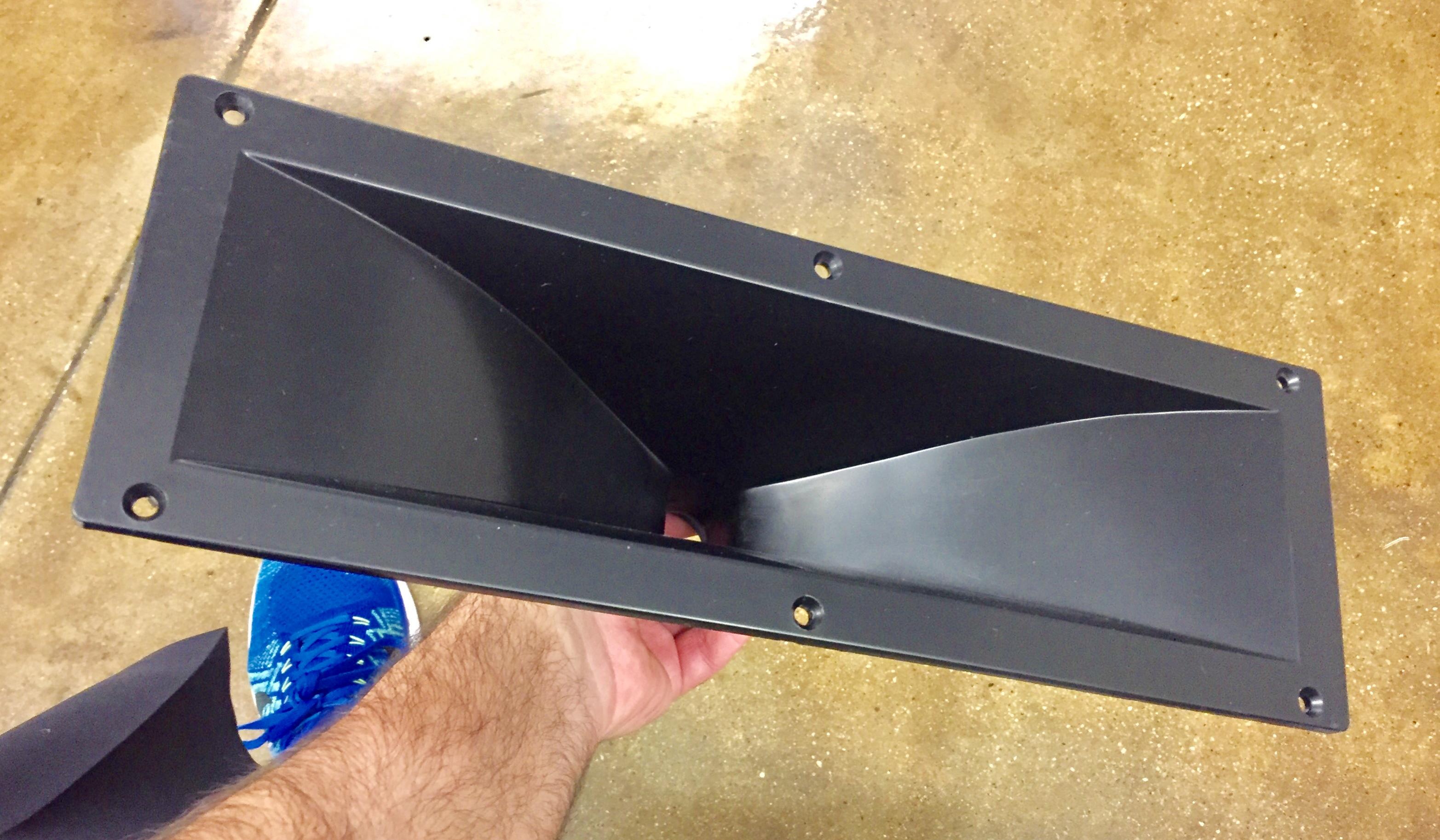

The two waveguides had less treble. They sounded dryer and less detailed in the treble. I enjoyed the sound of all of these components but I'm glad I bought them all to hear the differences. I'll continue swapping things around for a few weeks and see if my preference changes. I cut wood to make swapping the tweeters easier.

The two waveguides had less treble..
CD WG's must be equlized

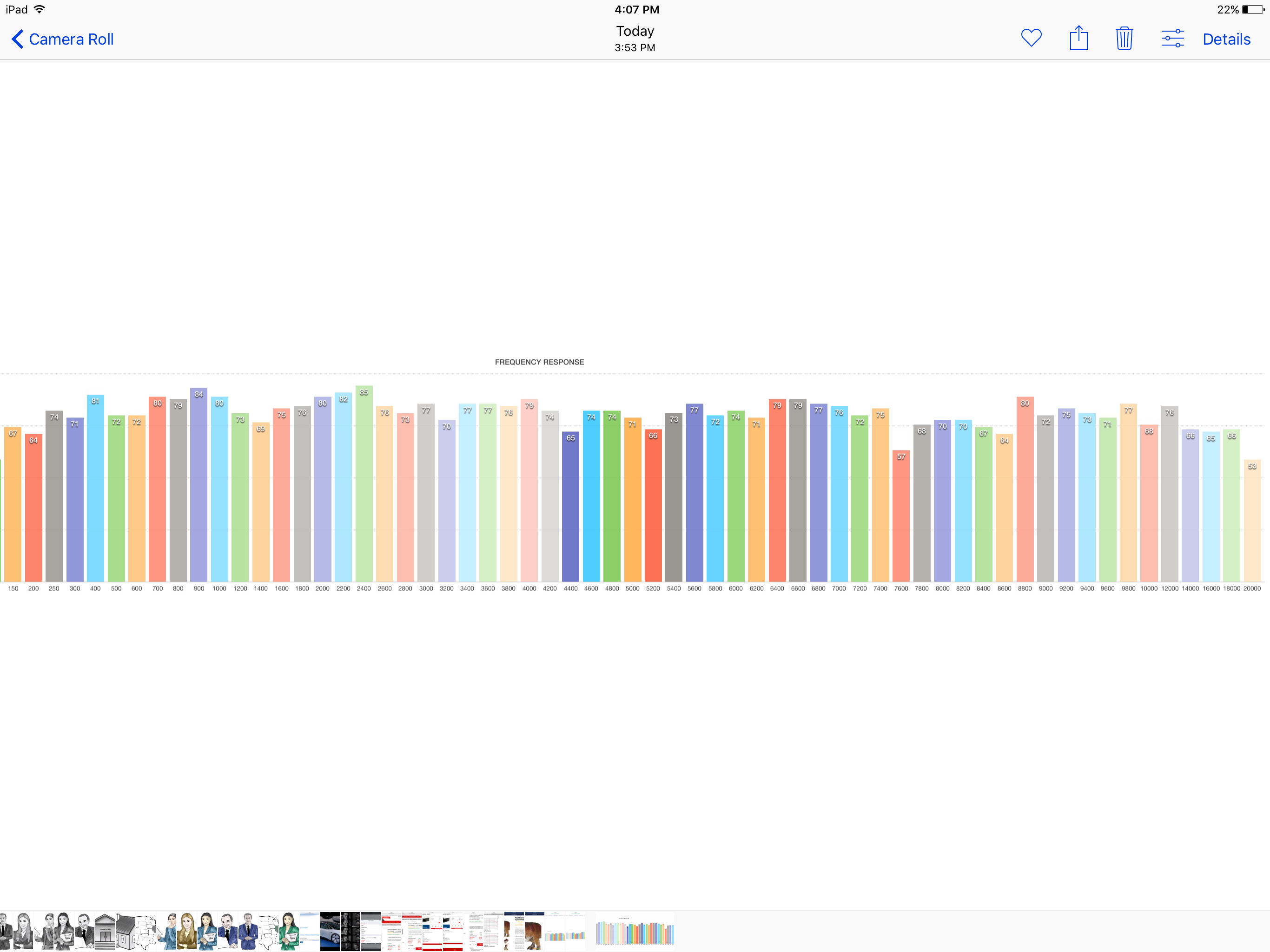

On axis response of Dayton DT250P in Dayton H812 exponential horn in my room. Much smoother than Eminence PSD2013 in the same horn. Combined with Eminence Lil Buddy on open baffle and the standard Eminence 1600hz xover is a really nice combination. Bass support provided by H-frame with Alpha 15. Nice, detailed treble. Listening sessions are long.

hey Zilla - with some of your horn/WG. you are EQ-ing acoustically with the horn. A long, slowly expanding "neck" can give more low end and hotter "on axis" response. What did you use to get that response graph? how does distortion measure with your Dayton?

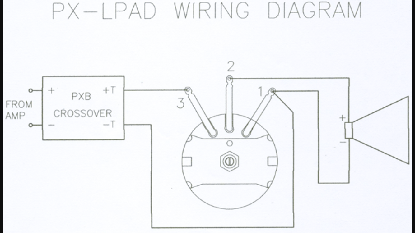

EQ can be accomplished by a resistor with parallel bypass cap in line with the driver. There ought to be enough gain to throw away with a Buddy (?)
Can you please draw the circuit as simply as possible for me?

hey Zilla - Wayne at Pi speakers is the man for knowing the R and C needed for your drivers and horns - plus I think he's used the generic Eminence 1K6 network in this type application. Give Wayne your specifics and he will help. You can also look at the basic Econowave crossovers by the late Zilch. Those usually seem to put a shut load across the highpass then the RC compensation.
here's what you're doing in post 15 - the capacitor is bypassing the series resistor ("3" to wiper) part of the L-pad. The frequency turnover changes with the amount of attenuation
Here's the separate resistor bypassed with a capacitor "before the L-pad" in the Econowave scheme. EarlK can probably give you a value of shunt cap if needed for the highpass section of your crossover (are you still using the Eminence 1K6 board ?)

The variable Lpad that you use is constructed from 2 ( exposed 1-side ) wire-wound resistors ( along with a rotatable wiper system ).
So no, you don't really need to add any more resistors into the system ( if you are going to keep that variable Lpad in one position ).
Simply adjust (dial-in ) the amount ( balance ) of horn midrange .
( To Taste ), Add back the amount of HF you want ( restored through the capacitor bypass that's wired to pins 3 & 2 on the Lpad ).
The smaller values of cap. ( measured in uF ) offer less HF restoration .
Start with 1 or 2 uF.
