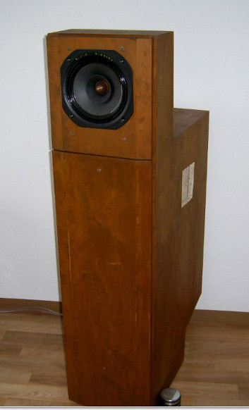

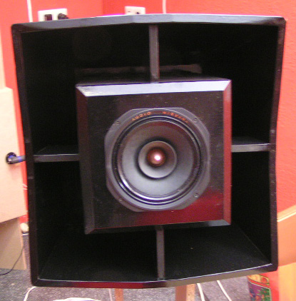

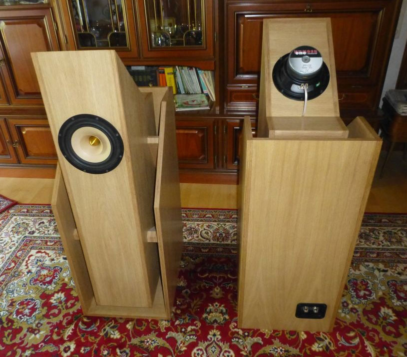

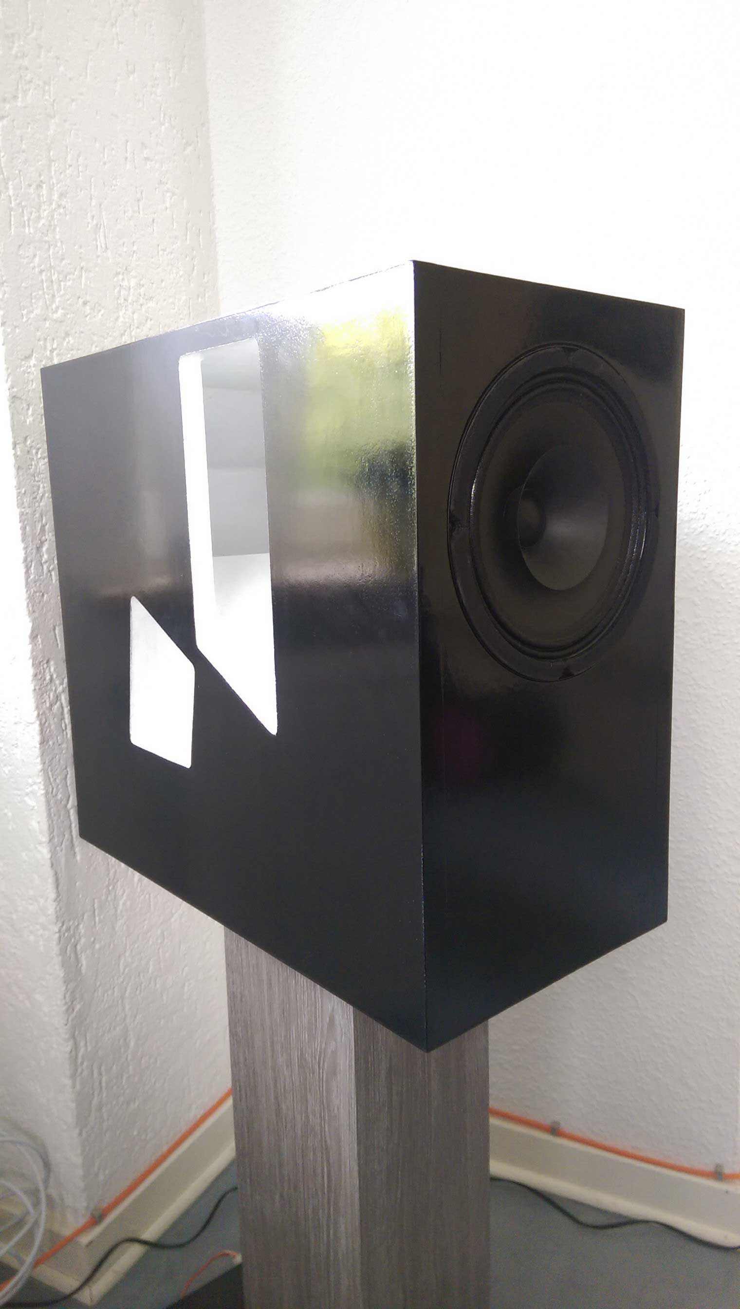

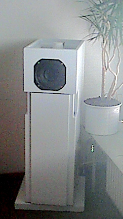

i made a few horns which will work with the Dayton driver, as an Satellit and double horn with invers indirect driver, no parts, down 35 Hz, take a view on my HP,
SCHALMEI + HORN SAT, SAXOPHON, RDH20, POSAUNE XL.
