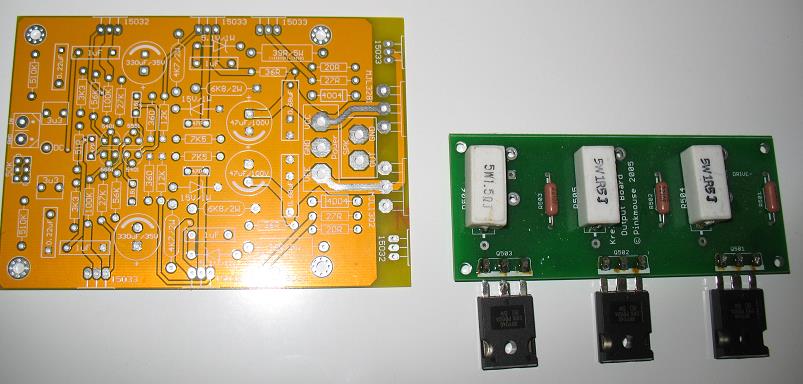

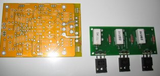

My idea to combine these PC boards somehow. I know it would be better to get one PC board with 3 pairs of power transistors (I can use 2 pairs with that also). Of course, if I could get a decent priced PC board I may invest into that, at this moment I don't know other option.
I do not want to buy populated PC boards when I already invested a lot of fund into parts and I know the transistors I use are direct from ON Semi.
Do they sell unstuffed PC boards for a reasonable price?
I have 4 of the output PC boards just too complicated to wire them properly.
