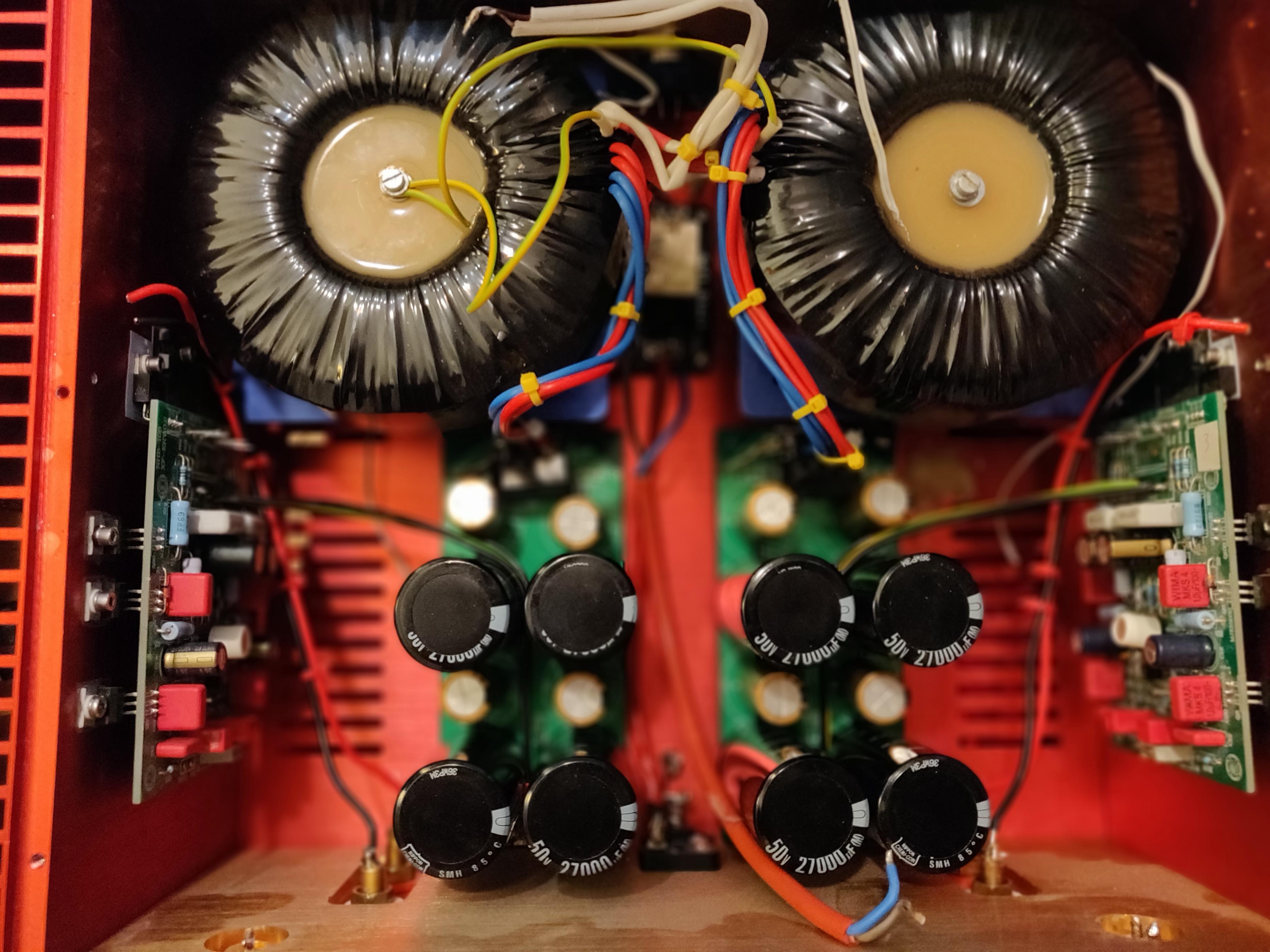

Connection to the Diodes in front? Anybody knows it is a bit confusion .I connected from amps + to Diodes+ and from gnd to Diodes - and no light at all. Used 47kohm in series and there is 12.2 v for the 12 v entry on the Diodes PCB. View attachment 736014

I can see the light in the Diodes now in the evening.Connection to the Diodes in front? Anybody knows it is a bit confusion .I connected from amps + to Diodes+ and from gnd to Diodes - and no light at all. Used 47kohm in series and there is 12.2 v for the 12 v entry on the Diodes PCB. View attachment 736014
If you are trying to light an led with 12 volts, I think that 47K resistor is too much.
By at least a factor of 10. Where is that Ohm's law when you need it?
No I take from the amplifiers 46 VDC supply. But still I think the 47 kohm is to much. Depends on the Quality off the LEDs.
Well, is it here..??
LED Resistor Calculator
You can not use that calculator. Modern LEDs is so much efficient then earlier.

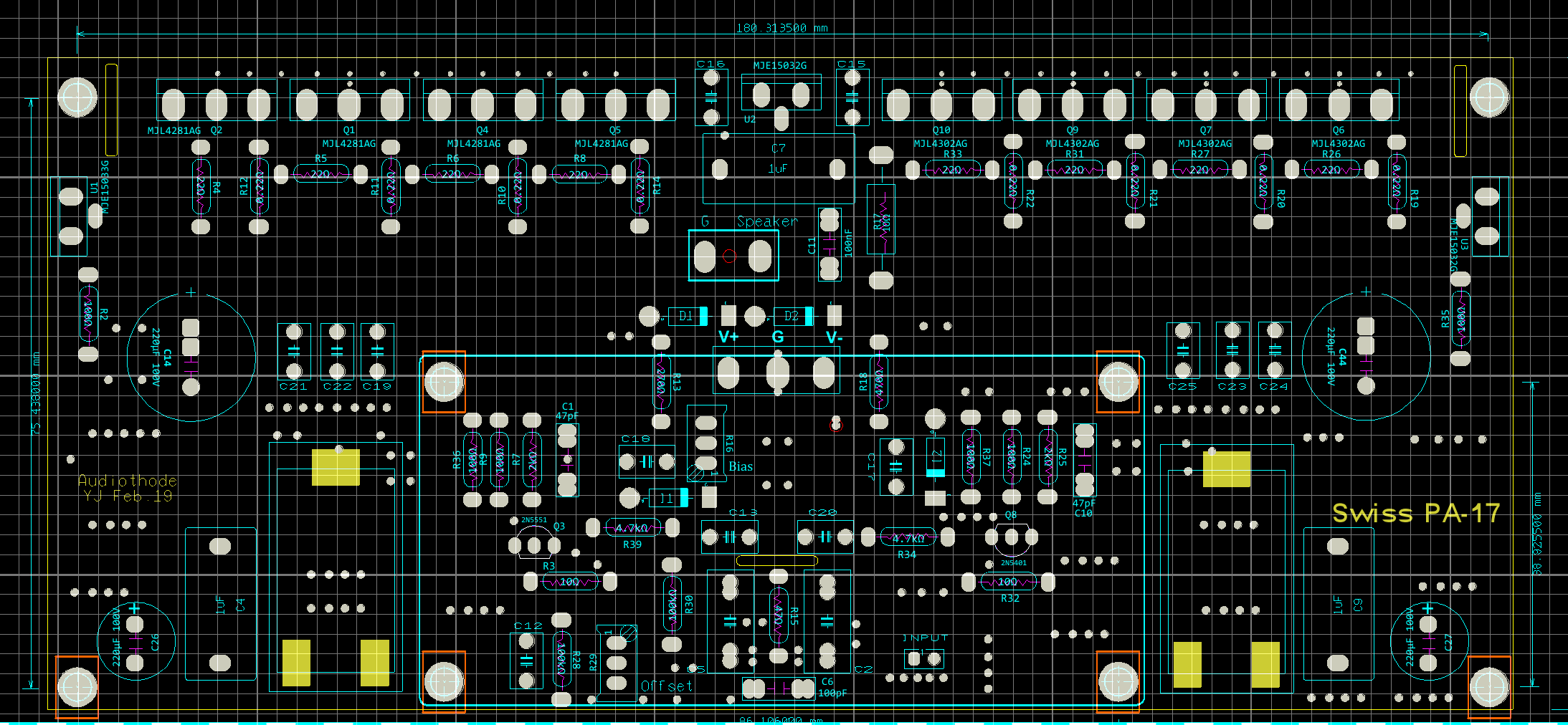

I made a clone but with 4 pairs of finals
4 pairs? My interest is piqued.
Is it for higher power, 1 ohm loads or class A? What voltage rails do you have?
Yes, 4 pairs, but we can not talk about Dartzeel anymore
substituted Q 9, 10, 90 and 100 from MJE in to 220 with power transistors the same as the final, the polarizations for the 4 pairs, R 19 and 20 and Z 1 and 2 have been changed
changed C 15, 16, 17, 18
0.22 ohm resistors on emitter power end transistors
Powered input and driver with VCC stabilized at 60 VDC
Powered final stages of power with VCC stabilized at 50 VDC
Replaced C 6 and C 7 with higher quality cap
Bel finale, but another final, a result of stature
