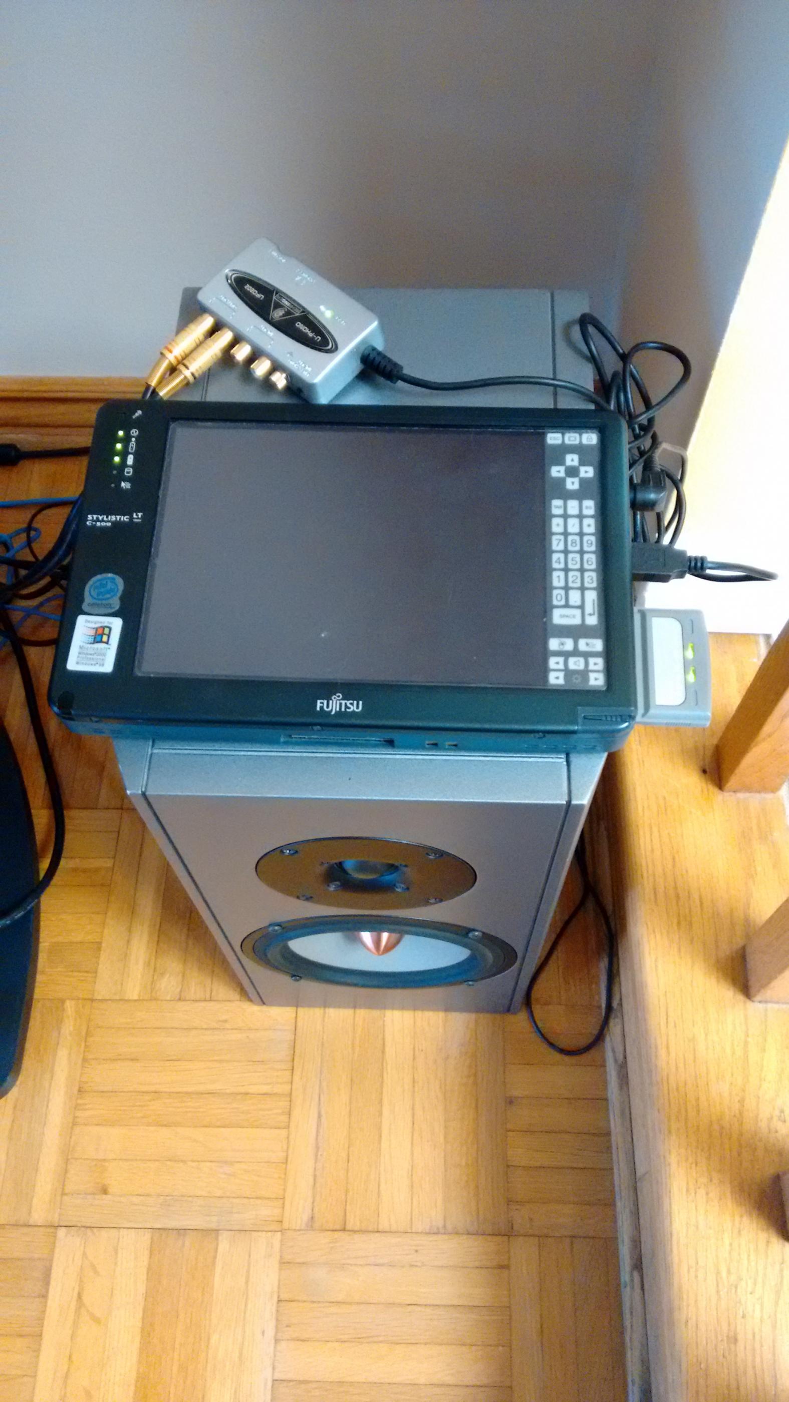

Happy Camper Here.
Installed October 11 firmware on this old Fujitsu tablet with only 250mb ram.
Using el cheapo Behringer usb dac. Sound is sweet (especially since I was going to toss the tablet in the recycle bin). Attached a dlink ag wireless card so I'm connected at 5 MHz . Radio and apps work as well.

YeS indeed, I can confirm this. I used Oct. 14th many hours, and restarted many times to see if the problem of former version still exists. It started always without any CLI errors! Congratulations KimmoThe Newest Oct 14th is working fine with BruteFIR mode

However, I have just found out that the old Dell laptop works and the Asus VIVO mini computer again with very high pitch when the BruteFIR is enabled!I have just using the newest version, but everything is working fine with me. BTW I am using 15.10-b161253-x86_64-rt.
OK! The problem is not the computer. The problem is from certain DAC. At least the cheap Behringer DAC is having problem which is using Burr Brown PCM2902 chip. Funny thing is the older version has no problem.However, I have just found out that the old Dell laptop works and the Asus VIVO mini computer again with very high pitch when the BruteFIR is enabled!
Never mind! Sorry for my mistake, It should the computer compatibility problem still and not the DAC. As I reboot again and the high pitch happen again.OK! The problem is not the computer. The problem is from certain DAC. At least the cheap Behringer DAC is having problem which is using Burr Brown PCM2902 chip. Funny thing is the older version has no problem.
