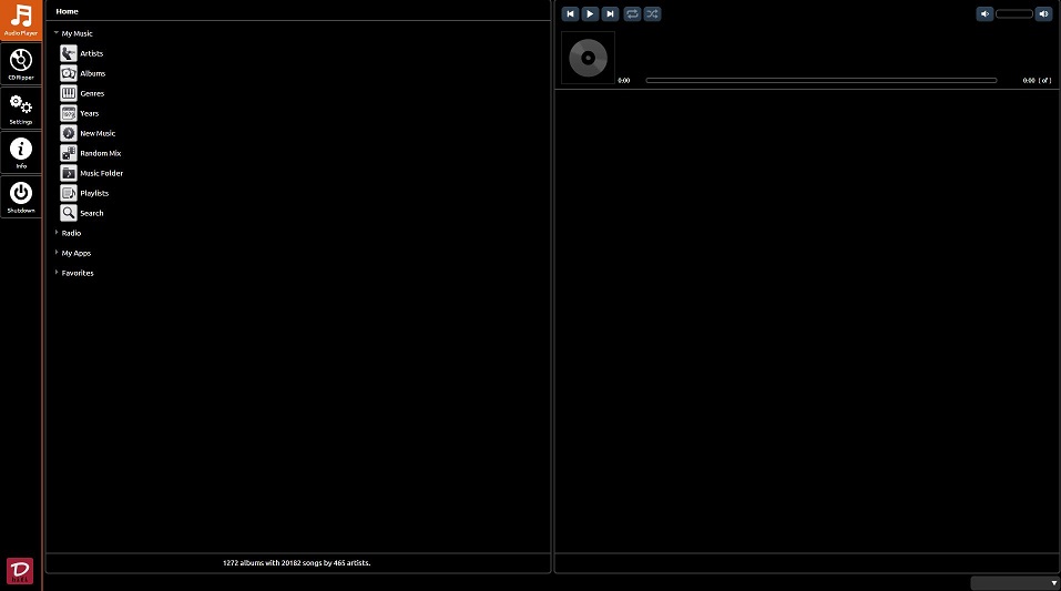

I think the issue on my side is the Audio Player bottom right dropdown... I dont have anything selected and if I choose dropdown it sees my existing Squeezebox server and my SB Touch but I dont want to play via that, it should play via Loki.

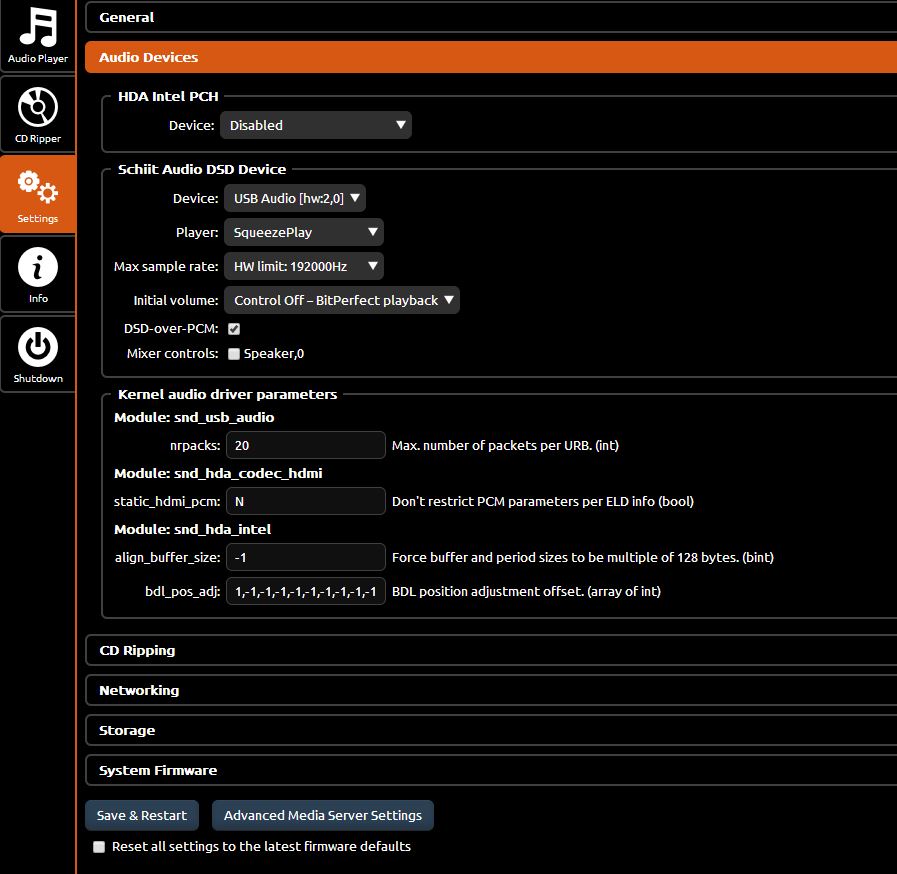

My Loki dsd dac is connected with usb cable to my Daphile server - but I dont know how to play music to it.
I know its something probably small setting I am overlooking
Here is snapshot of my screens:
You probably have to enable the "Speaker,0" in the Mixer controls.
The other screenshot is a bit worrying because the Player selector at the bottom right corner is empty. You should select your DAC from there. If it is not availaible there is something wrong. Please contant me then via the form on the web page www.daphile.com and we could continue with email exchange.
You should define the "Identification" field. It may be almost anything you want, eg. MyMusicLib.
Thanks a lot.
It works great.
