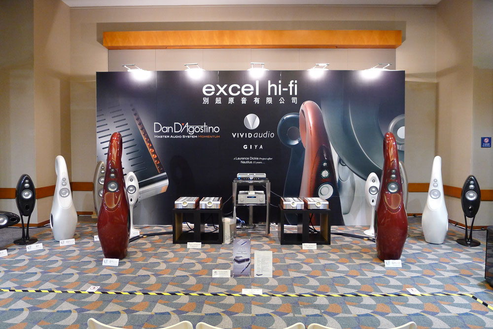

Those Vivid audio speakers are amazing. At RMAF it was one of the best sounds. They were driven with Luxman though.Interesting from Dan's site teaming up with South Africa speaker manufacturer Vivid Audio.

This could be one of the first metal diaphragm speakers, that sounds good. Unfortunately I haven't heard, but I'm excited to the perception sound character.Those Vivid audio speakers are amazing. At RMAF it was one of the best sounds. They were driven with Luxman though.

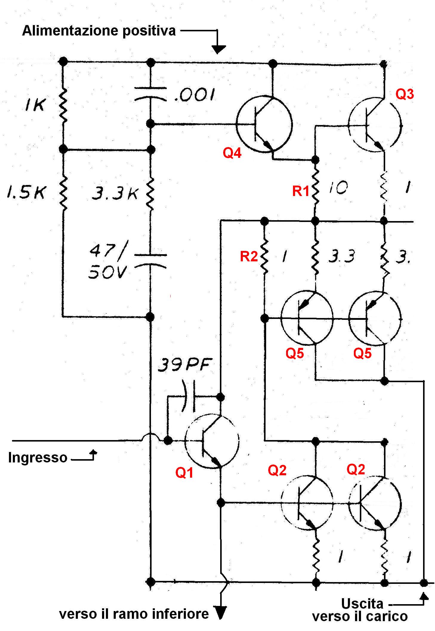

I spoke to Dan for about 15 minutes last Friday evening at the Melbourne show.
I can confirm that the LTP is zero transconductance and the VAS produces only 30dB of voltage gain. The output stage operates in class AB but the bias point is set to an operating temperature rather than an optimum v bias. I gather that the intrinsically low output impedance from so many devices reduces the gm*2 distortions into the noise without the need to set an optimum v bias point. The feedback loop exludes the final EF stage but apparently the driver stage is within the global feedback loop as well as the VAS miller loop. Of course Dan did not want to divulge all of the circuit highlights and there are a couple of patents pending related to the use of nested feedback and output stage biasing, so I was privileged to get as much info as I did. The output devices are matched for vbe and hfe to 0.1% and ditto all other paired devices. Apart from the output stage the rest of the amp is a fully complimentary design. A single mono amplifier draws 90 watts at idle which is less than past Krell’s but still considerable for a class AB design.

Such comments I want to read. This is the most interesting report regard this topic until now - thank you very much therefore. A similar feedback connection as mentioned above is realized in several "STASIS" devices from Threshold - have a look to the attached schematics and go to
http://www.diyaudio.com/forums/pass...overview-schematic-collection-all-models.html
