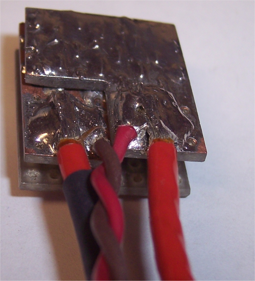

I've attached another pic of a CVR I made. Current is the two outer untwisted 12 gauge wires, v tap is the center twisted pair (to remove coupling to current in the wires. I also made a few where the current enters coaxially, braid to first surface, core enters through hole.
I've been considering how to do it with surface mount. Most of my thinking unfortunately results in a 3D structure, and requires a step soldering process using tin/silver eutectic first and then tin/lead eutectic for final assembly. Unfortunately, 215 C vapor phase reflow flourinert is waaaay too expensive for my personal use. edit: trying to do it 2-d ends up with significant board area with prop delays due to physical size. Not an issue at audio of course, but I tend towards "slight" overkill, like 5 or 6 orders of magnitude where possible...
John

Scott: I messed up the post during edit...meant to say.. It looks like your noise reduces significantly when the voltage slews. It's a bit difficult to see well as it would be a vertical 50mV superimposed on the high slew.

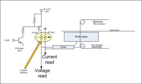

jneutron!
Thank you for the ideas, but in my project the whole loop inductance (voltage source + current controller + sense resistor + load) must be under 3...5 nH, not only transfer inductance is important, and this 3D arrangement is not easy to connect with really low input inductance, so I stay with the original plan (current flows in and out on 2 different, wide layers of a thin PCB in opposite directions) with some modification (many little resistors instead of 1 resistive plane). The output will be routed in a way flux should induce close to zero voltage in it. (Much less than 1 mm^2 loop area close to flowing current which is distributed to 10 paths.) I will flip SM resistors to make current flow closer to the ground plane and sensing tracks also. This way not only transfer inductance can be held well under 0.1 nH, but input inductance will also be less than 0.3 nH.
(+The complete structure will be mirrored to the other side of the GND plane also...)
Capacitance is perfectly negligible, since impedances are veeery low. I need only 2...5 MHz cutoff frequency in the control loop.
