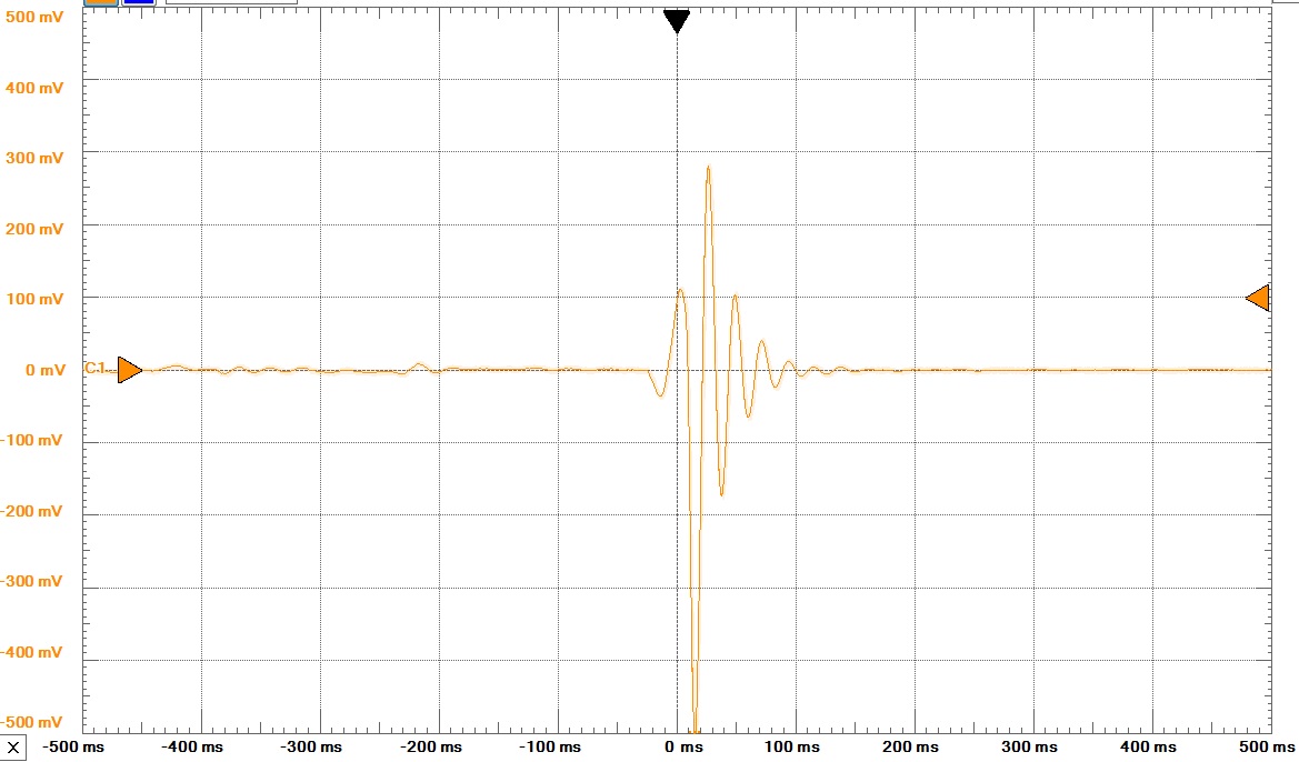

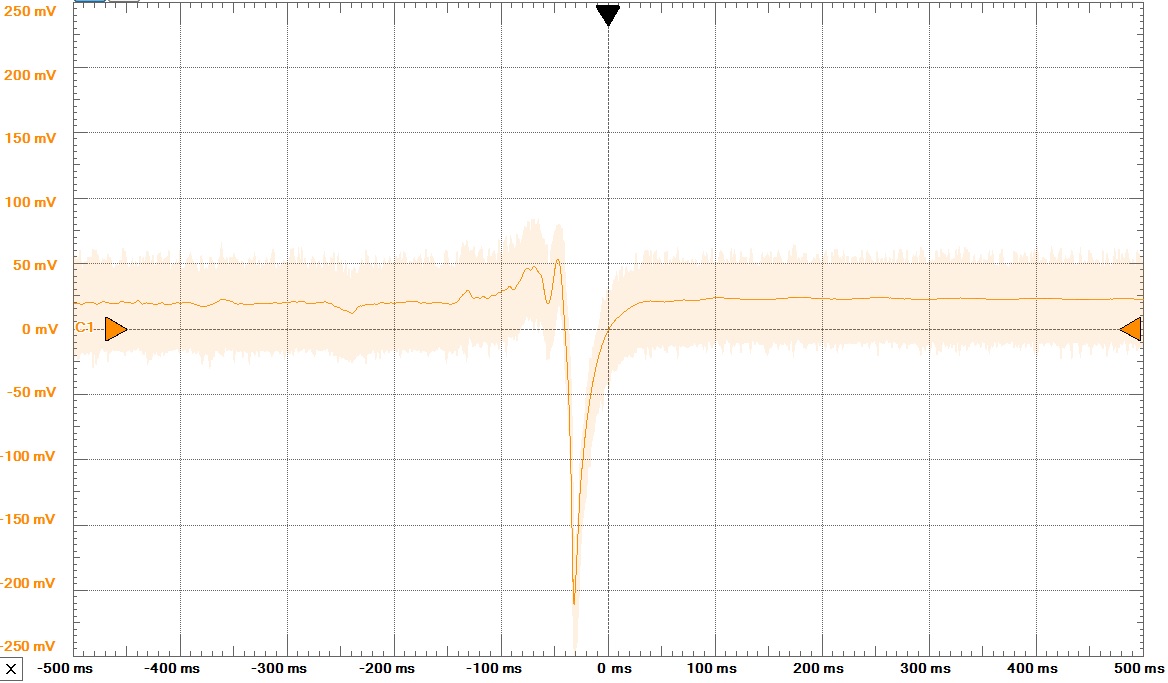

Demo of damping using jneutron's super duper current sense resistor.
I took a biga$$ 12" woofer and carefully placed the tip of my Wiha screwdriver on the center of the dust cap and pulled it off as fast as possible to create a roughly equal relaxation from a fixed displacement under two conditions.
First I sensed the current with a .1 Ohm (jn is that what you sent me?) and gain of 90 voltage amplifier. The .1 Ohm shorts the speaker. In the second it is just the open-loop voltage. The damping should be obvious. Sometimes a simple visual display of what is going on physically is useful.
So that is analogous (although not quite the same) as an amplifier with a DF of 80? If so ties up with the FOM many talk about that, once DF gets above 40 you can stop worrying about it. Or am I at the wrong end of the stick yet again?

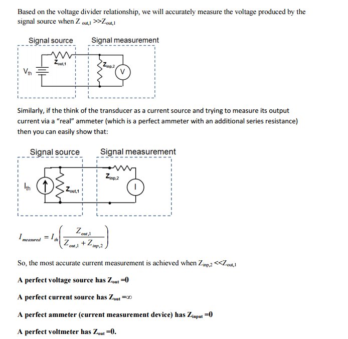

Damping Factor is thus the inverse of source impedance normalized by rated impedance.
IOW, DF = Zload/Zsource
The key factor is the amplifier source impedance, because it forms a voltage divider in combination with the impedance of the load.
http://hamers.chem.wisc.edu/sites/hamers.chem.wisc.edu/files/chem_628/Input%20and%20Output%20Impedances.pdf
(especially page 2)
If the source impedance and/or the load impedance have impedances that are not constant across the relevant frequency range, then the voltage divider becomes a kind of frequency dependent or equalization network.
The frequency response of this network, formed by the source impedance and impedance of the load, creates the audible and measurable effects that are sometimes attributed to damping factor. Since the mathematical relationship between damping factor, source impedance and load impedance is so simple, they can be thought of as being different sides of the same coin.
Getting back to the question, first off what is the load resistance in a damping factor spec - the nominal impedance of a speaker such as 8 ohms or 4 ohms, or the real impedance of the speaker at a particular frequency such as 24.6 ohms at 50 Hz? Obviously, only the latter is truly relevant and indicative of actual operation.
Let's say that the speaker's impedance is 40 times the source impedance of the amplifier (IOW DF = 40). Then our voltage divider has a loss of 40/41 or 0.97560 or -0.2144773 dB. This is pretty close to the best possible threshold of reliable detection of a level shift or frequency response difference. The ear is most sensitive to changes like this in the 1 KHz-5 KHz range, and only if it is very broad. Higher Q response variations at the frequency extremes are far harder (IOW impossible) to detect.
