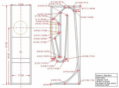

Just trying to tidy-up the loose end regarding the back-chamber volume for FE208Ez .
Best I can find at the moment is this low-res picture of the 'Rev.E' version which appears in a few places including DIY Audio.
Can Dave or Scott comment on whether this is one of Ron's drawings ?
I'm interested to see the volume modification is a bit more than I thought - looks like an extra piece of 3/4" in there behind the driver.

Dave - if you get time can you make your revised 2018 plans ....
http://www.frugal-horn.com/downloads/Dallas2-plans-redraw-120618.pdf
...Link from the 'Ron's horns' page :
Ron Clarke Horns
, as I think those should be the default now, rather than the 2015 redraw ?

Should be updated now… i can’t confirm yet, as the cable company has the page cached from when i 1st went and checked.
