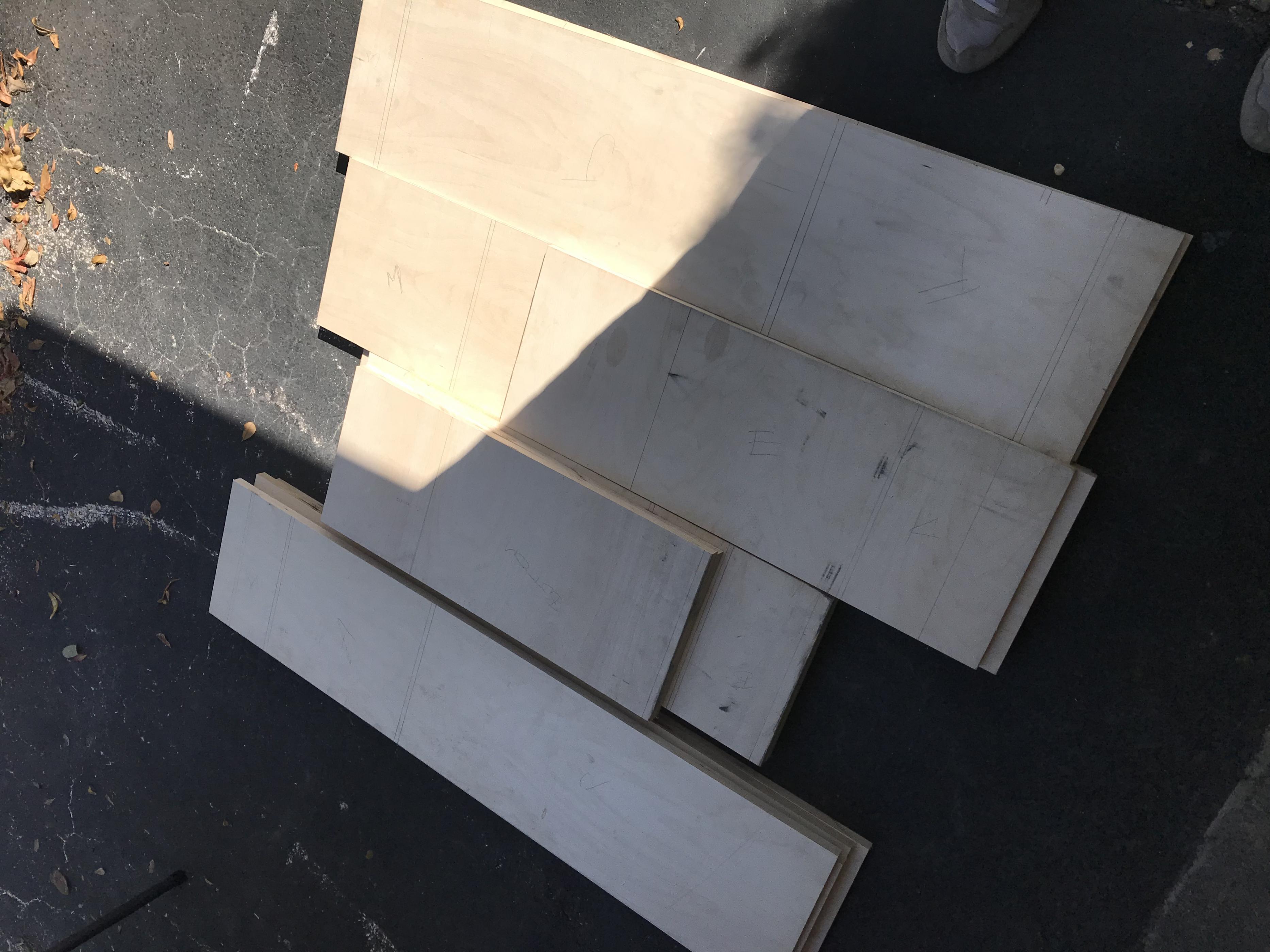

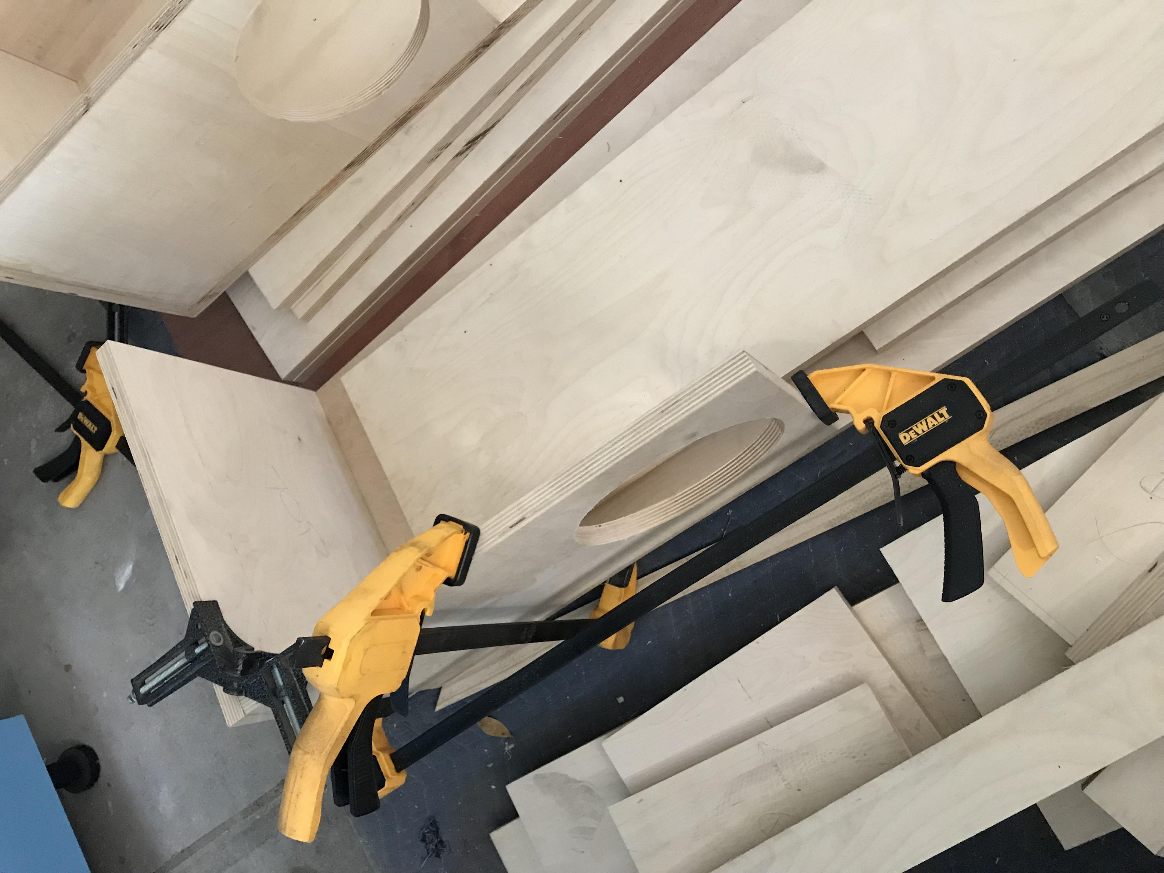

Ok. So I made all the angle cuts over the weekend. It was a 6 hour job with a sliding miter. For the most part I just did my best to round to the nearest angle. This was definitely not for the faint of heart and if you don’t have the right tools I’m sure it’s a pain. I had the right tools and it was still a pain.
Next is gluing. I’m sure the angles aren’t perfect so there will be some massaging involved to get everything looking right. I’m considering temporarily holding things in place with wood screws in lieu of trying to create odd angle clamps. Any tips or pointers are appreciated.
Pictures below. You can also see an old high school desk from the thirties I am stripping and putting back together.

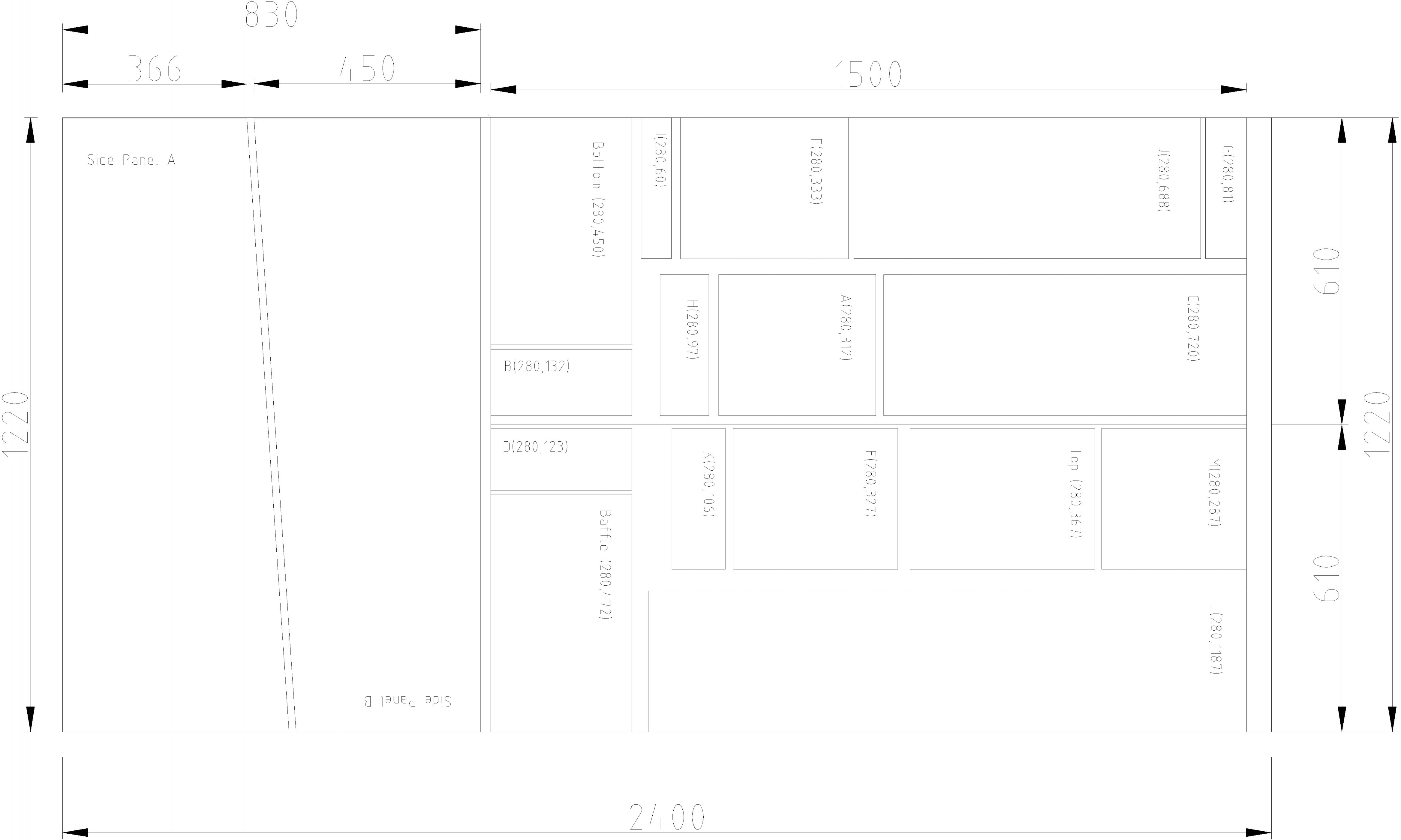

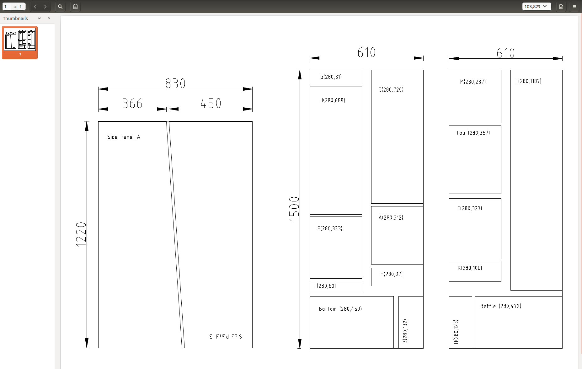

Hi Dave, if you are taking care of the plans, please feel free to include this cutting plan as well, if you think they'll be useful to someone. I have made it for my own needs more than one year ago (and yeah, I am using a different username now)... I hope they are error free.
I do have somewhere the original CAD file for this, if you would like a different rendering for paging purposes just let me know...

Hi Dave, regarding your question, I have finally decided to buy them precut (not much extra cost, as they could use leftovers for the small parts), but yeah, I tried fitting them on a standard piece they had in the local shop.
I have double-triple checked everything, but there could still be mistakes in there, please let me know if you find any.

I have arranged the cutting plans on a 2400x1220 board, if it helps. By removing the common cut edges (in order to increase cut precision) it became a bit busy, but still possible to read. Dave, thank you for clearing the username issue.

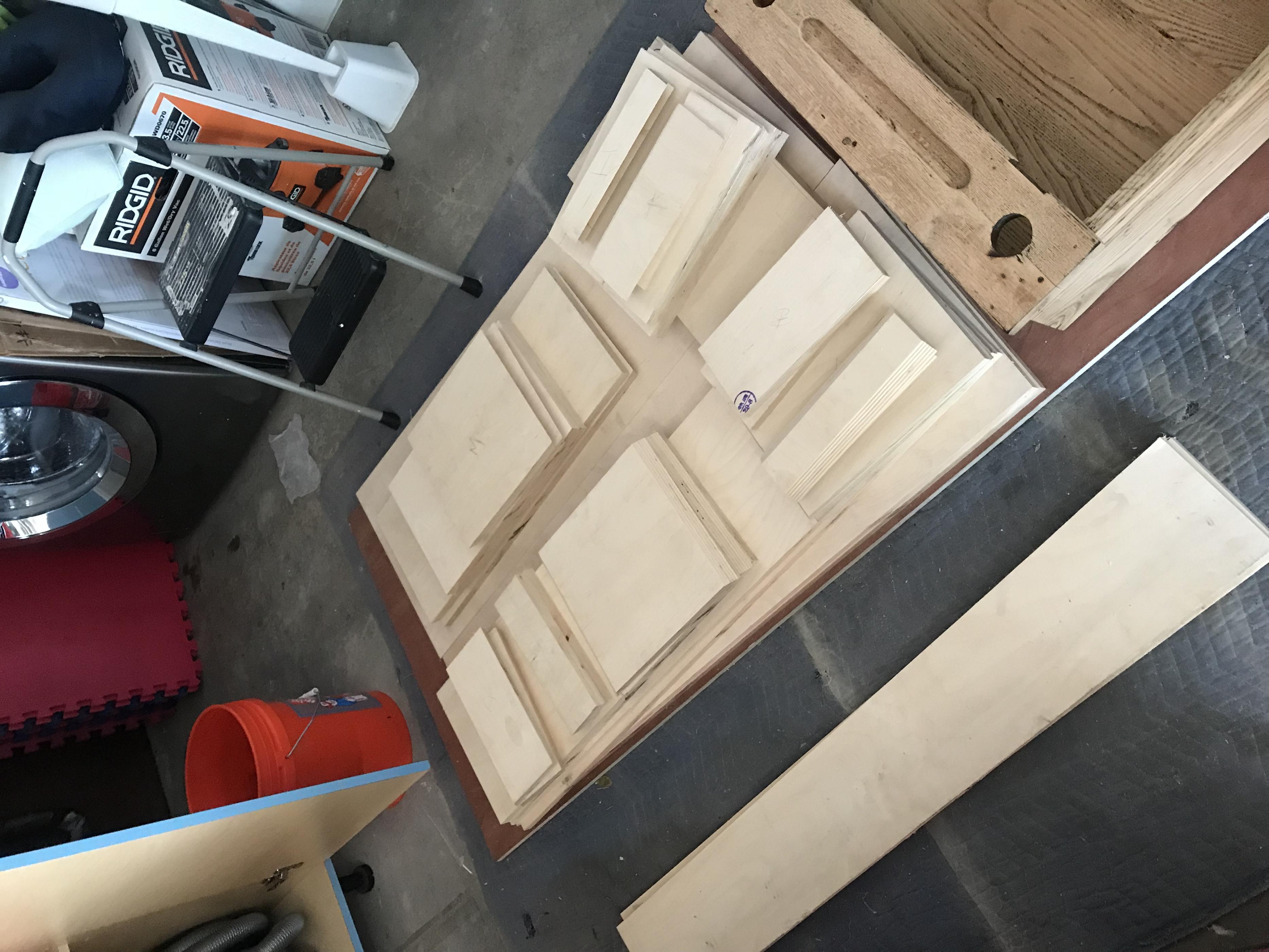

The cutting plans worked fine for the 5x5 Baltic birch panels. I used three total panels cut into pairs. One was cut in half and two were cut at a closer to 60/40 split to accommodate the sides. The cutting pattern was efficient and I had enough left over for some minor screwups. The way I did it was to clamp the matching panel halves together and do the rip cuts once with the track saw through both panel sets. So both sets of speaker pieces came from a single set of cuts. Hope that makes sense. Then I trued up all the interior widths with the table saw and did the bevel cuts with a sliding miter.

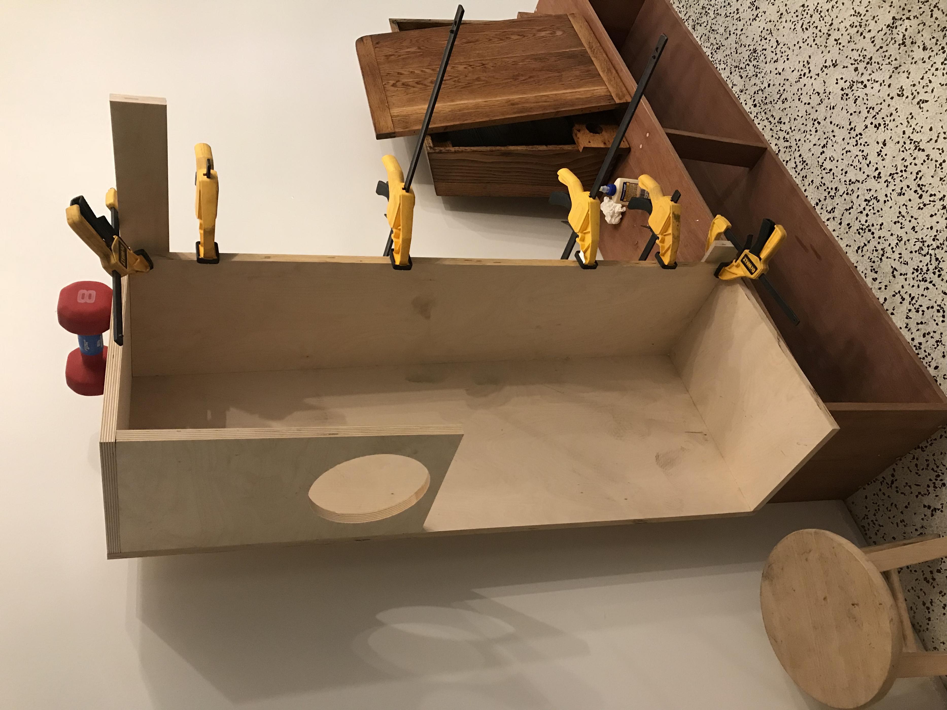

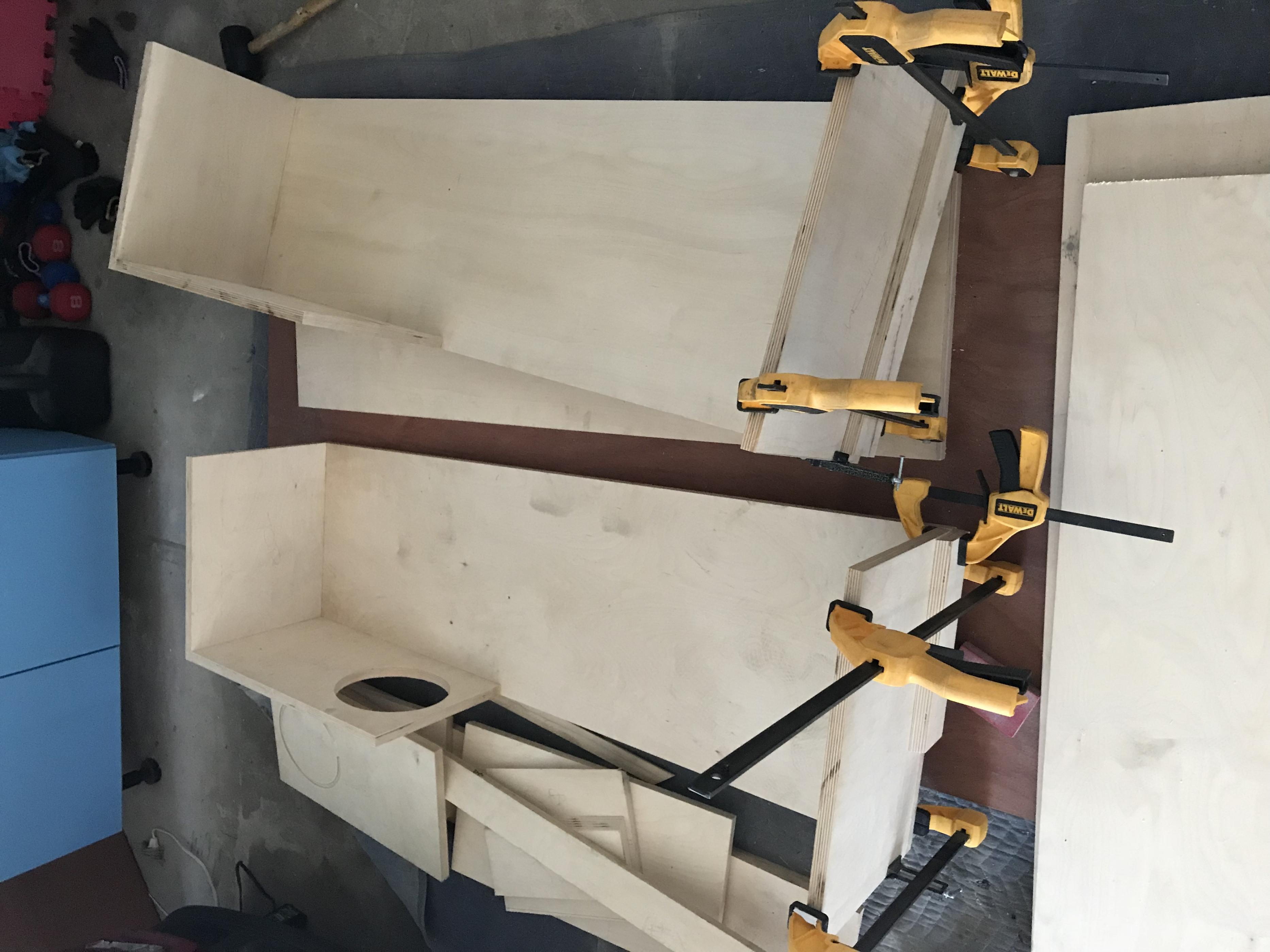

Today I started gluing things up starting with the outer walls. I figure I can use those as support and start building inwards from that. I test fit everything before gluing and had to use the miter to take off an extra 16th here or there. For most of my cuts I try to err on the side of too big so I have room to adjust if needed.
The plans are missing a 4 degree angle cut on the back panel to fit properly but it was easy enough to correct. A few questions.
- to run the speaker wire - do I just cut small holes from the speaker chamber through the panels to the back? Do I need some kind of sound dampening-filler in the speaker wire holes as they go through the panels?
- what is the best material to use to fill the voids in the speaker?
- do I have to put felt in the bottom opening? Where? Just floor? Or sides and top as well?
That is complentary to th eone on the bottom which i shown. I might add a detail sheet like in di in the trapezoidal miniOnkens thou.

I believe Ron suggested just some rolled up poly batting in the air cavity. I’d line it and then add poly to taste.

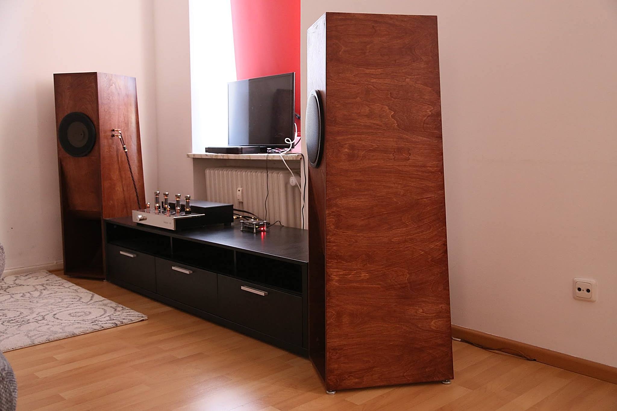

I am using my dallas II set without any damping material whatsoever, so far. I think at lower volumes the mids shout (due through reflection towards the frontfrom the sound cavity, though the driver) is not at all disturbing. So maybe you can wait until it is all nicely broken in (200 hours or so), and then try to play with some felt behind the driver, to adjust to your taste. The space left is quite limited, so you need to pay attention to the felt thickness when choosing it.
I am pretty sure the rest of the horn does not need any additional damping.
Regarding the speaker cable, as an alternative solution I have chosen to route them directly to the side walls, and avoid drilling holes and the need to plug them afterwards.
As advantage, you can use a very short cable (15 cm) to the plug, and the cable is replaceable.
As disadvantage, you will see the plugs on the side, so you have to like it, once it's done. Next, I would not install the plugs vertically, but horizontally, it is better for strain relief.
