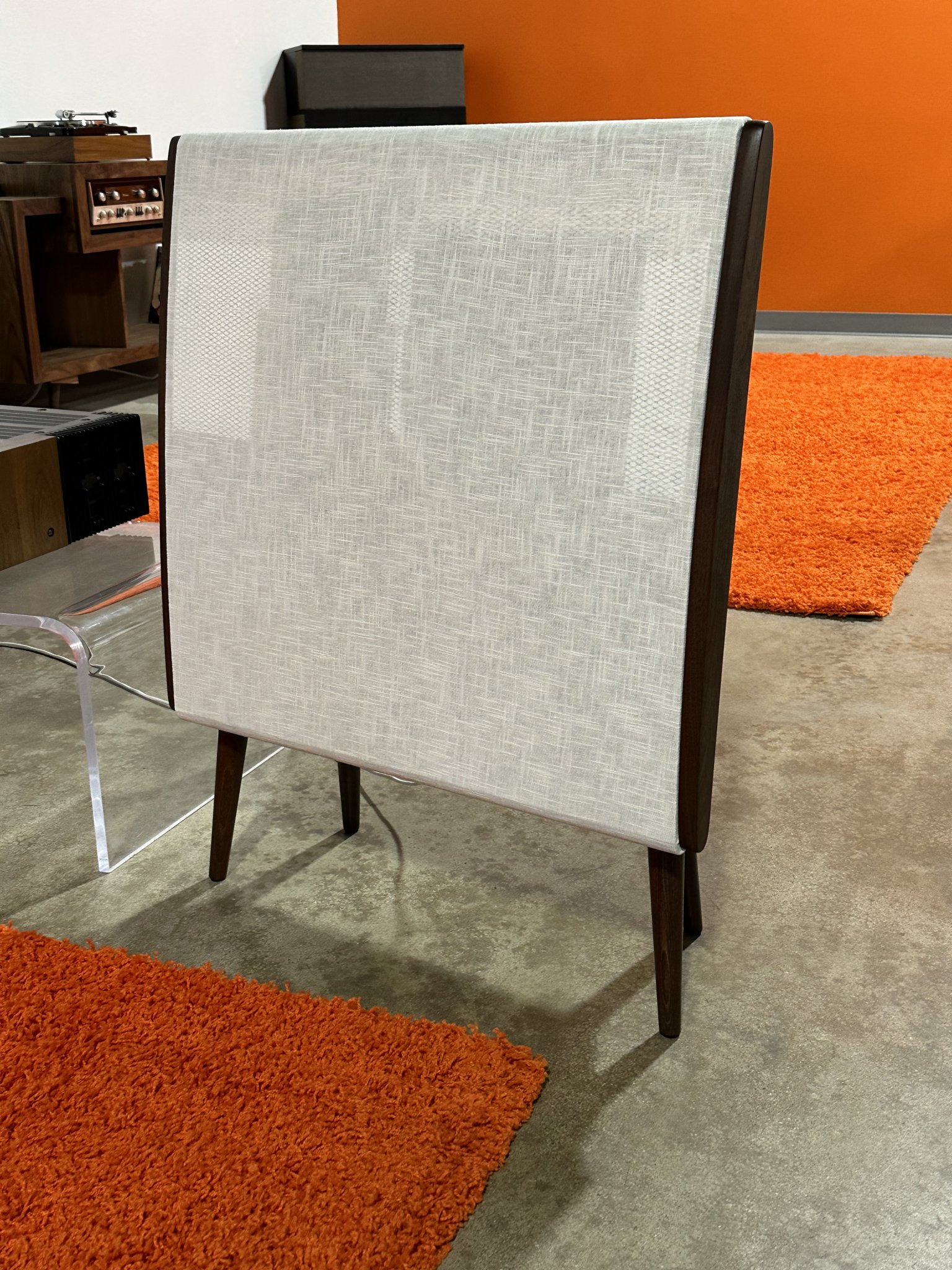

Here is it with classic black grilles and many photos from one
ebay auction

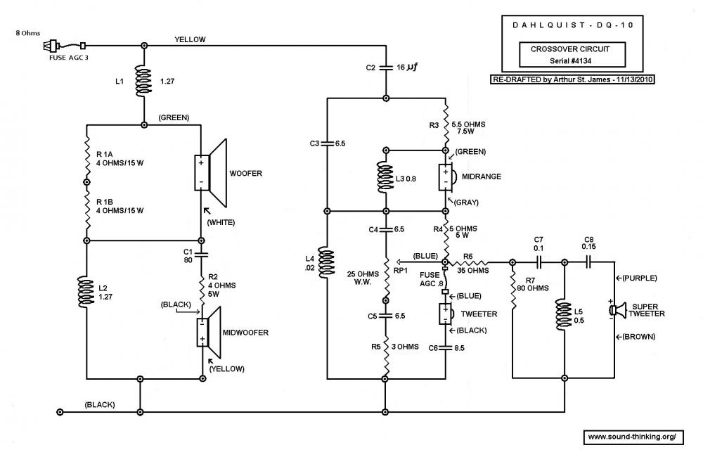

In the DQ10 if i am not wrong is cut at about 1kHz ?
So, that's not the same driver. The DQ-10 uses the Philips AD5060/W8, the woofer version. That appears to be the AD5060/M8 or it's counterpart with a backer chamber. None of them are the same driver. Philips had an odd model numbering system at the time where different drivers with different applications, but the same basic size format would share the initial set of numbers and what came after the "/" dictated the function; "W" for woofer, "M" for midrange, "SQ" for squawker, which was the version meant to be used higher up to 10kHz.
Those were the stacking stands that Dahlquist sold for a brief period in 1977 when stacking was all the rage. They were well-received when demoed at the 1977 Summer CES, but seemed to have disappeared after. They're quite rare. I've only seen a few pairs come up.I have this picture saved for some reason.

The tweeter in the DQ-10 was the Mikrofonbau (bought by Peerless after the Dahlquist entered production) HTL-1913 3/4" (19mm) poly dome. No 1" tweeter. The midrange was the Mikrofonbau MTL-37, a 1.5" (37mm) (not 2.5") textile dome and little brother to the MTL-44 that was modified and OEMed to Infinity for use in their Quantum series a few years later.The speaker was designed circa 1969-1970. Back then they did have available .75" tweeters which could give you good dispersion up above the 14440 Hz max you get from a 1" but the power handling wasn't there. So Jon Dahlquist (JD) decided on a piezo for the top end up to 27k I believe, and i 1" dome under that. At that time there were no commercially available ribbon tweeters AFAIK.

As I said before the dq10 were my first experience of 3d Soundstage
I was struck from the feeling of a sound coming from the space around and particularly behind the speakers
Call it love at first listening
From this my effort to understand what makes these speakers so special
And i have concluded that it is the xover design
To cut short i would like to simplify down to a 3 way increasing the range covered by the Philips
If the magic is in the xover the drivers that are good but nothing stellar could be even replaced with better one
Sad thing is that i can't understand how this xover works For me it's a mistery
I would like to see a simulation of it
I am pretty sure that phase response and impulse response should be very very good
Imho it's the xover that provides a sort of coherency similar to a single wide band driver
A masterpiece
