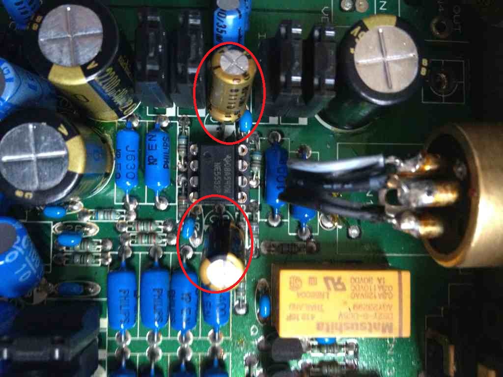

Took some images this morning in better light.
Could someone have a look and see if they can see where i can take a ground from

You could put them right across the yellow electrolytic capacitors right next to the OpAmp. Those for sure have one pin to ground and another on power rails.
But I see, in the last pic, that looks like you already have two ceramics there - is the little blue ones next to the electrolytics, exactly like the ones recomended by me...

I can tell you 100% that those capacitors are on the OpAmp supply already.
Yeah i see them now you point them out. Still got a LOT to learn

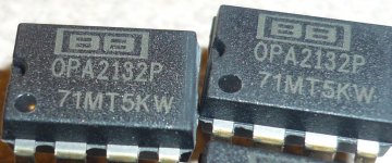

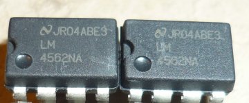

Where did you buy them? Do they look like below? Those are samples straight from National Semiconductors (before they where aquired by TI).
I am showing my OPA2132 that I did compare to.
