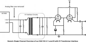

Here's the minus leg of the I/V converter that TI suggests. I don't see where the Iout- pin can find ground in this circuit, unless it's through one of the opamps.

Thanks for your interest. I've been trying to reconcile two apparently conflicting bits of information; one that said that current output DAC's prefer to see zero (or near zero) ohms to ground on their Iout pins and another that showed a transformer primary connected across the + and - Iout pins with no connection to ground. There are several commercial implementations of both but I think I've resolved it now.
