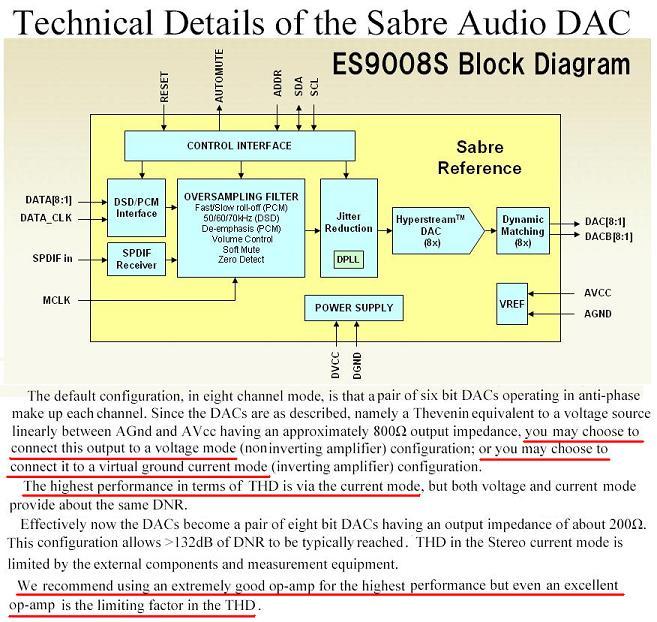

The value of 180 ohms, has an internal impedance of the Buffalo is given, in many places, even in ESS short sheet, the chip ESS9008 is in fact 8 dacs coupled 4 by 4, (4 L & 4 R) each "small-dac" having ~800 Ohms internal impedance .
Have a look on Buffalo posts, page 48 to 50, some idea to run Buffalo in "current mode" with transfos...

Picture about internal impedance

Just because its voltage AND current, you don´t need to worry about DCR being to low. At 20Hz your transformer will have a reactance of at least 10kohm, probably a lot higher, with unloaded secondaries.
I have since long got hold of the hard to find datasheet of the 9008. The 9018 should have the same output section. Can mail it if you want, will just have to locate it....

With the unnecessary series resistors that are there to protect a std voltage DAC from frying and make it possible to filter the zero Zout you also depend on the secondary loading. As you said in a previous post secondary loading could kill sound.
I know it can do current or voltage mode output - is this why you are saying it doesn't matter? But there must be an optimal or target load for it - in current mode it's 0ohm, I think?
I only think of 9018 as a voltage DAC but as it can take zero ohm you don´t need the 100ohms. As I said one should try between 2k(maybe start a little higher at your proposed 2*160ohm*10) and 10kohm. Only your ears can tell. Of course a frequency plot can show if there is any peaking that should be damped.

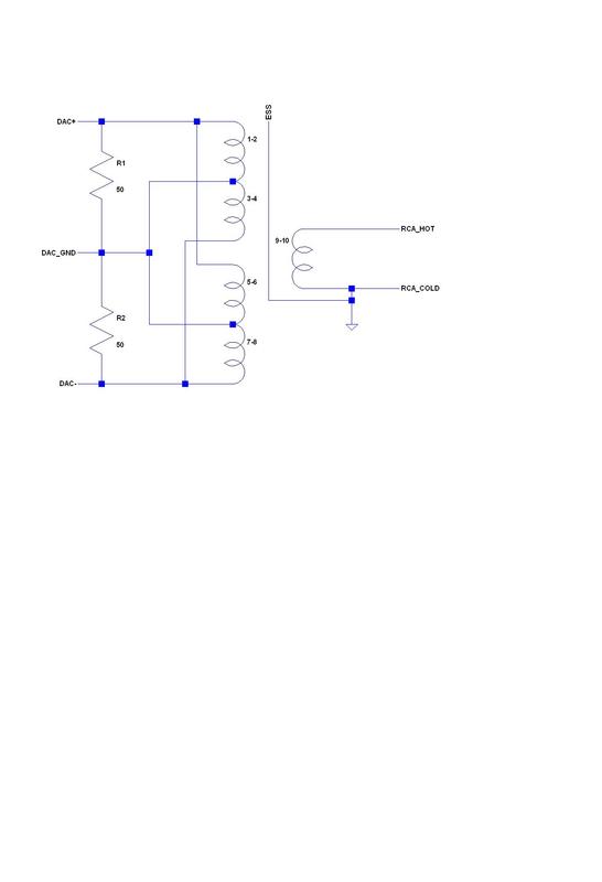

you should use the transformer S & B TX-103 1:10, connected to the current way.
attach file with connection
What do you think of this solution? it is better to insert 1kohm resistor in parallel to the secondary?
Administrator
Joined 2004
I have built prototypes of the an ESS DAC with transformer outputs. Works great.
Sorry I can't post schematics because it's a commercial product, but it isn't hard to figure out.
Not sure why you would want to force it into current mode.
