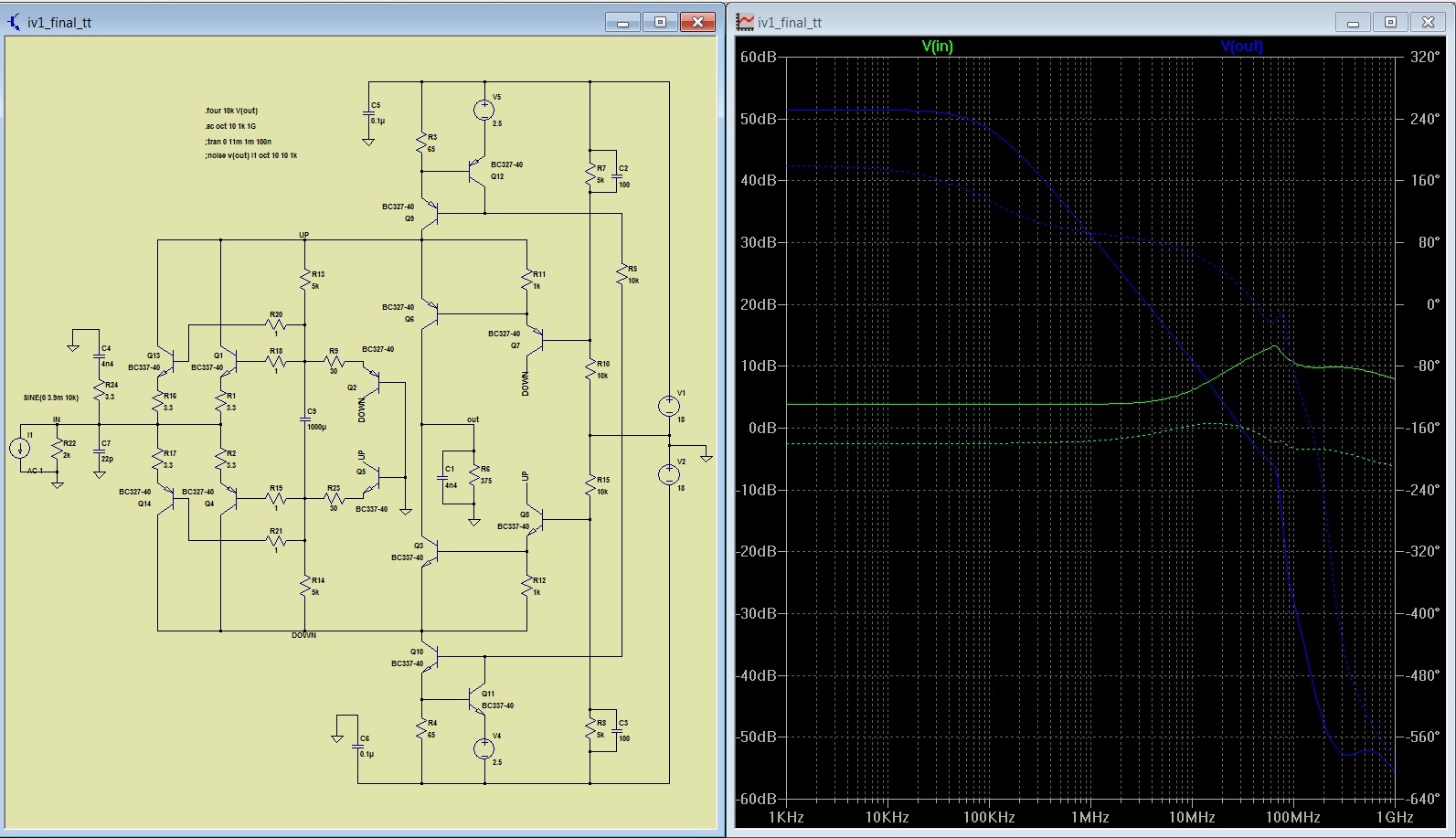

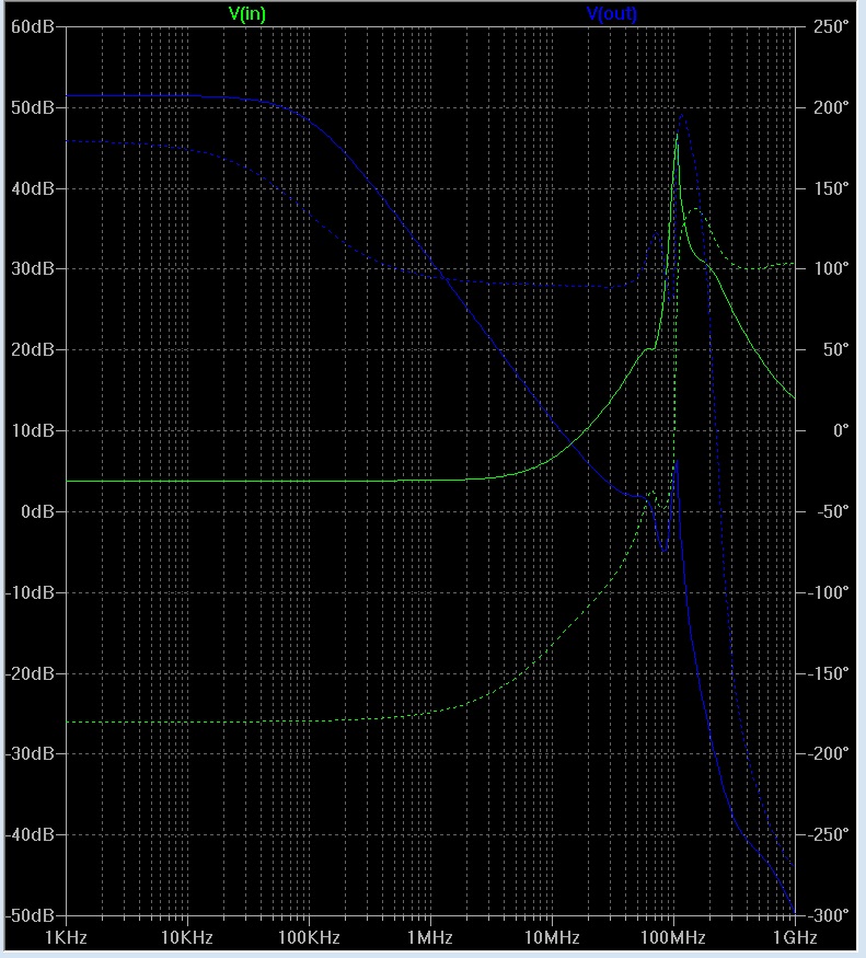

THD seems really low, but input impedance rises above 1MHz with some weird up-and downs, especially around 66MHz, where seemingly a resonance builds up.
I have been analysing this, and the conclusions is
the rising of the impedance is due to the lost of gain of the input transistors as the frequency goes up.
The dips and ups around 66Mhz are due to the interaction of the dac output capacitance (22pf) with the input.
The best soluction is to use a snubber (zobel) in the input.
In the pictures below is the output and input gain and phase with the snubber and without it.
Its very important to use the snubber in the circuit.

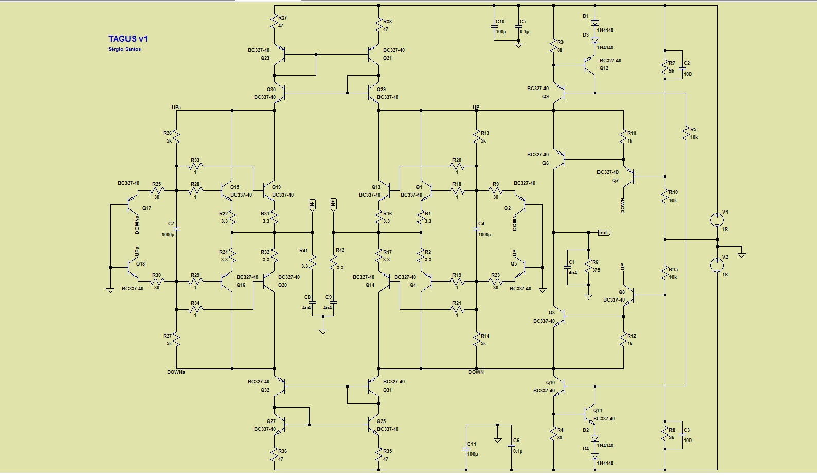

Is time to present to you guys, the almost finished differential version that i resolve to call TAGUS.
It has a new current mirror that is also a voltage mirror.
The distortion is measure with a 500ohm/22pf input
and is 0.000130% at 7.8ma p-p at each input.
and only 0.000055% at 3.9ma p-p.
Below are the schema and the fft for 7.8ma and 3.9ma
I will talk about it later because today going to be a busy day, hope you enjoy.

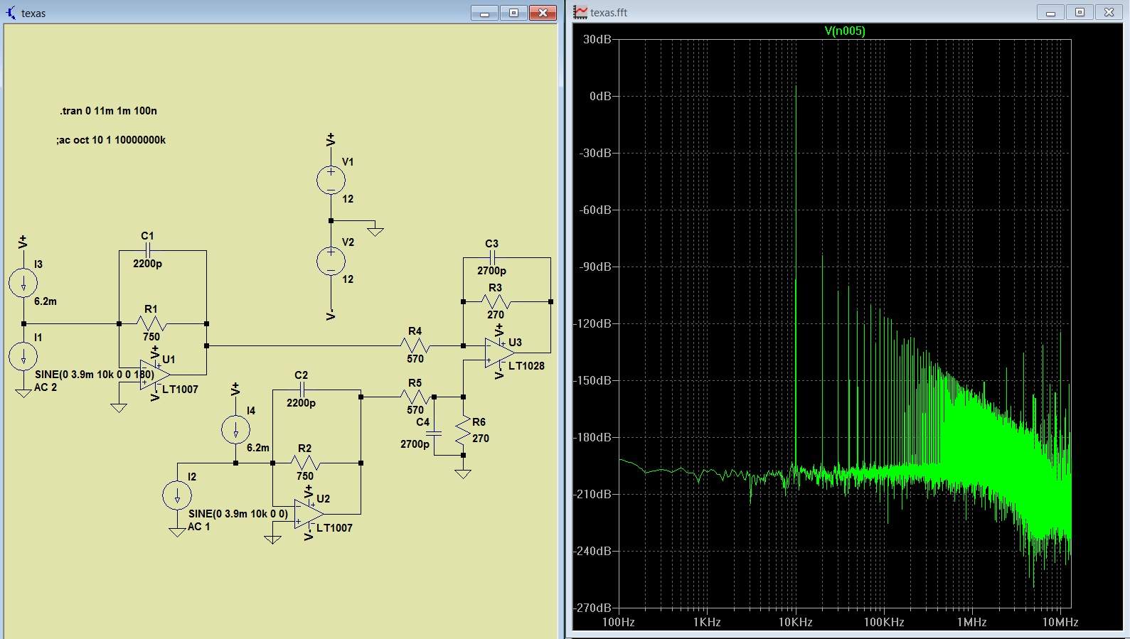

Here are the I/V of the texas datasheet and the FFT just for comparing.:rolleyes:
have you ever seen one like this?
Good circuit :)
I have built quite a few circuits based on these principles using mirrors to
sum the +and- phases then that current modulating cascoded OP stage.
DAC's , front ends of open loop SS power amplifiers and even a mic pre that
have a bal IP and SE OP (fully complimentary).
I have also implemented the same type of OP stage with those cross
coupled darlingtons. They do work very well to linearise non linear base currents and capacitances.
It's really a design twist of the 'Baxandall pair' connected BJT's, using the
'error' current from the bases of the main OP BJT's as + feedback. Your sim
numbers tell the story.
It all works just like it should in real life too with one gotcha - stability.
You may or may not have stability issues. It depends on layout etc. C1 will
certainly help but you may need additional base stoppers in either the main
OP BJT's or the 'helpers'.
Once you get the whole thing on a board and prototyped, it really is worth
having a good listen with and without all the Baxandall collector connections
to up/down labelled points. With these connected, the distortion will
certainly measure a lot better, however it may not actually sound better.
IME, with all these small + feedback loops, the sound can be worse. Without
them it is often more natural, but you won't get the super low dist numbers.
I'll be interested if you have similar results with this design. Keep us posted.
BTW, your choice of 327 / 337 in most locations is a pretty good one for 2
reasons - who can guess what they are?

the current mirror reminds of an ´full Wilson´. See for example sboa046 "IMPLEMENTATION AND APPLICATIONS OF CURRENT SOURCES AND CURRENT RECEIVERS" of TI/BB.
A ´complementary full Wilson´ is the Zetex part ZDS1009 in SM-8 casing, which might be a possible replacement part for the discrete BC327/337, because of the matching issues/oscillation issues of these cascoded current mirrors.
Well You can of course imbalance the whole stage by increasing the lower ccs bias current, but what´s the deal in designing a symmetrical stage just to spoil its symmetry right away to accommodate for the DAC? Yes, a dedicated CCS would mean more complexity and a slight noise penalty. But a simple JFET ccs is the simplest and the least noisy ccs You can have here, just two parts, a JFET and an R. Noise figures will be slightly higher (1-2dB), but still be well below -110dBV.
In the case of a current sourcing DAC with an offset current a SE-circuit, basically using just the upper half and a ccs towards the negative supply, would be more elegant and less complex.
I agree with Terry, that the multiple loops and cascoded mirrors may give stability problems and may sonically not be as overwhelming as the distortion figures imply (which have yet to be proofed in reality).
In my tests a simple SE-grounded base stage (rem. "Jocko" or SEN) certainly sounded better than a similar, but more complex and lower THD Hawksford current steering I/V stage.
As Zinsula correctly remarked in #159, THD improves with rising Ibias/Idac relationship. But there´s a sweet-point of optimum bias depending on the chosen transistors. The PCM1795/1796 or 1798 DACs have lower currents (-3.5mA+-2mA) than the 1792/1794A and allow for lower power requirements. Sourcing of matched transistors may be easier if SMD casings can be used, due to lower currents and power requirements. You just need to increase the value of the Riv for same level output.
The probabely best match to the PCMs is the TI/BB SRC4392 asynchronous sample rate converter and DIX.
You may linearize input impedance with the Zobel, but You put a burden on the DAC that needs to charge/discharge the Cap. It slows and rounds the current steps of the DAC (lower bandwidth) and is often used with OPamp-IVs featuring ´too slow´ OPamps. I typically found that such caps were no improvement sonically, but quite the opposite.
